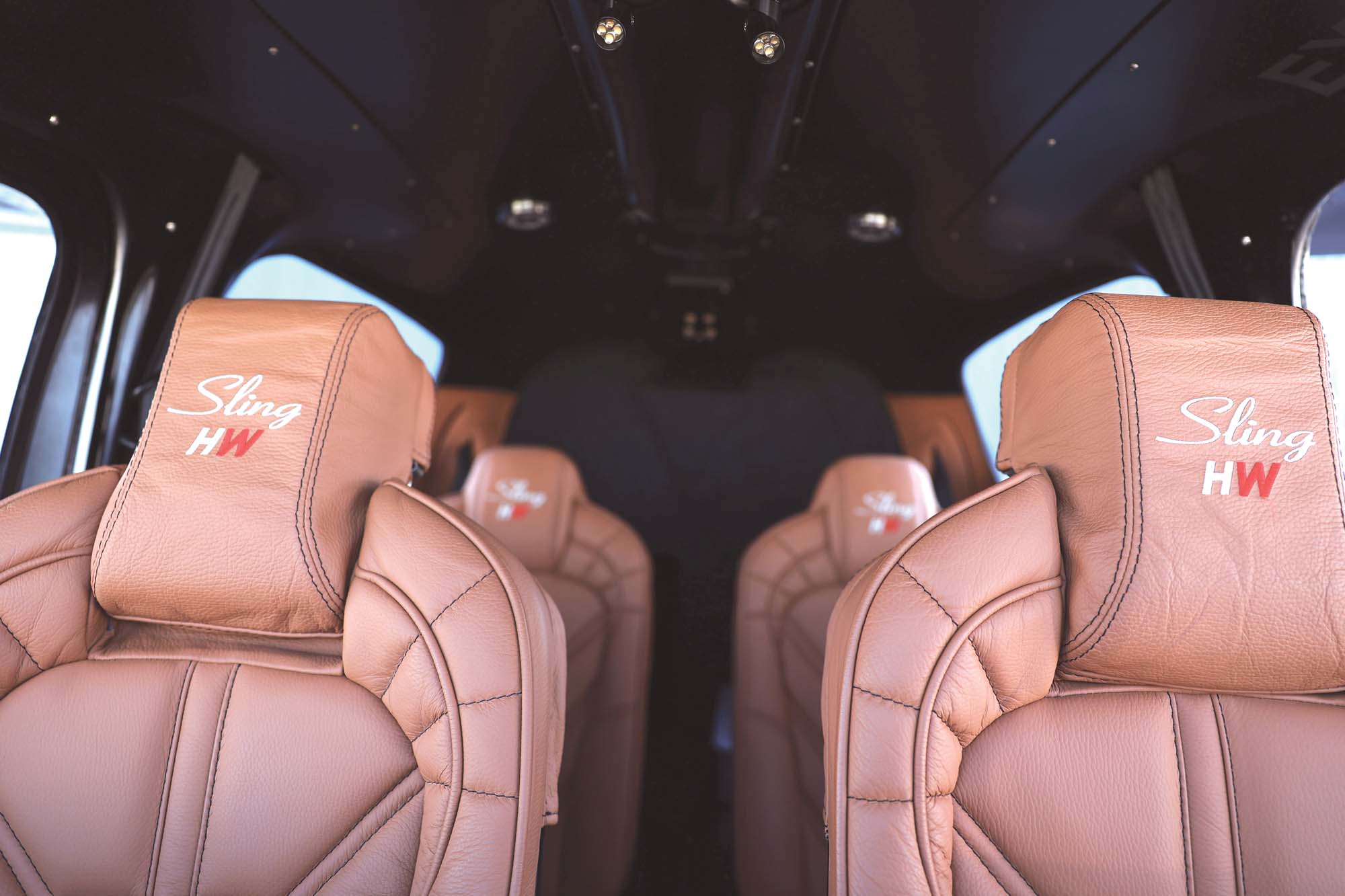

You can build the High Wing (or any of the Sling aircraft) with a simple interior, of course, but Sling integrates everything so nicely that frankly it would be a shame to build it that way unless you were trying to produce an “ultimately light” ship for some specific mission. It can be a little hard to wrap our heads around just how finished these modern kits can be, but that is the way of the world now and I can’t say I don’t enjoy flying something so nicely finished.
