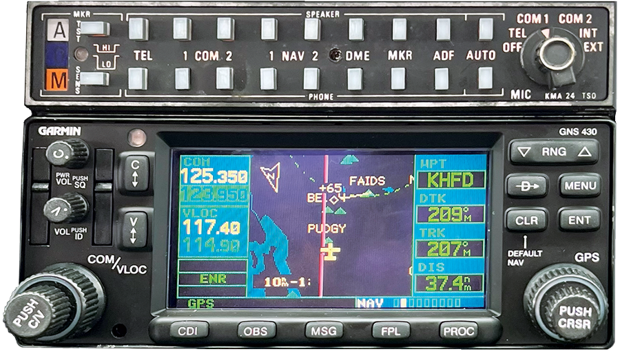

audio panels review 01Tens of thousands of Garmin GNS 430 and 530 navigators were paired with Garmin’s GMA 340 audio panel—a generally good, reliable audio system with built-in intercom and wired entertainment input. But late last year, Garmin announced (via Service Advisory 21115, Rev. C) that popular flavors of the GMA 340 have reached the end of their service life. While it’s been a long run, that means a lot of owners could be looking for replacement panels when their GMA 340 needs major service.Avionics bootcamp
The good news is there are a couple of worthy slide-in replacement units (in many cases, no new wiring is required) from Garmin and PS Engineering that bring more modern tech and more features than the aging GMA 340. In this short report, we’ll take a look at the options. These new panels bring so many advanced standard functions that we can’t cover their entire feature sets in one article, so we’ll touch on major features to help with your buying decision.

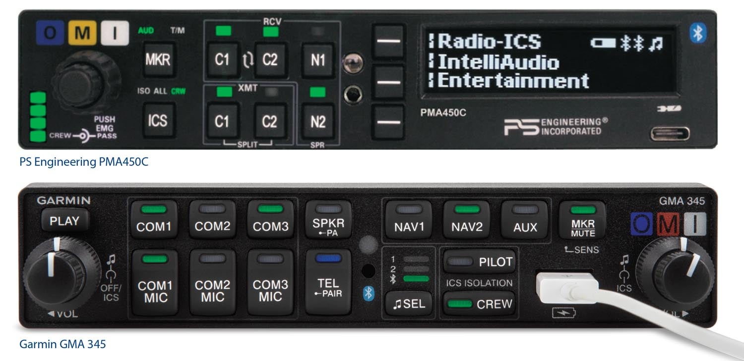

Garmin GMA 345
This isn’t exactly a new panel, introduced around five years ago, but it has plenty of modern features including Bluetooth and Garmin’s 3D Audio. More on that in a minute. Based on the GMA 340 chassis, the $2245 GMA 345 has a six-place intercom (although most Experimental kits don’t have that many seats), but if your GMA 340 is wired for fewer ICS stations, the 345 will play in the interface just as the old unit did.
I’ve always liked the GMA 340’s rugged buttons and control knobs, and the GMA 345 continues the tradition. Plus, it has good bezel and key lighting. Like the 340, when a key is selected, a green annunciator shows that the function is active, and you can control the brightness with the aircraft’s dimmer system.

PS Engineering
The company has been offering slide-and-fly options for Garmin’s GMA 340 for years, and the latest is the $2595 PMA450C. A version without marker beacons is available for $100 less.  The PMA450C (with a six-place intercom with three isolation modes) is actually the third generation of the 450 series, and PS Engineering has been offering it as a lower-cost alternative to the flagship PMA450B, with a couple of scaled-back features that some users wouldn’t use anyway. This helps PS Engineering conserve in-demand microchips and also control costs. But the PMA450C and 450B are certainly cut from the same cloth.
PMA450C bench mockup
We give the PMA450C the edge for its well-designed function display and shallow menu structure.
Forget everything you know about Garmin’s alternate key feature set when using the PMA450. It uses an OLED graphical bezel display with a three-softkey user interface—something I think can benefit the Garmin unit. Because of this intuitive function display, PS Engineering says most users should be able to operate the panel without flipping through the user’s manual. I think the shallow menu structure does a good job of leading the user through primary functions and advanced custom configurations on the fly. And if Bluetooth music and tablet app audio alerts are  high on your list of must-haves, the PMA450 series excels. For starters, it has dual Bluetooth modules, which means you can simultaneously connect the panel to an iPhone and an iPad. There’s a lot of utility there because maybe the iPad is running your favorite cockpit app (and streaming audio output alerts) and the iPhone is streaming your tunes.
