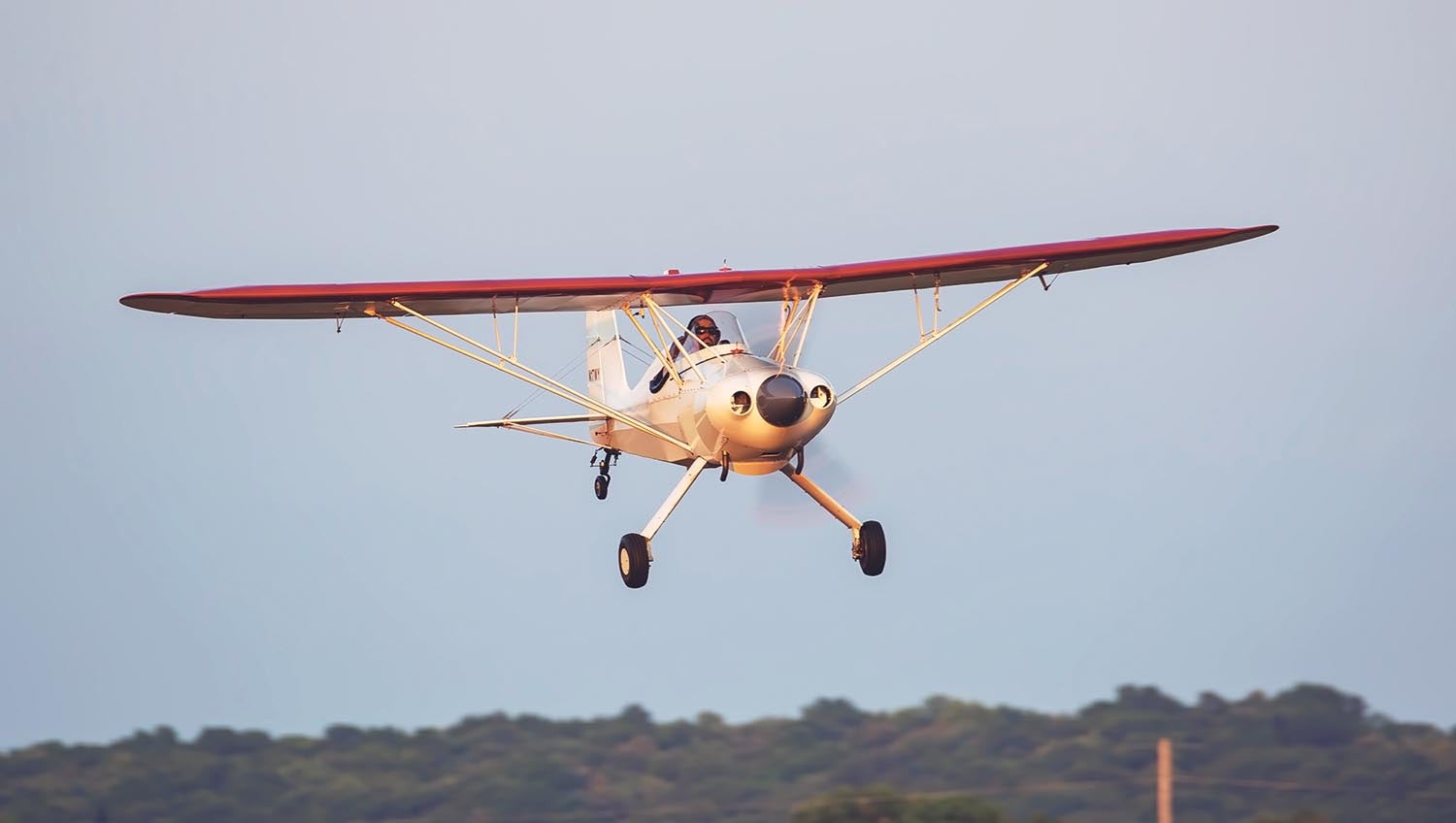

The Starlet features a deep roomy cockpit and a strut-braced elliptical parasol wing, which has a rakish swept-back planform. The fuselage is welded 4130 steel with spruce spars and plywood ribs, all covered with fabric of course. The wing is a Clark YH airfoil design (the H stands for high lift). Originally designed to be powered by a Volkswagen engine, various powerplants have been fitted, ranging from 65 to 125 hp. This specific model is powered by a 100-hp Corvair conversion. The cockpit is 20 inches wide with plenty of room for a larger pilot. The tubing at the rear of the cockpit was curved to fit a back cushion or parachute. The cantilevered landing gear is steel tubing with coiled springs for compression. The gear legs are faired with spats reminiscent of a Focke-Wulf Fw 56 Stösser or Westland Lysander.
The plane that sparked our interest is owned by Justin Peters of central Ohio. When he was learning to fly in a Champ in 2017 (which makes the authors’ taildragger-loving hearts incredibly happy), his CFI bought this particular Starlet from a neighboring airport. The aircraft was started by the original builder from plans in the 1970s. He completed the fuselage and some of the other pieces before the project came to a standstill. Fast-forward to the late 1980s, and the project was picked up by a gentleman named William “Bill” Young. Over the next 10-plus years the plane grew wings and was finally completed. It was only flown a few hours, and Bill moved on to other projects. It sat for about 17 years before moving on to a new owner. The new owner removed its original Continental engine to sell it, and again the airframe sat. As conversations around the airport go, one crazy idea led to another, which again led to another, and Justin eventually was given the Starlet as long as he could sort out a new engine to put on it. Justin remembers the discussion as “slap an engine on it and go fly!” If only things were that easy, right? Seems like an easy day’s work!
Corvair Power
Given that the Starlet is an Experimental, there certainly were a number of options for powering it. After considering several of them, a close friend at the same airport, Shad Bell, suggested considering a Corvair conversion. Shad has a Pietenpol powered by one, so he is quite familiar with them. The choice was made, the wings came off and Justin trailered it to his house to begin work on it. Fortunately, it fit into his walk-out basement pretty easily. He found an appropriate engine core and started talking with the acknowledged Corvair engine expert William Wynne, who agreed it would be a good fit. Next was a trip to a Corvair College in 2018 that eventually led to trailering the fuselage down to William’s shop in Florida. This allowed them to work with the actual airframe, calculate the weight and balance, set the thrust line and design and weld up an engine mount, as well as build a cowl. If you notice, the cowl has round air inlets and was specifically designed for a Corvair engine application, just not for the Starlet! It wound up being a very good fit after some modification.
Back in Ohio, everything came together. There is a wonderful pilot report written by the legendary Art Scholl in 1970, and Justin read it at least 30 times getting ready for his first flight. As almost all of his flight experience had been in Champs, his more experienced friends stepped in to help. The planned first flight didn’t go well: After several taxi tests, the designated pilot tried to take off, only to have it swerve violently side to side and almost go off the runway. This certainly was frightening, and no one wanted to see it get wrapped up into a ball.
Everything was put on hold while trying to sort out the issues. The next day, everyone taxied the airplane but couldn’t replicate the problem. Shad taxied it back and forth without issues, applied the power and took it up. Success! Turns out the first pilot had rather large feet and while applying rudder pressure was inadvertently jabbing the toe brakes.
After the initial wringing out, it was Justin’s turn to fly his baby. With his experience being primarily in slower Champs, he took an understandably cautious approach. After getting comfortable with it and used to the faster speeds, he had a wonderful time getting to know it. In comparing it to a Champ, he says, “It’s like a station wagon compared to a dirt bike. It is very responsive—light and quick to respond.” On the ground, while his Champ had a tendency to track straight and easily, the Starlet is sensitive; he keeps his feet on the pedals until it drops below walking speeds.
It is a speedy little thing, and he comes over the fence at about 80 mph. Cruise speed is about 120 mph, while stall speed is between 45 and 50 mph. It is fairly tolerant of winds, and on a cross-country flight last summer he landed with a crosswind in the 20-knot range without any issues. The stall itself is rather abrupt, however, and certainly should be respected.
Being light, and with a 100-hp Corvair engine, it gets off the ground in less than 500 feet and lands similarly short. The Corvair burns between 6 and 7 gallons per hour, and with 11 gallons in the wing tank and 7 in the fuselage tank, it can comfortably go for hour-and-a-half legs, two hours if one plans carefully. The Corvair was paired with a Warp Drive propeller originally, but for aesthetic reasons it was eventually switched out to a Sensenich prop that performs equally as well. At full throttle the engine turns at 3300 rpm, while at cruise it is turning 3100 rpm.
