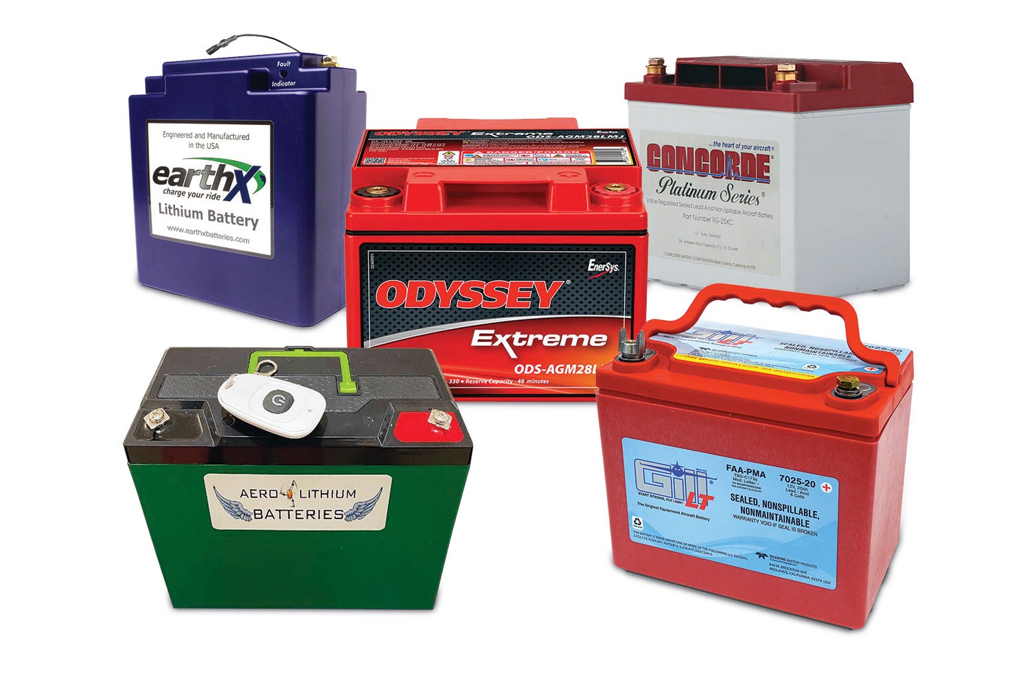

Concorde and EarthX are standouts.

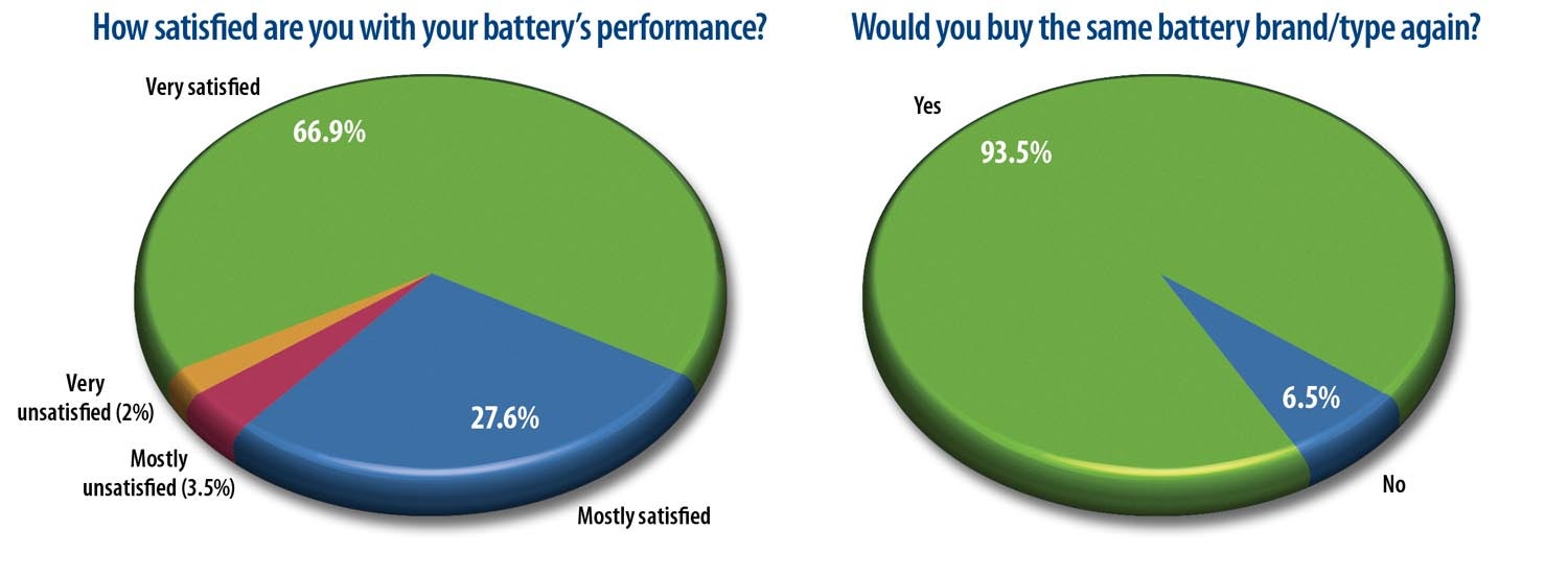

BatteryLeadIt isn’t much to ask. Cold starts, hot starts, flooded starts and starts away from home. We want a ship’s battery that boosts confidence. And since we’ll maintain it by connecting it to a smart battery tender when it’s parked (and maintain a healthy charging system), we expect it to last more than three years. Treated with kid gloves, our tendered motorcycle batteries last twice that long, even parking the bikes for long periods in New England’s harsh climate. The way we see it, the airplane’s battery should offer the same longevity.
Based on our recent battery satisfaction survey, not surprisingly, there are some brands that do just that. Others disappoint. The main stats and a few words about our polling can be found below.

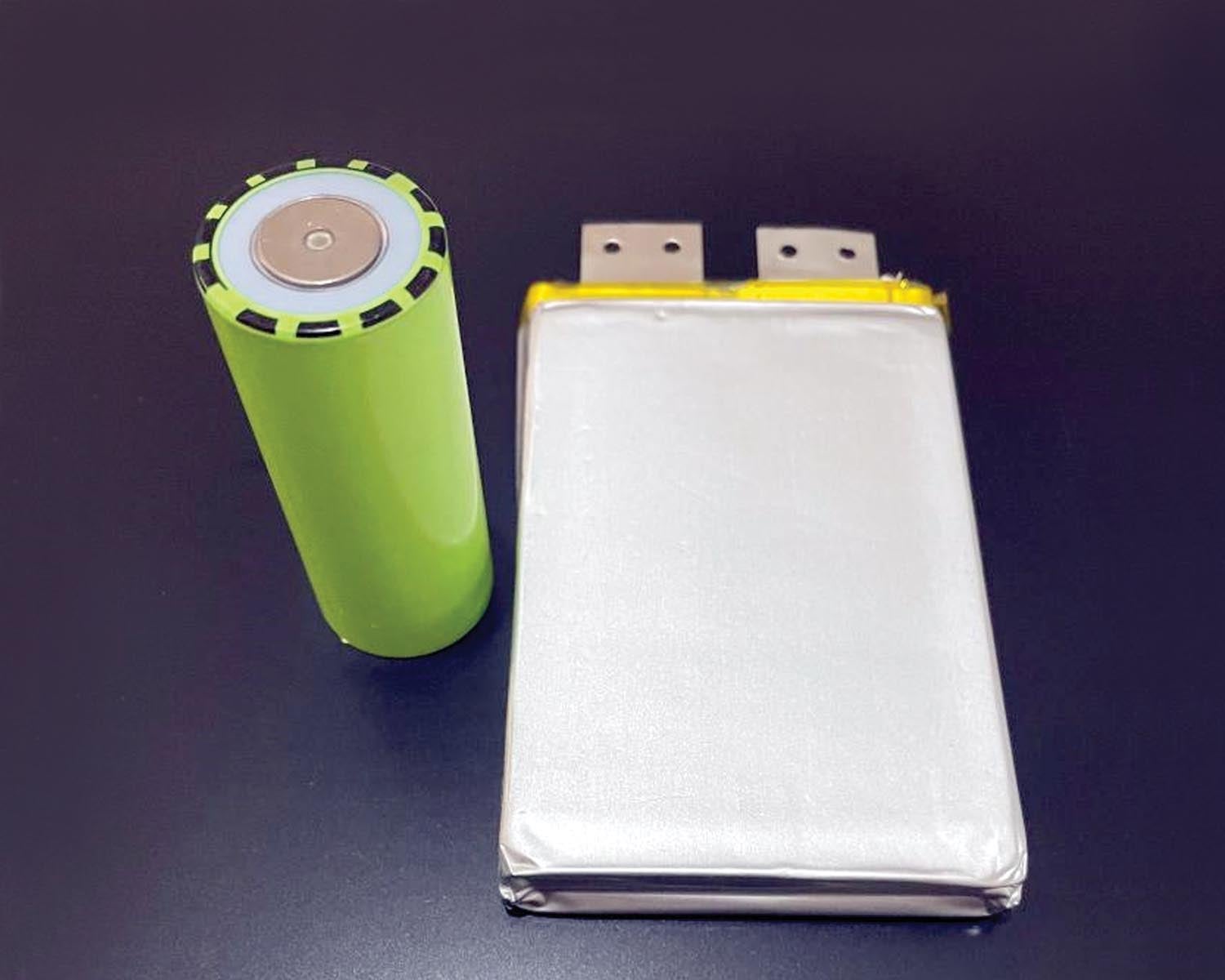

For ship’s power, think beyond the general wide-reaching term “lithium batteries,” because it’s actually lithium iron phosphate (LiFePO4 or LFP) batteries that suit typical piston engines. The batteries have four individually packaged 3.3-volt cells (eight cells for 24-volt systems) connected in series for a nominal voltage range between 12.8 and 14.4, compared to a traditional six-cell (2-volt-per-cell) lead acid battery. Since saving weight is a high priority for most kit builders, manufacturers boast that most models are nearly 80% lighter (that could be more than 10 pounds lighter) than typical lead acid and nickel cadmium cells. LFP batteries generally have a 4000-charge cycle life (versus 350 for a typical lead acid battery), they resist freezing and boiling over and they are flexible to install. Even mount one inverted, if you must—it won’t leak like an old-school flooded lead acid can.
av mag LiFepo4 cells
Forget everything you know about lead acid batteries when you take apart a LiFePO4. The cells have a low discharge rate, making them good for machines that sit for long periods.
Good news if you park your aircraft in a harsh climate for longer periods: LFPs have a low self-discharge rate and a wider operating temperature range. And, when corrosion is a concern, an LFP won’t sulfate. It can sustain a higher starting voltage while the engine is cranking (always a good thing), plus the discharge voltage is constant. While lithium iron batteries have a fairly steep drop-off when discharged, consider that a healthy 12-volt LFP battery can provide full cranking voltage (and amperage) until it’s depleted. Worth mentioning is that while it varies among equipment, in a 14-volt electrical system most avionics will go dark below 11 volts of power input. Put a meter across a fully charged 12-volt EarthX ETX series battery and you’ll measure 13.3 volts.
The individual cell’s charge level will diverge with repeated charge/discharge cycles and age. This condition reduces the performance (capacity) of the battery. Essentially, the battery’s charge level is only as good as the charge level of the weakest cell.

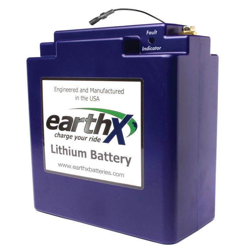

Colorado-based EarthX has roots deeply planted in the motorcycle/powersports market since the late 2000s. EarthX batteries ended up in Experimental aircraft even before the company focused on the market. But when company founder Reg Nicoson realized his lithium iron phosphate motorcycle batteries were going in aircraft, he went to work to improve on the design, with a sharp focus on safety. Today, EarthX works directly with a variety of aircraft OEMs, including Van’s, Sonex, Pipistrel, Glasair, Kitfox, Zenith, RANS, CubCrafters and Vashon.
Earth X Aircraft group
The EarthX lithium iron phosphate battery line includes both Experimental and STC/TSO-approved models. They all have a smart BMS and good product support.
EarthX has a useful utility on its website that cross-references engine models to compatible battery models. EarthX’s marketing director, Kathy Nicoson, said that the $449 13.2-volt model ETX900 has become the most popular battery for most kits. It has 400 CCA (cold cranking amps) and 840 PCA (peak cranking amps) and it weighs 4.9 pounds. It’s 6.5×3.0x6.6 inches and has a 15.6 Ah (ampere hour) rating.
Aircraft battery front fixed
The typical EarthX battery weighs roughly 5 pounds and is available in a compact casing. They pack a punch at 320 CCA.
Another common model is the $379 13.2-volt ETX680 (and compact ETX680C, priced the same), rated at 320 CCA/680 PCA and 12.4 Ah and weighing 4.0 pounds. It’s the same dimensions as the ETX900, but the ETX680C is 5.9×3.4×4.5 inches. The ETX680 series is intended for use with 60-amp (and smaller) alternators.
The Hundred Series batteries have redundant internal circuitry and battery fault indicators on the chassis. For full-time fault monitoring, EarthX sells an optional panel-mounted fault indicator lamp for wiring to the battery’s discrete output interface—a single wire with a quarter-inch insulated female quick-connect terminal. You can also wire the battery into an EFIS display’s general-purpose discrete input. There’s also an RS-232 serial connection on some models.

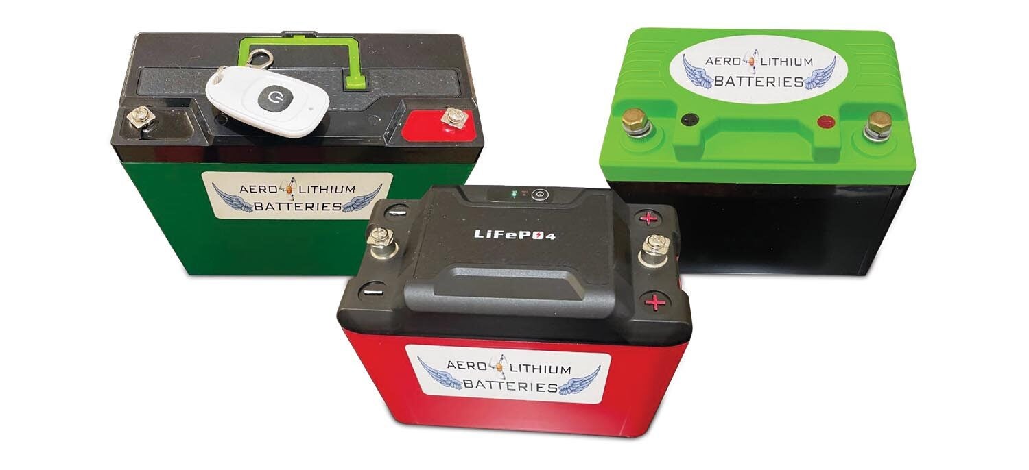

Texas-based Aerolithium was founded in 2008 and company principal Andy Harris (a retired A&P and ATP) reminded us that it was Aerolithium that brought the first ship’s LiFePO4 battery to the Sebring LSA expo in 2011. Today, the company custom builds to order LFP batteries for a variety of applications, including piston, turbine and electric applications. Our survey turned up only 33 respondents who own Aerolithium batteries, but comments were favorable on the company’s dry-cell batteries that have a three-year warranty (with a five- to 10-year usable lifespan) and are repairable.
aero 680 in RV 8 tail
We like Aerolithium’s custom-build approach, the Model 680 Series’ affordability and dedicated field support.
“My Aerolithium 980 battery has been very reliable and easily spins my IO-540 engine for quick starts,” said one survey respondent who flies local and cross-country flights a couple times per week.
Harris told us product support is important, offering customer service seven days a week. Someone in our survey vouched for it, saying: “Aerolithium has great customer service, even on weekends.”
The low-impedance 12-volt 680-Series batteries (available in 12- and 18-Ah and compact 7- and 12-Ah versions), according to Harris, are the most popular Aerolithium models for typical Experimental kits and are priced between $225 and $475, depending on the build. They’re intended to drop into common lead acid applications and are waterproof and shockproof tested to SAE and AS9100 standards. Options include an internal heater circuit, subzero supercapacitor for ops in freezing temps, an app for reviewing charge and discharge history, a tricolor LED status indicator and a key fob for what’s called the “second-start” or auto-jump option.Aerolithium e1680237549615
The auto-jump feature is essentially a lifeguard energy supply that enables the battery to reserve enough power to start the engine if the master is left on or something else drains it. Again, the smart BMS kicks in and stops any drain at a level higher than the normal low-voltage disconnect (LVD) or around 9.6 volts on a 12-volt battery. Press the key fob (or hardwired switch) and then start the engine within 60 seconds. Harris said that since the LVD is higher with the second-start option, he recommends a second backup battery. The option is only available on the regular-size Aero 680.
Aerolithium’s BMS capabilities vary depending on the type of battery a buyer wants. All BMSs have overcharge and overdischarge protection, over/undercurrent protection, over/undertemp protection, charge current limit protection, short-circuit protection and cell balancing. USA-built Aerolithiums are designed with a 2000-plus discharge cycle, and Harris noted that his batteries come standard with 8 AWG wire versus thinner 10 AWG wire found in others.
The company custom builds 28-volt batteries for turbines, plus lithium copies of legacy lead acid batteries from Concorde, Gill and Odyssey. Harris told us there’s a “12-volt model in the skunkworks that runs on a single cell providing 100% reliability and simplicity.”
“The Aerolithium battery’s capacity, storage, output current and charging current are all well controlled by the battery management system and far superior to the lead acid battery it replaced. I couldn’t be more pleased with Aerolithium,” said another respondent. He flies over 250 hours per year and parks in an unheated hangar.

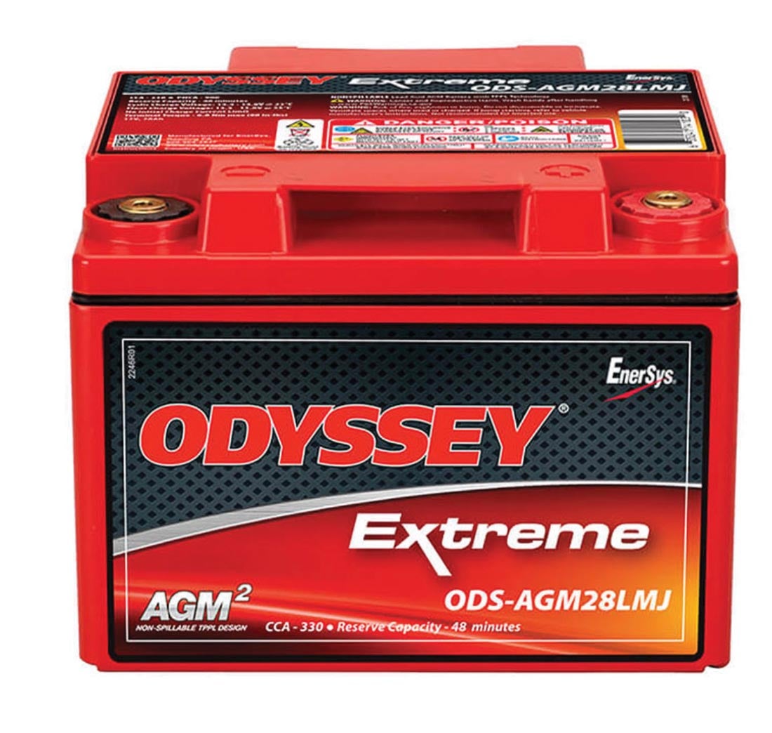

A big player in the powersports market, Odyssey is popular for Experimental aircraft (sold through Aircraft Spruce and a number of parts suppliers). Odysseys are sealed AGM batteries with an eight-year (best-case) design life. Odyssey boasts it’s the only battery in its class that is capable of delivering a large number of deep cycles (up to 400 when fully discharged or up to 500 when discharged to 80%), plus it’s a good fit for aircraft since it’s specially designed for high-vibration applications. Need to store it? Odyssey says its batteries will maintain as much as 50% charge after sitting for two years at 77° F—and maybe longer when it’s cooler.
Odyssey AGM28L
Born in the powersports market, Odyssey Extreme series batteries get high marks for reliability and price.
“Odyssey AGM batteries have an incredibly low self-discharge rate. I often do nothing to the battery, then start it after several months of sitting dormant, and it cranks right up, even in the Alaska winter,” said one respondent, who checked the box saying he would buy another Odyssey. On the other hand, when asked if he was satisfied with the outcome of a warranty situation, he said he wasn’t and that “the company was unhelpful.” When it comes to batteries, we think buying from a responsive distributor is a good plan. We heard positive feedback about working with Aircraft Spruce and Wicks Aircraft.
Advertised as having a three- to five-year service life, another said his two-year-old 170-CCA Odyssey PC680’s life expectancy was shorter than he expected, saying, “This is my second PC680 and the cells seem to deteriorate quickly.” He told us he flies it locally twice per month, stores it in an unheated hangar and doesn’t keep it tendered.
On the other hand, we heard of one Odyssey battery surviving the test of build time: “While building the aircraft, I bought the battery to provide dimensions for the battery box and mounting. During that time (several years), I regularly discharged the battery partially with the load of an LED landing light, then recharged the battery. I did this several times a year for three years. When the aircraft was finished, the Continental O-200 lit off before one complete revolution of the prop. Can’t expect any more from a battery than that!”
“Bulletproof—it works in any position and it’s relatively light,” one responder said of his Odyssey PC680 series. It’s eight years old, stored in an unheated hangar and isn’t connected to a battery tender; the pilot doesn’t use external power, but he does fly several times per week. We think that makes a difference.
BM AIK2A BM 244CEC1 AA S5 Piper Mirage 20180618
A properly wired battery tender (not a charger) is a proven way to keep a battery healthy when the airplane sits. This is the aircraft-specific BatteryMINDER product.
A popular Odyssey model is the 12-volt Extreme AGM16CL, street priced around $190. With 220 CCA, it weighs 12.2 pounds and measures 6.7×3.0x7.0 inches. Another is the AGM15L (street priced around $150), weighing 11.4 ounces and spec’d for 150 CCA. It works in tighter spaces, measuring 6.7×3.3×5.1 inches. Visit Odyssey at www.odysseybattery.com.
