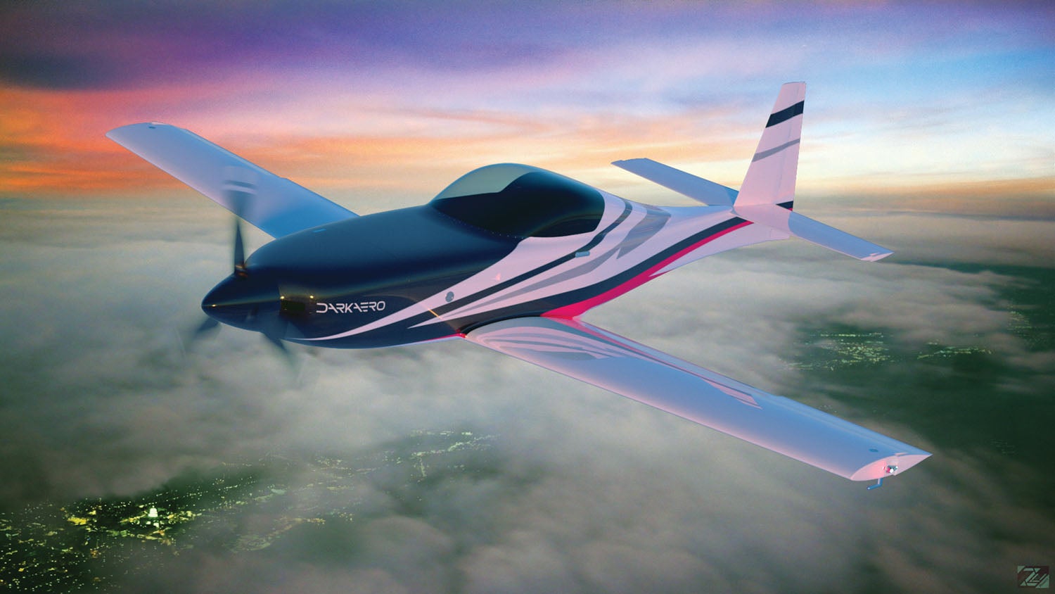

0.1 DarkAero 1 rendered in flight

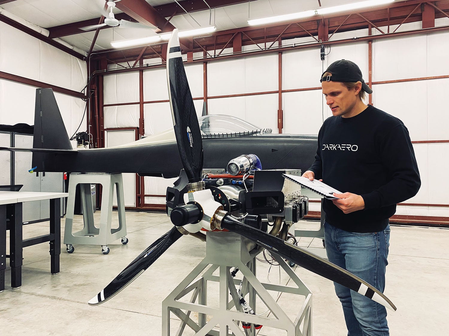

14 Ryley with the propeller and engine
Ryley with the Airmaster propeller and ULPower engine. A standardized firewall-forward package will make powerplant installation faster and easier.

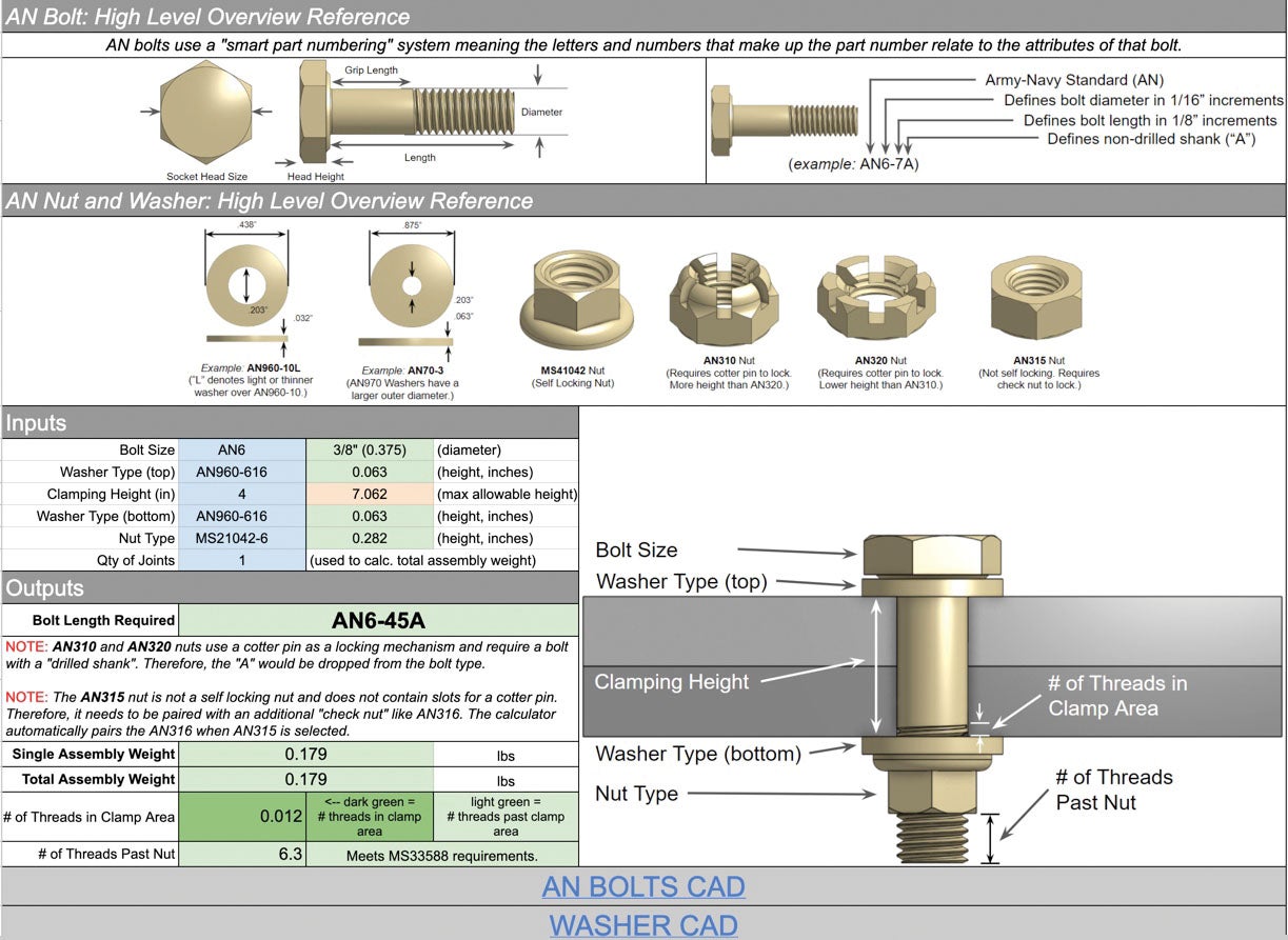

15.1 Aircraft fastener tool on DarkAero Knowledge Base
This aircraft fastener selection tool aids in choosing appropriate nuts and bolts. It is available for free public use on the DarkAero website.
