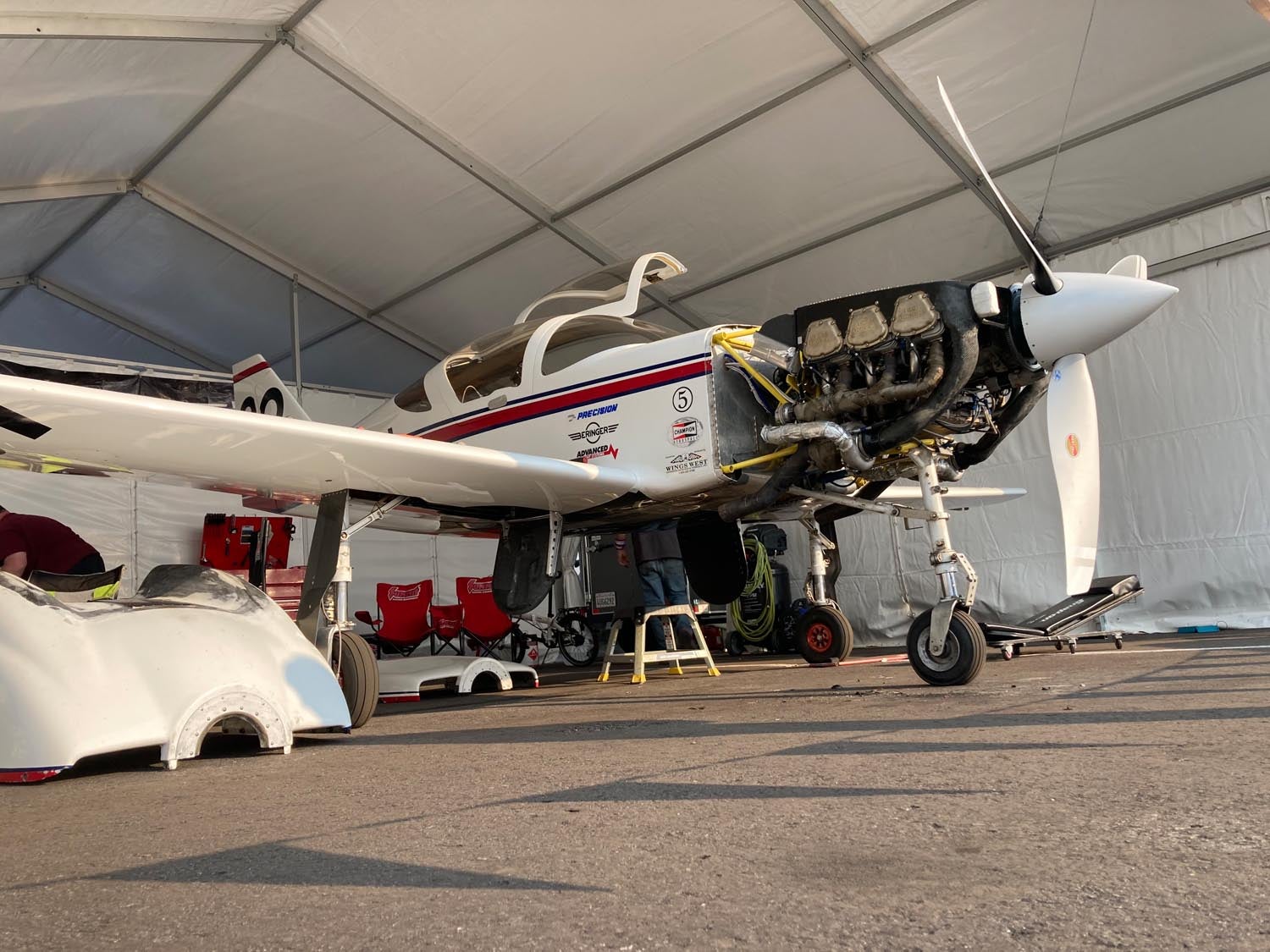

Far worse is poor Karl Grove. A completely one-off connecting rod failure yesterday (incorrect heat treat) took out that cylinder, then punched a hole in the opposing cylinder and spread debris throughout the engine. A good size trash fire manifested itself out the tailpipes as hot oil got where it wasn’t supposed to be and Karl did an excellent job under pressure to immediately land the now dead stick Lancair on the runway then below him. With the prop flat in low pitch the deceleration was tremendous and Karl’s approach was short and sharply downhill. It meant a high-speed entry onto the thankfully long runway, but braking was sufficient to end the flight with no further damage.
This engine loss is particularly disappointing. The liquid-cooled AC Aero/Lycoming engine was being brought up to meaningful power levels for the first time, indications were very good (331 mph lap speed) with plenty more left to go and we were anticipating a new, mechanically significant contender in Sport Gold. The broken connecting rod is just one of those things; post-incident testing showed it was soft, with below specification heat treat so it was a supplier issue. This is just the sort of failure that’s impossible to see visually and causes maximum damage. Too much debris has been circulated through the engine to heroically salvage it in time to race and there is no spare engine in the pits, so Karl has been forced out for this year. Luckily the engine case was not damaged so repairs are going to be much easier to take than they might have been.
