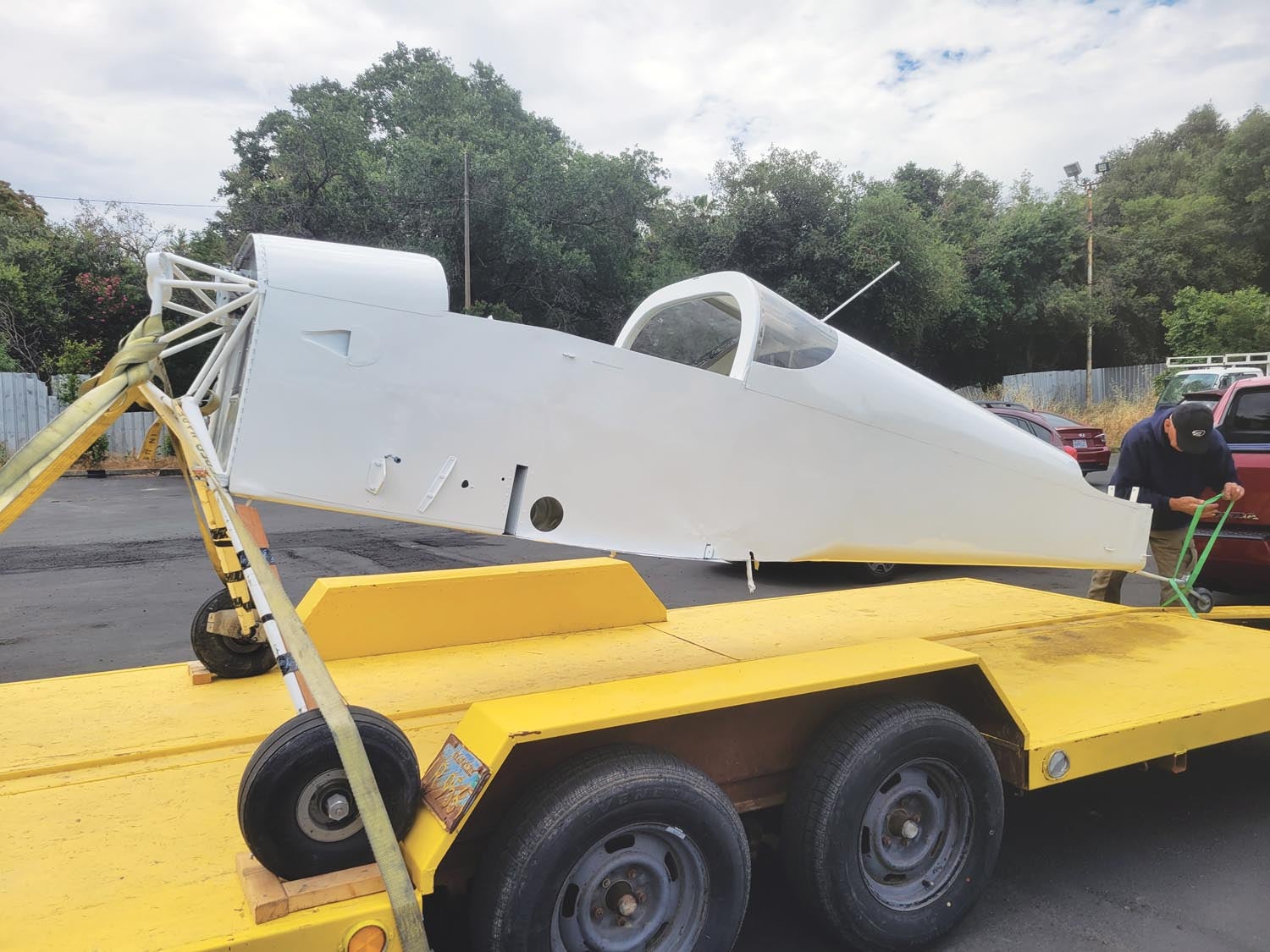

Stan and I ensured that the fuselage of N2165U would not fall off the trailer (left). By using multiple ratchet straps attached to the engine mount, we fastened it down tight. I followed Stan on the freeway (right) to make sure the fuselage didn’t move and to create a buffer for traffic. I couldn’t help but admire my beautiful airplane all the way home!
A Fuselage on the Freeway
With the goal to get this done by July for Oshkosh 2023, Hangar 32 had become a 12-hour workshop. (Spoiler: I didn’t make it to AirVenture last year…) If I wasn’t there working on my plane, then you can bet that Kerry or Stan was. The big thing we had to wait on now was the paint. Our friend Justin Frei owns a company called Ultimate Collision Center. He and his team pushed super hard to get the paint done for all of the parts. His main guy, Gabriel Lopez, organized the team and got the parts done.

A few weeks later, Stan, Gabe and I loaded the fuselage onto the trailer, tied it down with what seemed like a million ratchet straps and pulled her home on the freeway. I followed in my car to create some space in traffic and ensure it was secure all the way home. A fuselage on the freeway? What a sight.
