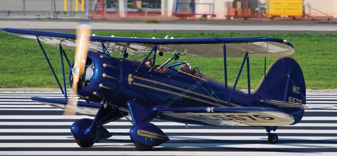

Paint Inspo Waco
I saw this Waco YMF-5FC in blue and gold at Oshkosh 2022 and loved the paint job and color combo.
After all the sanding was completed, I turned my focus to painting and started to look up paint scheme inspiration and found a few that I liked. These included the Cirrus SR22 in Himalayan Salt, black and silver, and the Waco YMF-5FC in blue and gold. And yes, both aircraft are gorgeous, but the paint jobs are beautiful too. The fancier the paint job, the more expensive it gets. So I may need to make it white and put vinyl on top. There’s still plenty of time to decide.
