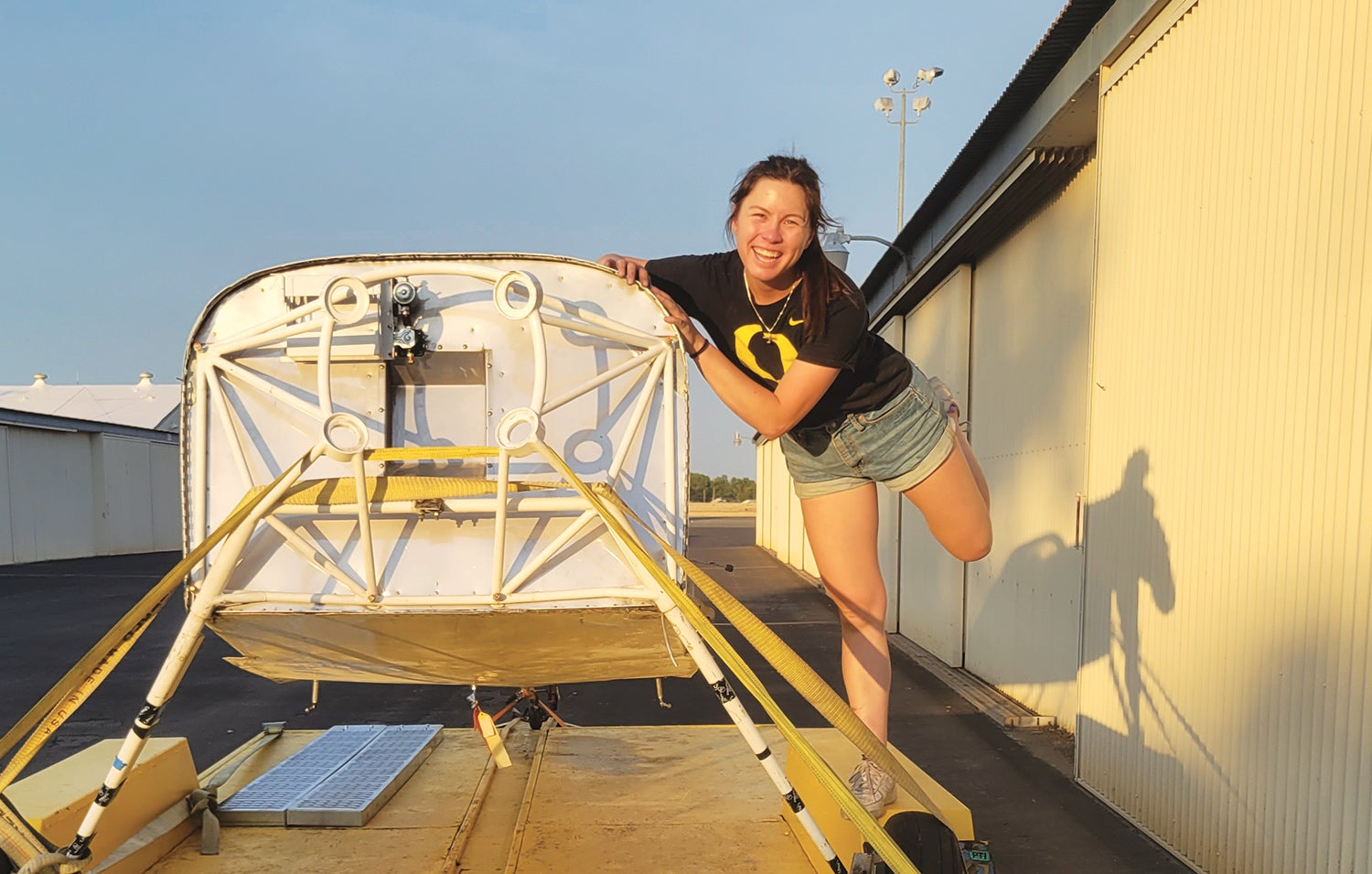

Using a couple of boards, iron floor flange fittings and pipe, Stan built some nice handles for the wings of the RV-6 so that when we removed them they would be easy to handle (left). Finally at the paint shop (right), me with my feather-filled wings, ready for paint!
Building Handles for the Wings
The wings of the Van’s RV-6 (or any plane for that matter) are large and somewhat bulky, so when removed from the aircraft, they are hard to hold onto. Stan thought ahead and put boards through the lightening holes of the end rib of the wing, then screwed a board on the outside to the boards on the inside. He then put the Southland 3/4-inch black malleable iron floor flange fittings on the outside of the board and used them to attach 12-inch pieces of 3/4-inch pipe to use as handles when moving the wings. Genius!

The fuselage rolled out of Hangar 32 for the first time in over a year (left). Stan stands on the trailer with the wings on the fancy wing rack (right). The rack and wings were secured to the trailer with many, many ratchet straps.
Here’s the thing though. We weren’t “just” taking the wings off. This was going to be an entire process.
The wings of a Van’s RV-6 are mounted to the aircraft with 50+ bolts. After that, all we needed to do was to get a few people to grab onto the wing, pull it off and set it up carefully in the hangar. And the next day, that’s exactly what we did. Stan, my boyfriend, Zach Lauzon, and I worked together to pull the wings off. We placed them on some old tires in the hangar.
After that, I organized the hangar while Stan and Zach went to get the trailer to load the fuselage. Stan deflated the tires on N2165U to absorb impact so the fuselage wouldn’t bounce around much en route to the paint shop. Finally, after sitting in the hangar for over a year and a half, the fuselage of N2165U saw the light of day. We rolled it out onto the trailer, carefully lining up the wheels on the metal roller loading things and backed it in, tail facing the front of the trailer. Stan secured the wheels by screwing a couple of 2×4 pieces into the trailer bed. Then, we really tied it down with multiple ratchet straps.
