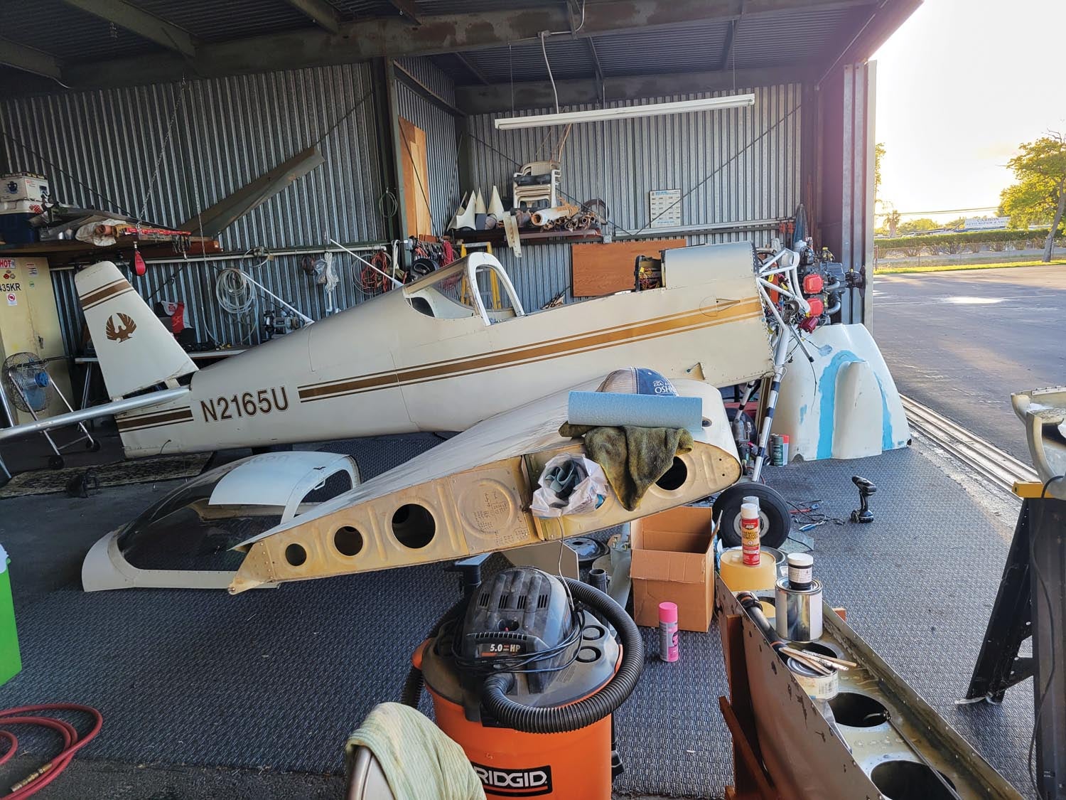

Sanding
The next big project after fuel tanks is definitely going to be sanding. N2165U is in desperate need of a paint job, so we are going to give it one! The painting part is easy compared to the prep work. The best sanding is done by hand, so you can smoothly and consistently remove the paint from the plane without leaving irregularities on the surface. Kerry showed me how to wrap the sandpaper around a piece of foam and hand sand, letting the sandpaper mold to the surface of the plane. I was instructed to not push too hard as well.
Dry sand leaves dust and residue everywhere, so we started with wet sand. This allowed us to sand without breathing in the paint and to keep the hangar clean. I know sanding will prove to be a long and tedious process—wish me luck and/or send me condolences.
