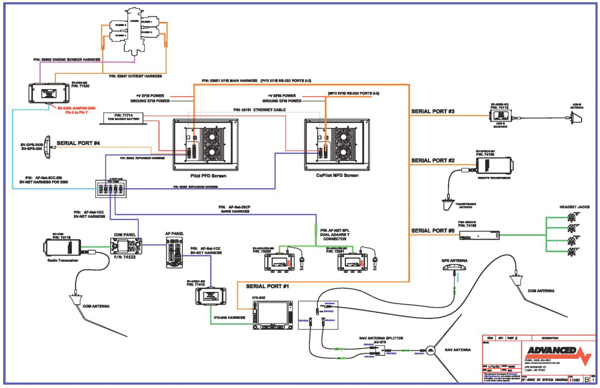

Where to start? First, we need to understand what components I have to determine what needs to get done. It all starts with two harnesses, the engine sensor harness and CHT/EGT harness. They connect to the Engine Monitoring System (SV-EMS-220) to provide information about the engine. The EMS then connects to the Advanced Control Module (ACM).
Ah, The ACM. The center of it all. It’s Advanced Flight System’s genius idea to make it all a simple plug and play. A central place for everything to connect and talk to what it needs to talk to. The ACM has 20 different ports. Of the 20, we are only going to be using 17—and they connect to, among other things, the EFIS primary display, backup battery, transponder, audio panel, backup EFIS, com radio, autopilot servos, panel switches, pitch-trim motor and, of course, the rest of the SV-Network data/power cables.
AFS 3
In order for me to get a better understanding of the AFS system, I drew everything out. This is the AFS components diagram customized to my own airplane, N2165U.
The ACM allows us to wire two to five avionics data buses. These include the Dynon Advanced SV-Network, RS-232 serial data, ARINC 429, ethernet and CAN bus. The SV-Network is the main one that I will need, because most of the Dynon components connect to it to talk to the EFIS screen. These include the SV-EMS-220, SV-ADAHRS-200, SV-COM, SV-AP-PANEL, ACM and AP Servos (pitch and roll). I also need the RS-232 serial for the backup EFIS (probably a Garmin G5), remote transponder, ADS-B receiver, audio panel, SV-GPS, ACM and radio transceiver. Right now, I don’t need the ARINC 429 (no certified GPS yet), the ethernet connector (I only have one EFIS screen because I’m broke) or the CAN bus (not a FADEC engine).

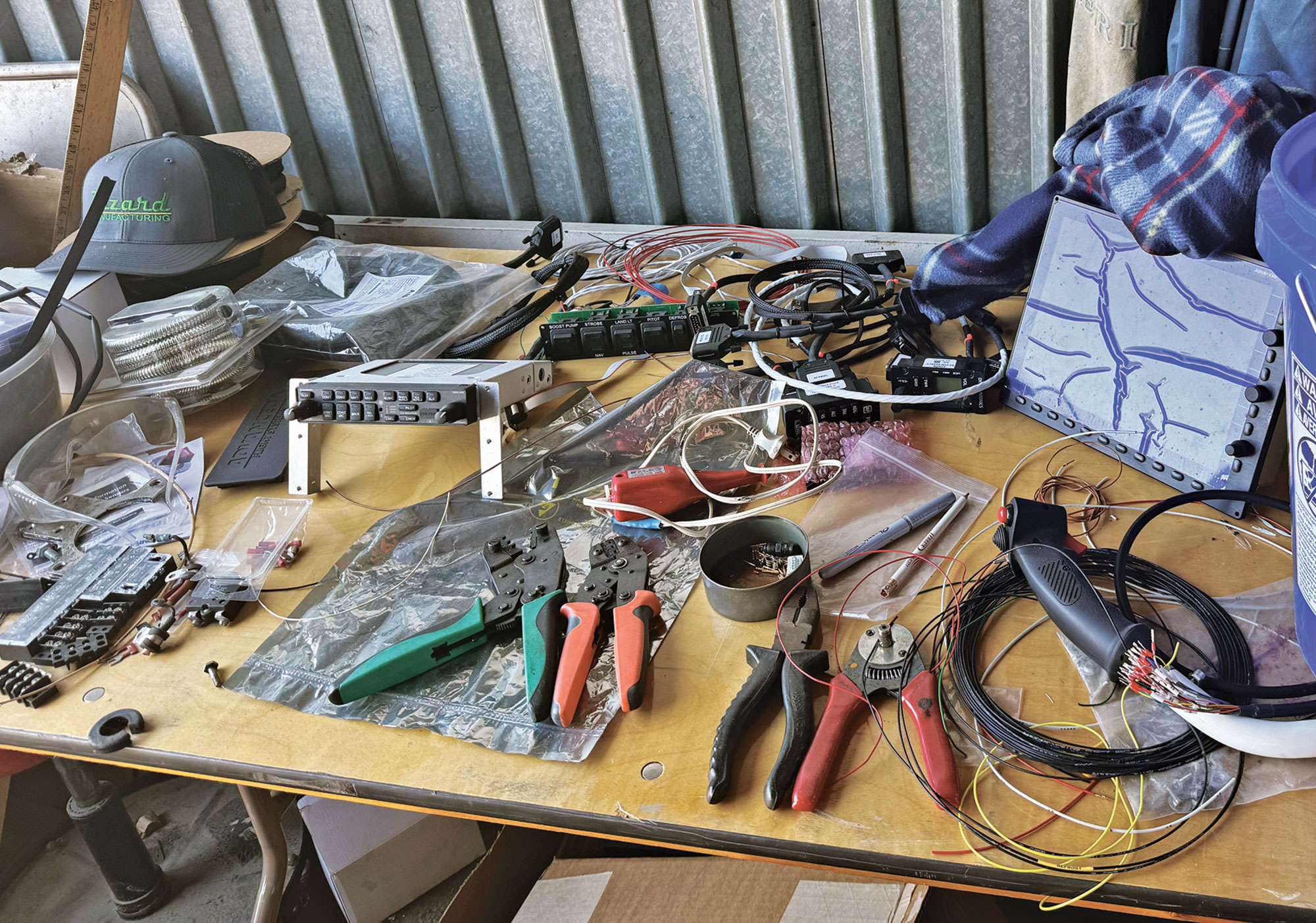

Shawn and Kyle and I hooked up SV-COM-PANEL and SV-AP-PANEL using 6/32 screws. Then we attached the switch panel and made the wires as neat as possible. We swapped some of the SV-Network harnesses around, as the one connecting the com panel to the ACM was too short. We need to get a new ribbon because one that connects the switches to the ACM isn’t long enough.
IMG 7662
The dedicated wiring table, complete with an audio panel, AFS 6600 EFIS, switches, com and autopilot panels and a control stick ready to be installed.
“Guys, I have a question,” I asked as we were plugging things in. “What the heck is a bus? I googled it everywhere and still don’t get it.” Shawn replied, “It’s a yellow vehicle that takes you to school.” Smart aleck. Kyle finally explained it in a way that made sense. “Imagine shouting information out to a room full of people and whoever needs the information will take it. Anyone who doesn’t will just ignore it. That’s a CAN bus. Now imagine talking on the phone and giving someone information directly. That’s a serial port.” Kyle said. Ah, the light bulb turned on.
