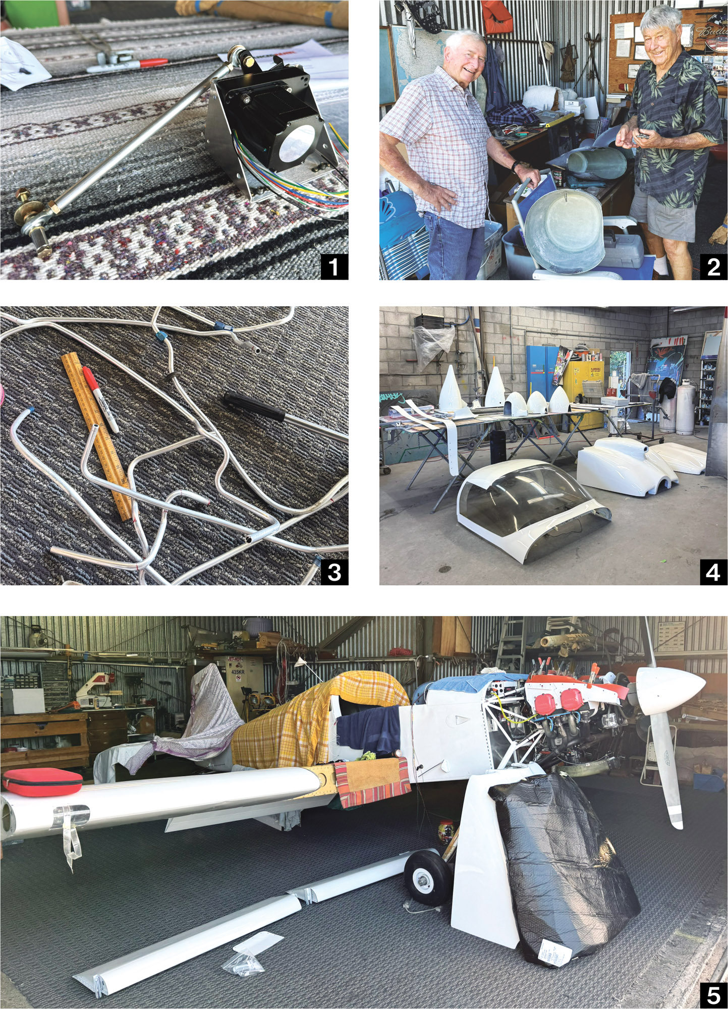

1 The autopilot servo from Advanced Flight Systems with the arm and bracket attached. 2 Joe Marquering and Kerry Richburg working on another one of their many “walnut ranch” projects while Stan and I tackle the servos. 3 My multiple attempts at bending the fuel line to my right wing. With the encouragement of my friends, I finally managed to get it right! 4 Final pieces painted by Justin’s team at his auto body shop, including the wheel fairings, cowling, canopy and various other parts. 5 Finally, N2165U had all of its parts ready to be put back on. It’s really starting to look like an airplane again!
Odds and Ends
I finally ordered my autopilot servos and received them in the mail! I waited to order them because I needed to save up. Once I placed the order, Advanced Flight Systems shipped them to me and I had them in two days. In the box, I got the mounting kit with instructions, the long output arm servo and bracket kit, and the standard output arm servo and bracket kit. After riveting nut plates to the bracket, we puzzled the backing plate to it and screwed it on. From there, we figured out how to attach the servo to the other side with four long bolts. The arm attaches the servo to the aileron with two bolts, spacers and long washers, similar to how we had mounted the aileron earlier.
After lots of trial and error, I finally finished cutting and bending my last fuel line to run the fuel from the right wing to the fuel selector. I messed up so many times that I had to order new tubing! I was trying to be a perfectionist with it but was ready to settle for what I had when Bruce stopped by. He encouraged me and reminded me to always strive for my best workmanship. He showed me a piece he kept from his RV-7 project that he had redone 10 times before getting correct—he had kept each piece he made as a reminder to himself to not give up! Also, Kerry noticed my multiple attempts and left me a note with a tidbit of advice to try bending copper wires first to use as a template, then match them with my more expensive tubing. I’m so thankful for both of them!
Picking up the Last of the Control Surfaces With Zach
Justin Frei, Gabriel Lopez and the rest of the amazing team at Ultimate Collision Center finished painting the last of my airplane parts! Thanks to my parents’ 1996 Toyota Land Cruiser and Zach and Gabe’s help, we were able to fit all of them in the car in one try. These parts included the canopy, cowling, wheel fairings, gear leg fairings, transition fairings and inspection plates. Like all of the parts from before, these all looked amazing! Thank you again, Justin and team!
