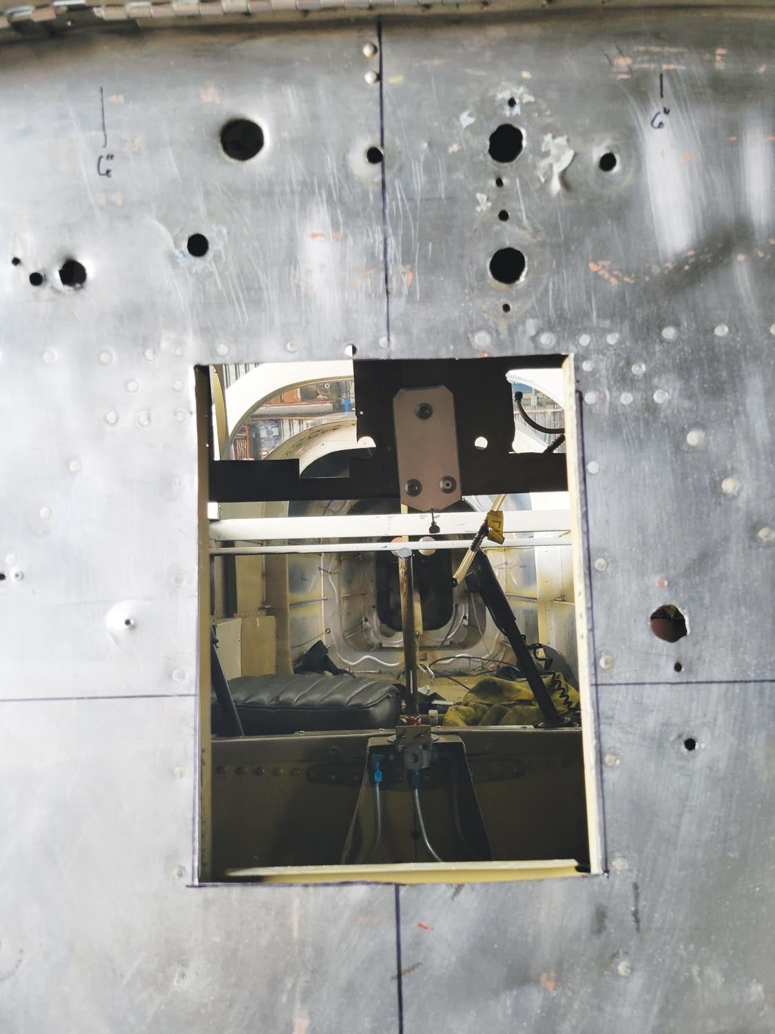

rv6 restoration 07
We removed the engine mainly to have better access to the firewall (left). Turns out, the new spin-on oil filter doesn’t fit between the engine and firewall, so Stan cut a hole and crafted a box for it (right). It’s so much cleaner now!

As you may have seen in previous photos of this project, the engine has been removed, not to have it overhauled but in order to provide greater access to the firewall. For one, the original oil filter was very large and heavy, so we replaced it with a spin-on oil filter. Unfortunately, dimensions of the spin-on filter were too large to fit between the engine and the firewall. Therefore, Stan cut out a space in the firewall and crafted a box in the middle. The original firewall had many holes where different parts and pieces had been mounted to it. It was also dirty and damaged at the bottom, so we ended up measuring a piece of stainless steel and riveting it on to create a cleaner look as a whole. To do this, we removed the engine mount and main landing gear. The vacuum system and pump were also removed as they will not be needed because I won’t have pneumatic gyro instruments. There were also oil lines for a constant-speed prop. However, as I have a fixed-pitch prop, we chose to remove those. We are also moving the battery from the cockpit to the firewall.
All of this is more than simply cleaning up. But I want my airplane to be right, to be safe, and my “Sacramento ground crew” seems to want it that way. Next time, I’ll get into the process of removing the fuel-tank slosh.
