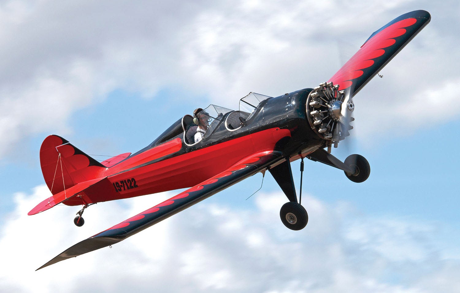

Then, out of nowhere, I stumbled across a picture of a plane that has always made my heart flutter. So, out goes all the logic, my stack of aircraft plans was tossed into the closet, and I ordered yet another set of plans. The new plans are for a plane that will only carry two, is open cockpit and is constructed of tube, fabric and wood. It did take some research to locate the plans, but after a quick electronic banking transaction, I received the PDF version of the Spacewalker II plans. (The full-size drawings should arrive before you read this article.)
Starting as a single-place, open-cockpit monoplane, the Spacewalker begat the Spacewalker II, a two-place version. The designs were sold and renamed the Warner Revolution I and II. From there, the family tree grew a few branches; one was the Sportster, which visually is similar but not a Spacewalker. The other branch of the family tree hangs a Rotec radial engine on the front and alters the structure to handle the new engine, lengthens and strengthens the main landing gear, and makes some other minor changes (see “Radial Revolution” sidebar below).

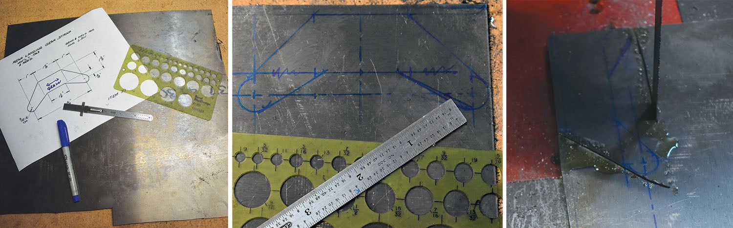

While scratch builders generally start with the wings, I elected to begin with the steel bits first. After looking over the plans and making a list of all the .080-inch thick parts, I ordered an 18x18x.080-inch sheet of 4130 chromoly steel plate. A little over a week from when I first ordered the plans, I was cutting steel.

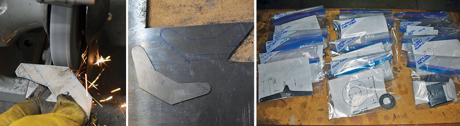

My process is to look up a part I want to make, use the snipping tool that is included in Microsoft Windows, clip the part I want to fabricate from the PDF and print the snipped image. Knowing the drawing will not be to exact size (desktop laser printers tend to distort whatever they are printing), I then draw the part right on the steel plate and proceed to cut it out.
The four heel brake tabs/pedals were the first parts I made. I elected to add lightness by drilling a lightening hole on the tab of each. The other minor change I made was to press in oil-embedded bronze sleeve bearings wherever a hole will be a pivot point. My thinking is that by adding the oil-embedded bronze bushings, I will not have to lubricate them, and should the holes get wallowed out with use, I can press the bushings out and replace them. As a builder, you must be sure to read and understand the drawings; in the case of the heel brakes, left and right brake levers are required.
