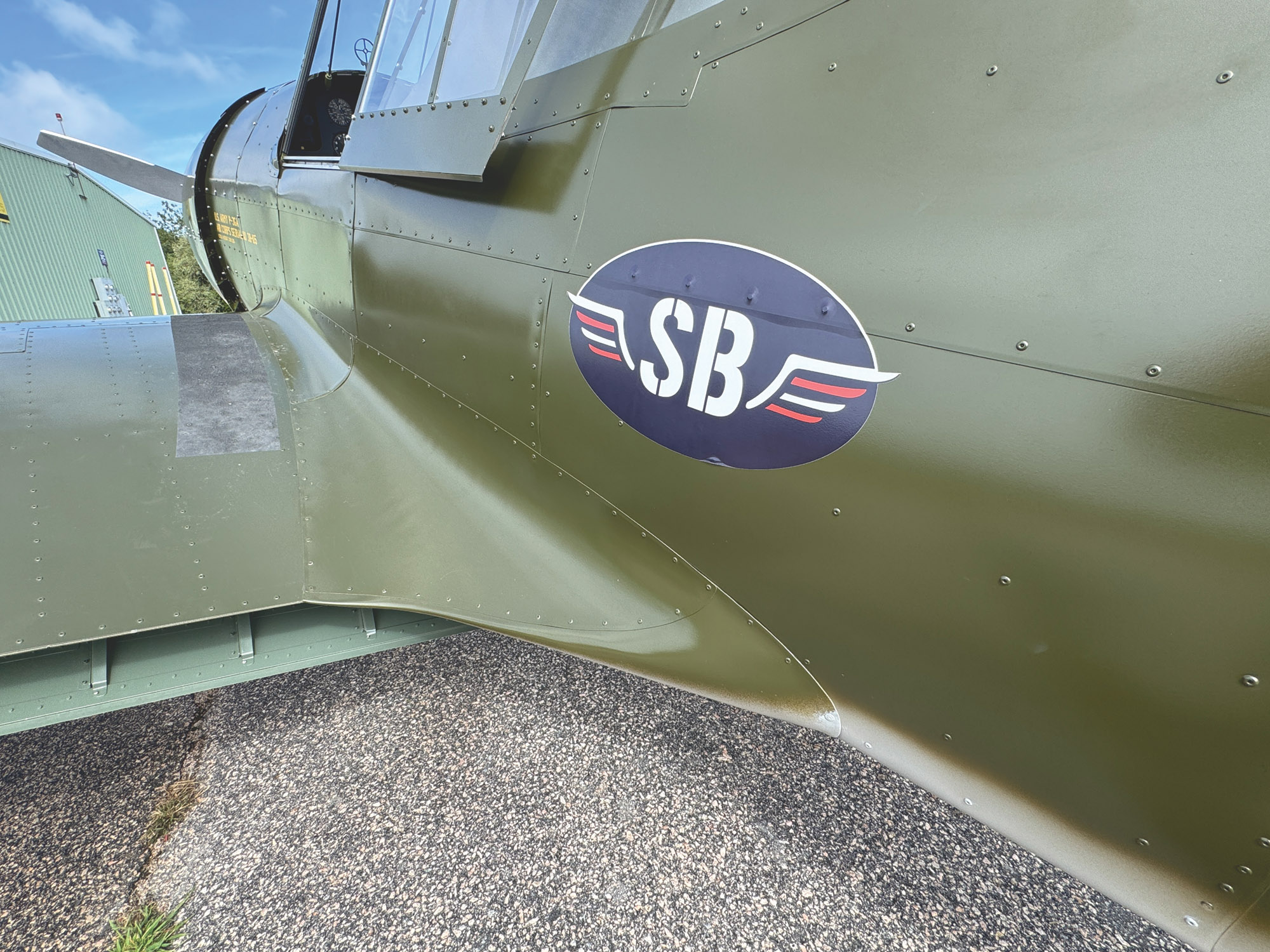

scalebirds p36 hawk 011
The “SB” stands for ScaleBirds. This is the start of their Air Force (or Air Corps if you prefer).

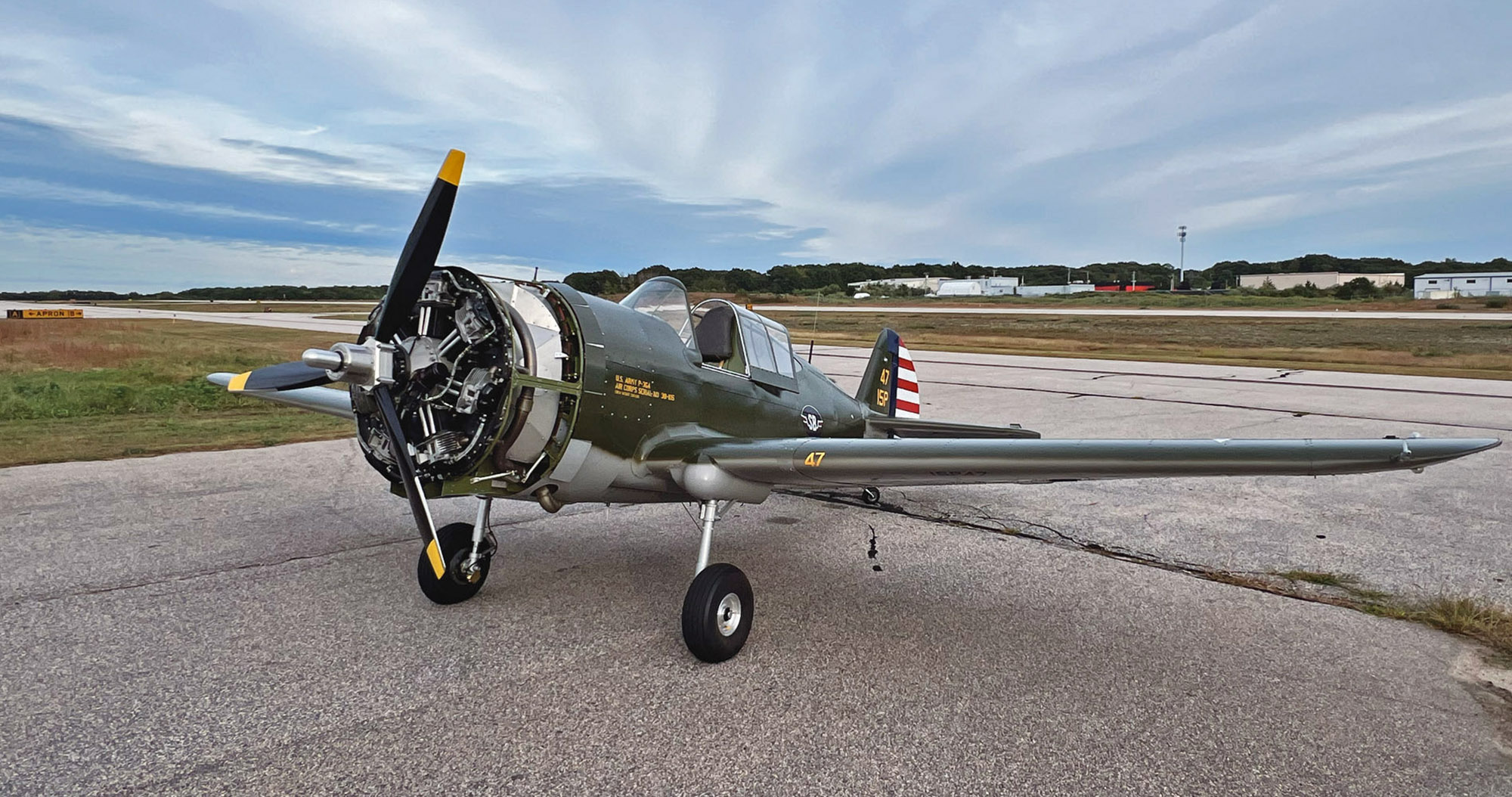

scalebirds p36 hawk 007
With the cowl removed and nothing else for scale, this could be a real P-36 sitting on a ramp in 1938, waiting on a mechanic.

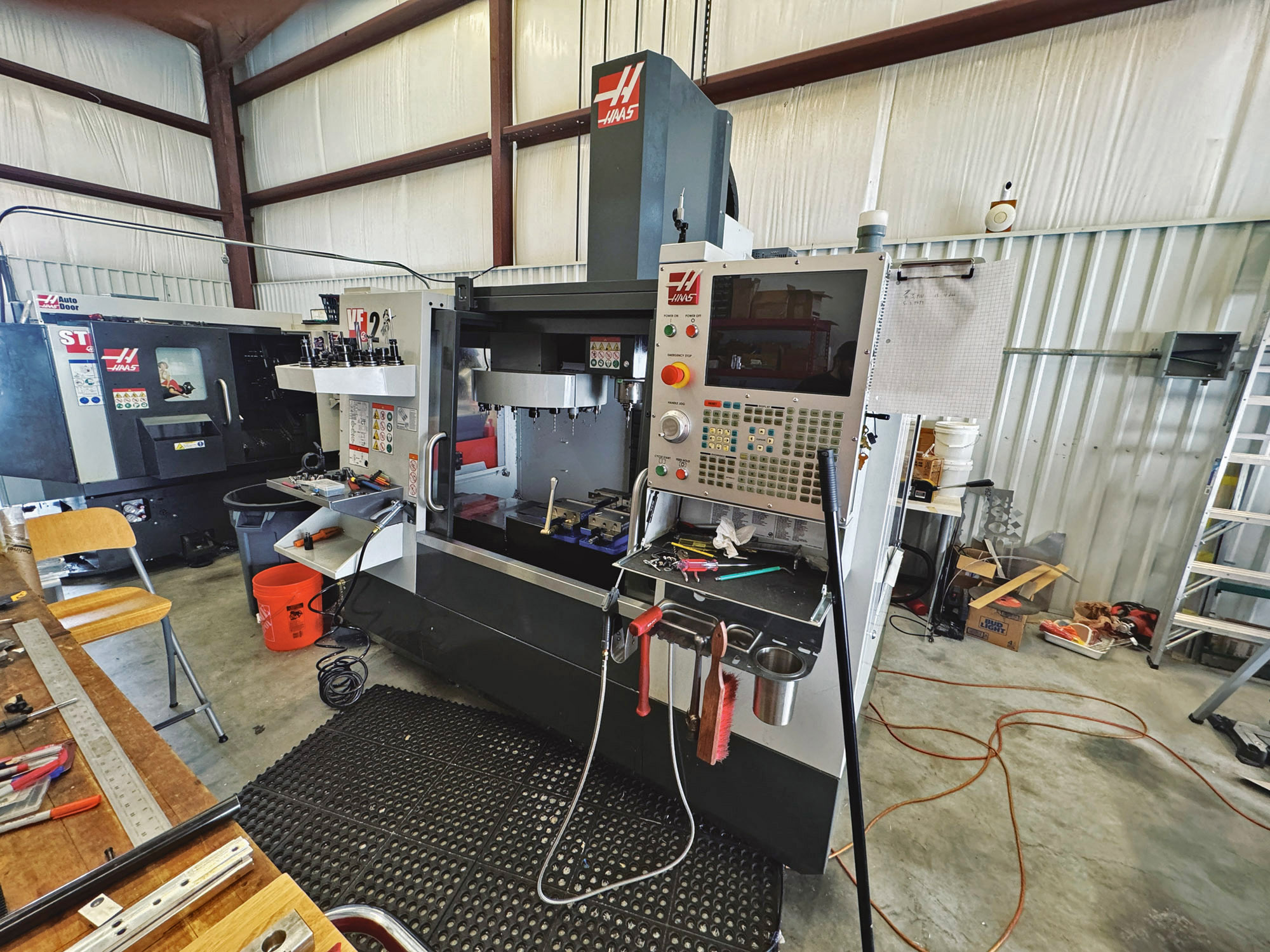

scalebirds p36 hawk 014
CNC machining tools are the heart of the ScaleBirds fabrication operation.

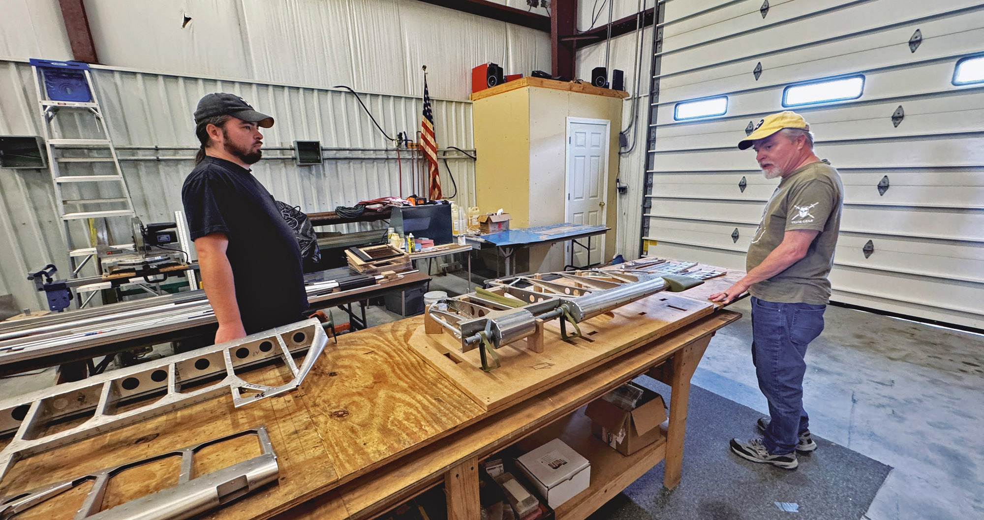

scalebirds p36 hawk 013
Scott and Sam Watrous are busy producing tail-kit parts for the first batch of builders.
The ScaleBirds operation is not large, but it has a lot of heart—and the heart is a workshop populated with CNC lathes, mills and router tables to produce parts. There are currently five “beta builders” who have received tail parts for their P-36/P-40 projects and these should be followed soon by fuselage parts. As of this time, complete kits are not yet available, but the company is working at a steady pace to get there.

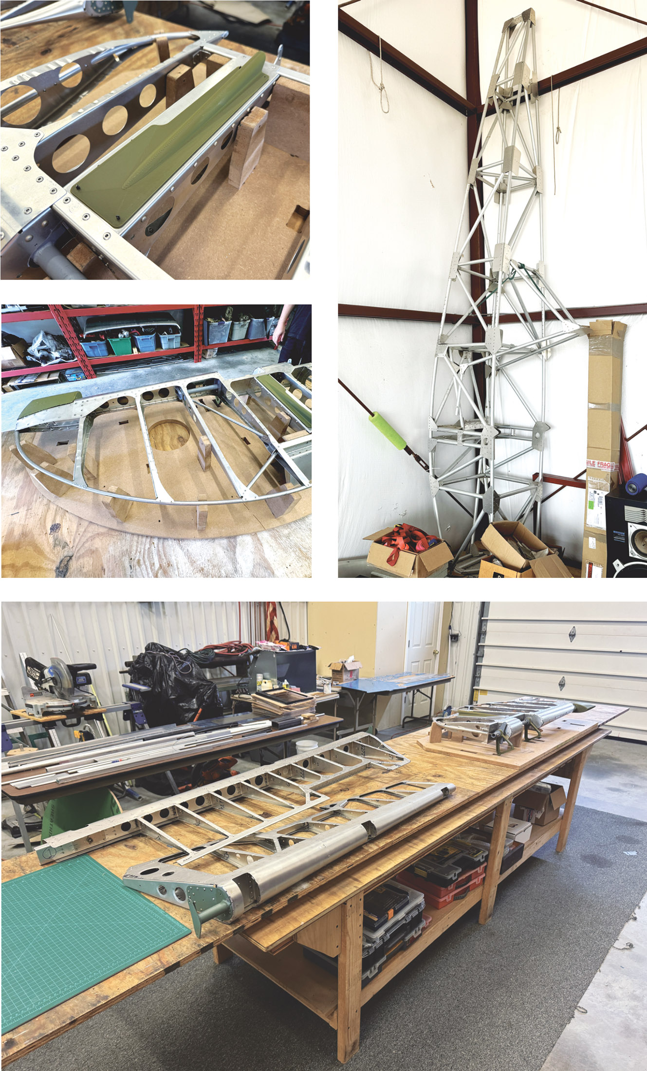

The airplane uses a combination of building techniques. The control surface frames are aluminum frames—some tubes, some stamped ribs—with pulled-rivet construction. You then cover them with fabric—the factory used Airtex for its simplicity. It was common for WW-II fighters to have aluminum primary structure and fabric-covered controls. The commonality of control surfaces between the P-36 and P-40 allows you to start right away and make decisions later.
The fuselage is not (currently) a monocoque structure—it has an internal tube-and-gusset frame created with pulled rivets, with a sheet metal structure creating the external shape. This again allows them to build a variety of different aircraft using the same basic “loaded” structure. There was some discussion of this being changed to a more traditional monocoque design, but what they have works just fine and will probably go into the initial kits. All of the structures were statically load tested.
scalebirds p36 hawk 016
The structure of the control surfaces is built with pulled rivets (top left). An early fuselage prototype structure sits on end in the corner of the hangar (top right). Control surfaces are aluminum frames with fabric covers (center left). A completed rudder frame awaits covering (above).
The wing uses a built-up main spar and is of traditional pulled-rivet aluminum construction. When you are designing parts using CAD and cutting patterns to make form blocks using a CNC machine, it isn’t that much harder to build a tapered wing, so in the interest of authenticity, that is what they are doing. One item of note. There are plans to shorten the ailerons by about 6 inches, making them closer to scale, and lengthening the flaps into the space for future iterations. This should give better flap authority and tame the very sensitive ailerons a bit as well.

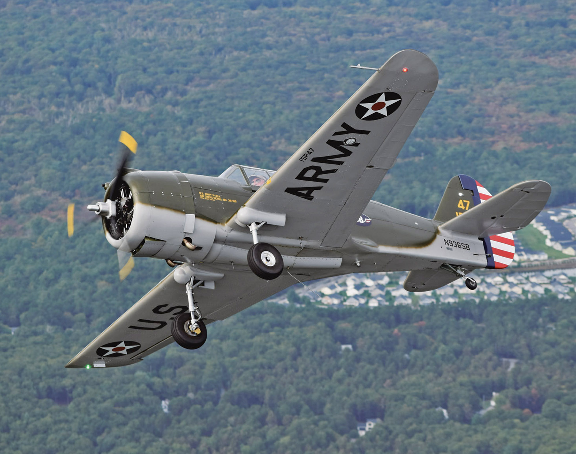

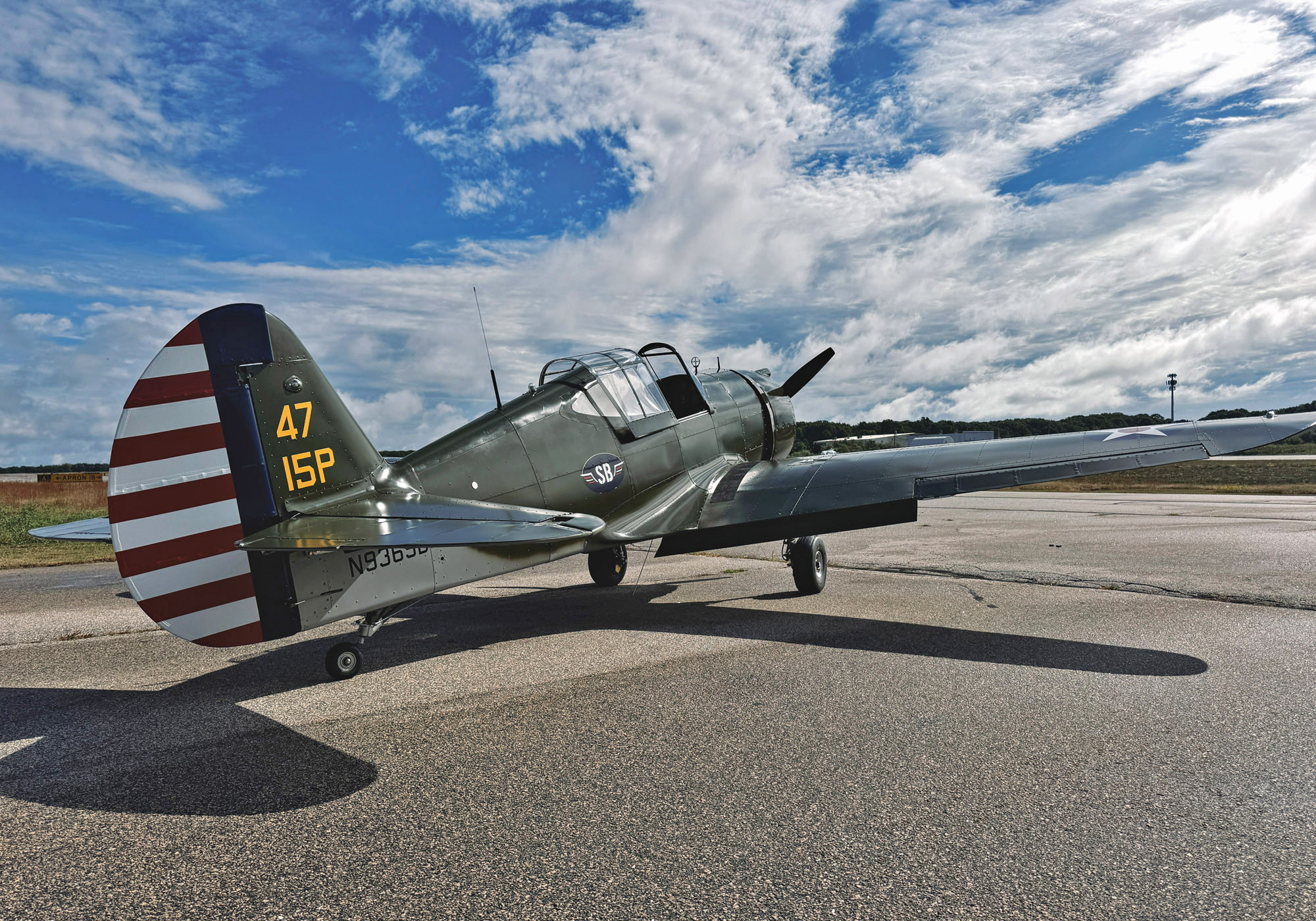

The landing gear in the flying prototype is fixed. It looks a lot like it is retractable because it is designed to go that way in future aircraft. It looks perfect on the ground the way it is, but a little odd in the air with the gear down—so retracts would be nice. However, retracts come with the price of complexity as well as taking the aircraft out of the LSA category.

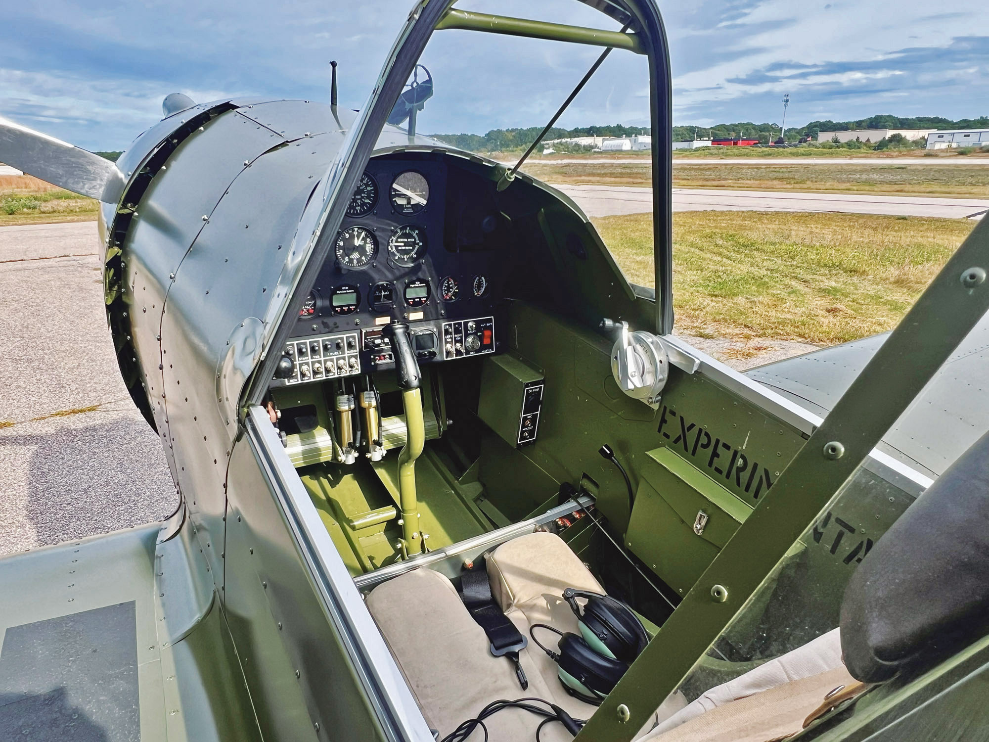

The cockpit of the ScaleBirds P-36 is roomy for a single-seater, making me wonder at the wizardry used in scaling the aircraft. I have flown full-sized warbirds with less room for the pilot, so clearly some accommodations were made to fit a modern adult human. While the cockpit rails are a little closer together than the longerons in an RV-3 or Panther, the width of the cockpit below them seems to be quite generous.
The cockpit is simple and the control arrangement is straightforward. Sweeping from left to right, you’ll find a flap switch just behind the throttle, the throttle quadrant itself having only a single lever—no mixture control. Ahead of that, on the main panel, is a “choke” push/pull knob (actually an enrichment control) used for starting. Tucked up under the left side glareshield is a flap indicator. The main panel has four steam gauges. A row of small modern round gauges for engine and fuel monitoring is below that, with a 2¼-inch MGL radio head and miniature transponder.
The seat in the prototype is tan canvas cloth, much as you’d expect from a military airplane of the era, and the military latch style five-point harness plays its part in continuing the illusion that you have climbed back into history as you slip into the cockpit. The canopy is narrower than a modern bubble but the visibility is good once you get used to looking around the frames that form the structure. Overall, it was easy to slip into the illusion of playing an early-war fighter pilot in this little machine, which is really what you’re after if you go to build or fly one in the first place!
scalebirds p36 hawk 005
The P-36 cockpit is roomy enough for most pilots.

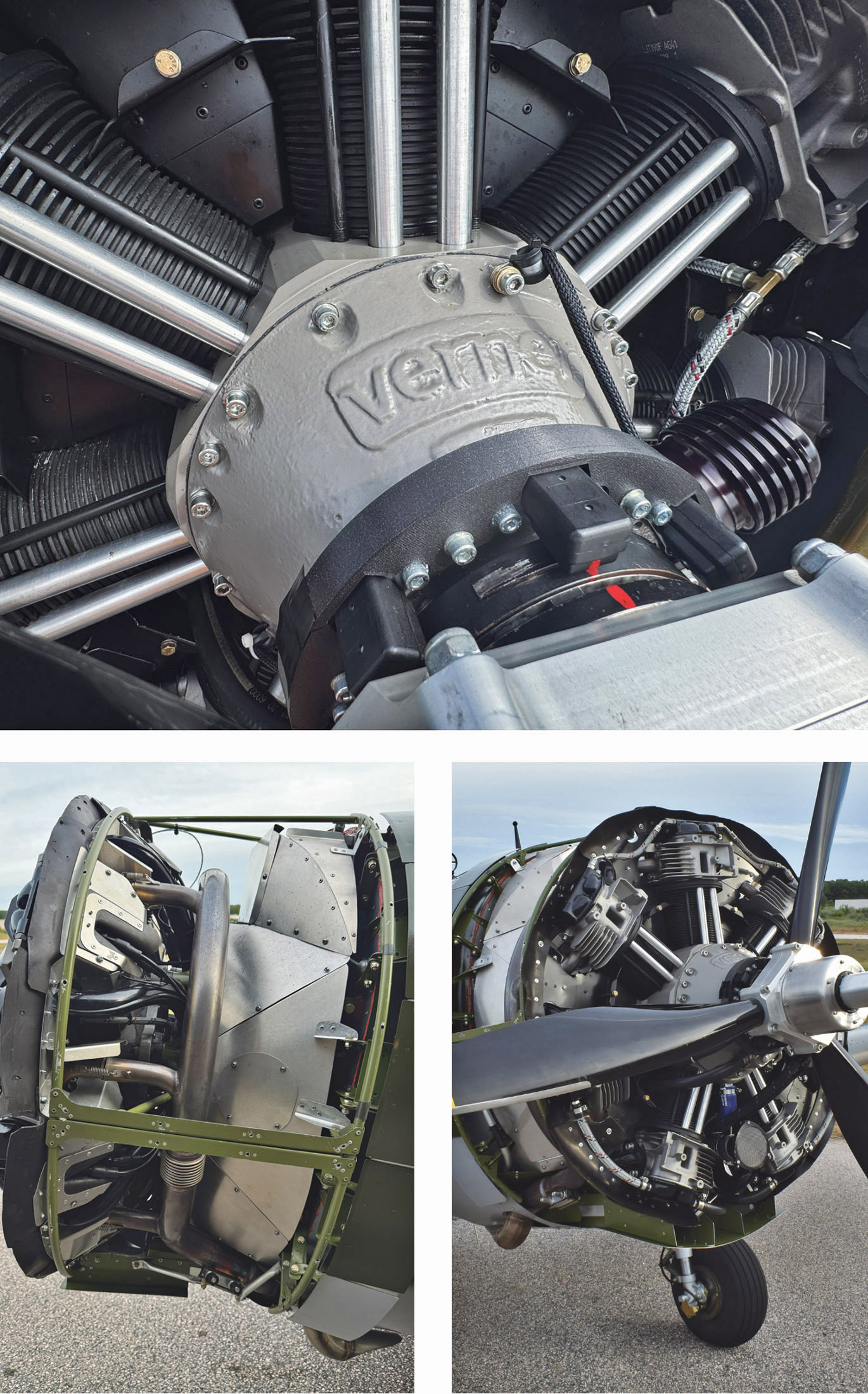

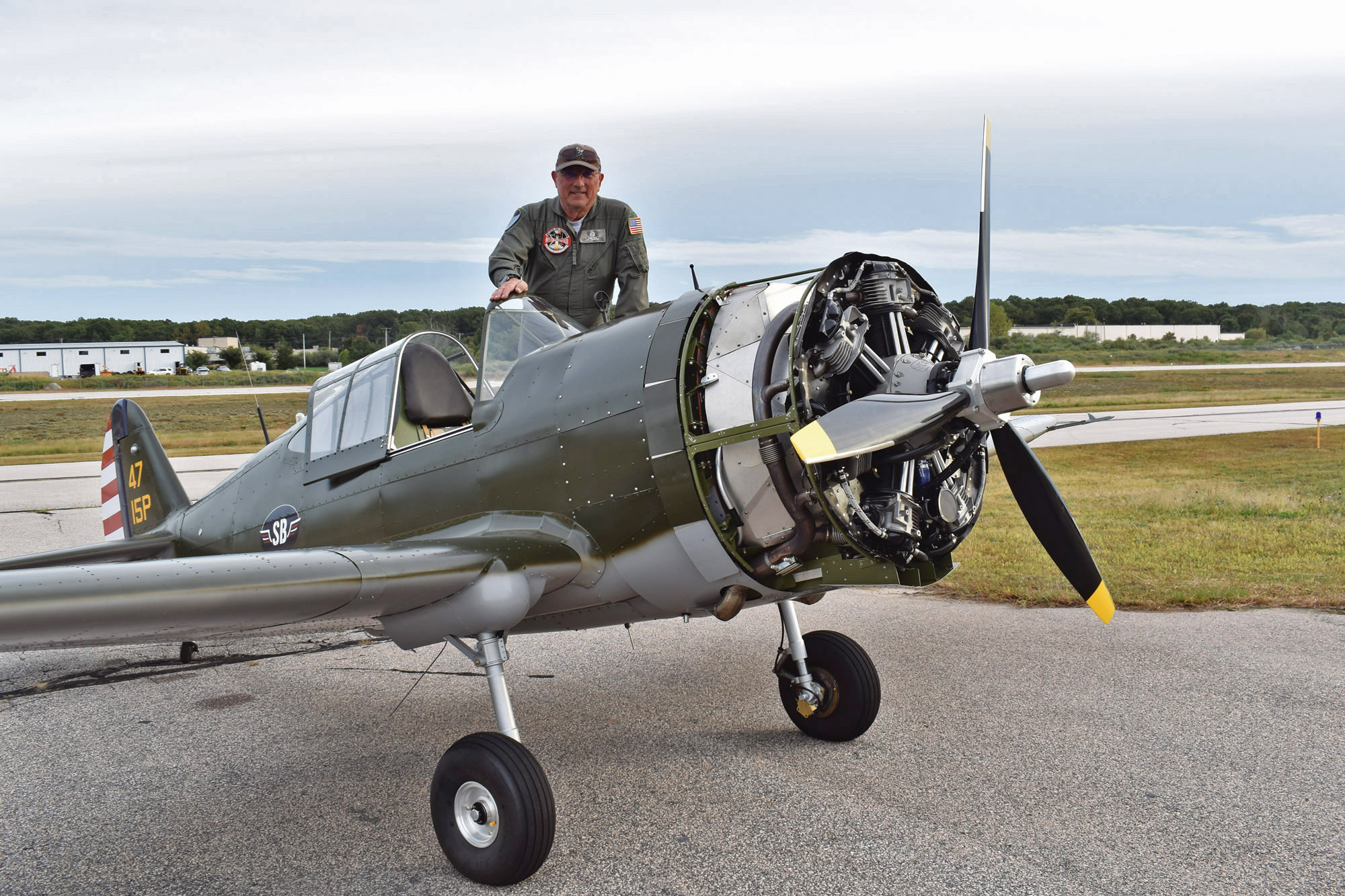

scalebirds p36 hawk 017
Verner’s seven-cylinder radial looks and sounds the part for a warbird replica (top). Note the tidy installation (bottom left and right).
“Oh yeah” said Watrous…“it’s got a few rpm bands where it shakes pretty good!” “Is it hurting anything in those bands, do I need to avoid them?” I asked. “Not really,” he said, so I didn’t bother writing them down. I just found another place to put the throttle if I didn’t like what I felt throughout the flight, and the Verner and I lived happily together.

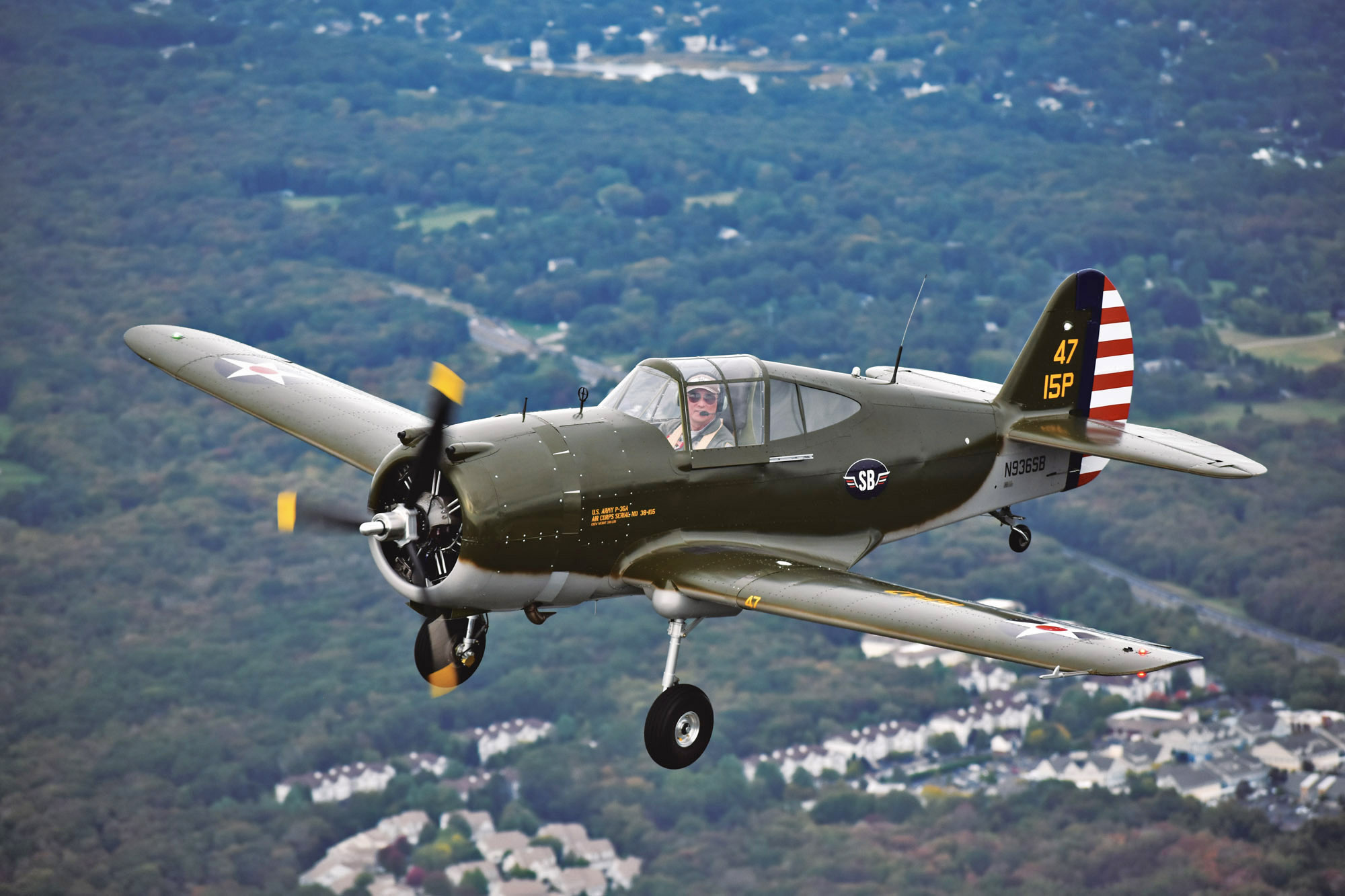

Stick forward, add power and you’re off. I expected maybe a little more drama with the high nose and short airplane but it tracked straight ahead. The tail came up with excellent rudder control. This is not an overpowered airplane, of course, so the acceleration wasn’t blistering, but we eventually reached flying speed (in a few hundred feet) and a slight tug got the mains to break ground.
The first impression was “light.” The controls are low effort in all three axes. Right off the bat, however, take a look at the ball: This airplane wants lots of right rudder in the climb, which is not so unusual. It also wants lots of right rudder in level flight! Watrous later told me that they are planning on shifting the leading edge of the vertical stab off center to trim it out.
Pitch felt about right for an airplane this size—close to naturally stable but still positive. Roll is very sensitive right now, very light and neutrally stable. But it will quickly fall off to the left or right (it is not picky about which way it goes) if you put your head down to write a note. My suggestion after flying it is that as delightfully quick as it is right now in roll, I’d probably tone that down just a little to match the pitch response and make the airplane more harmonious.

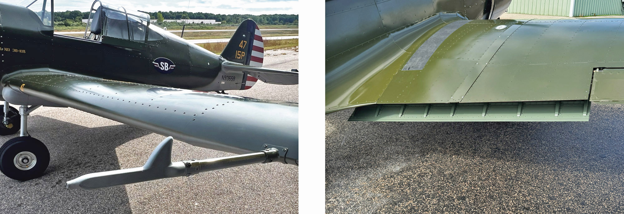

scalebirds p36 hawk 018
Split flaps are uncommon these days but were added to the prototype to improve landing speed and attitude. They are true to the period.

scalebirds p36 hawk 002
The prototype’s fixed landing gear will be replaced with retracts in future versions—the structure was designed with it in mind.

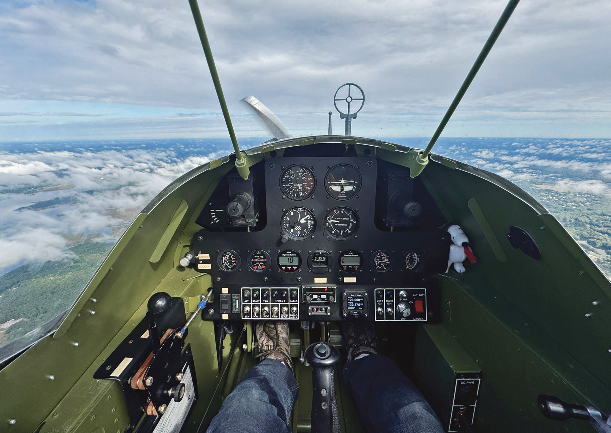

scalebirds p36 hawk 008
Those gun butts in the panel corners are fake but the simple gun sights are useful for lining up a target…er, camera ship!

The Verner engine is definitely a newcomer to the GA world here in the U.S., but so far it has proven to be a fairly reliable engine with a few teething problems having to do with leaded fuel—fly it on mogas and those issues should go away. It has no history of massive failures and that’s a great thing—a little loss of power from a sticky valve is far better than a thrown rod. Or choose the P-40 option they are working on. I kept thinking how this airplane might fly with a Rotax 916 iS out on an extended nose, with that big mouth scoop and a shark’s mouth painted on. You’d certainly attract some attention as you taxied into the local pancake breakfast! Even in the P-36 configuration, the airplane is a good enough replica that many an aficionado could be fooled until you get out and they realize that “hey…that’s smaller than I thought it should be!”
