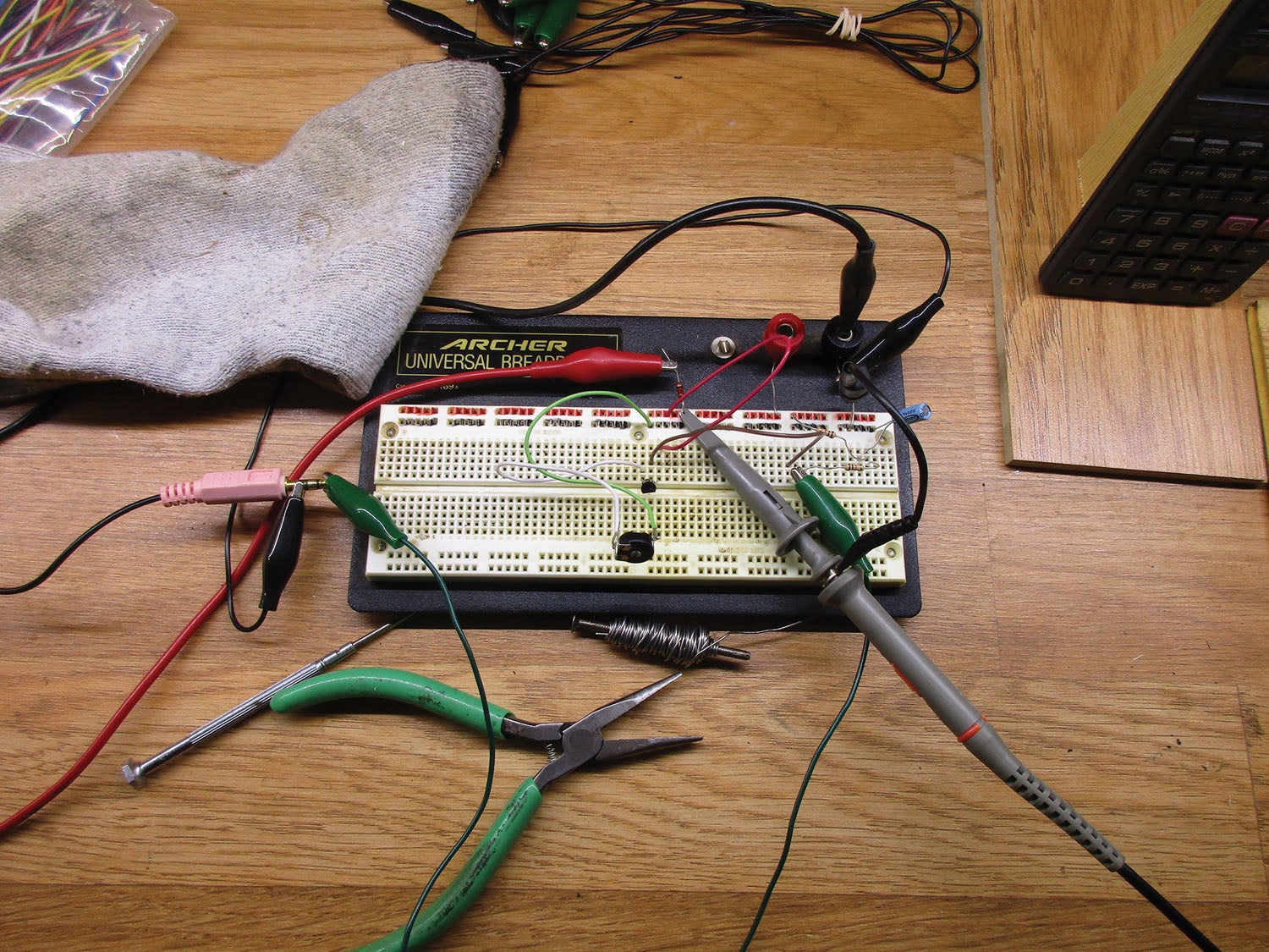

Otto von Bismarck said that if you enjoy sausage and law, you should never watch either of them being made. I will add to that list electronic circuits when first trying to get them to work. We generally call these circuits “breadboards” because back in the vacuum-tube days, these trial circuits were actually soldered together and bolted to kitchen breadboards. The image you get this month shows the breadboard circuit for this project—not that I would recommend this construction for permanent installation.
aerolectrics jacks 01
The project breadboard after 8 hours of optimizing the circuit. The sweat sock is there to wipe my forehead after some serious solder practice. I do not recommend this method of construction for flight.

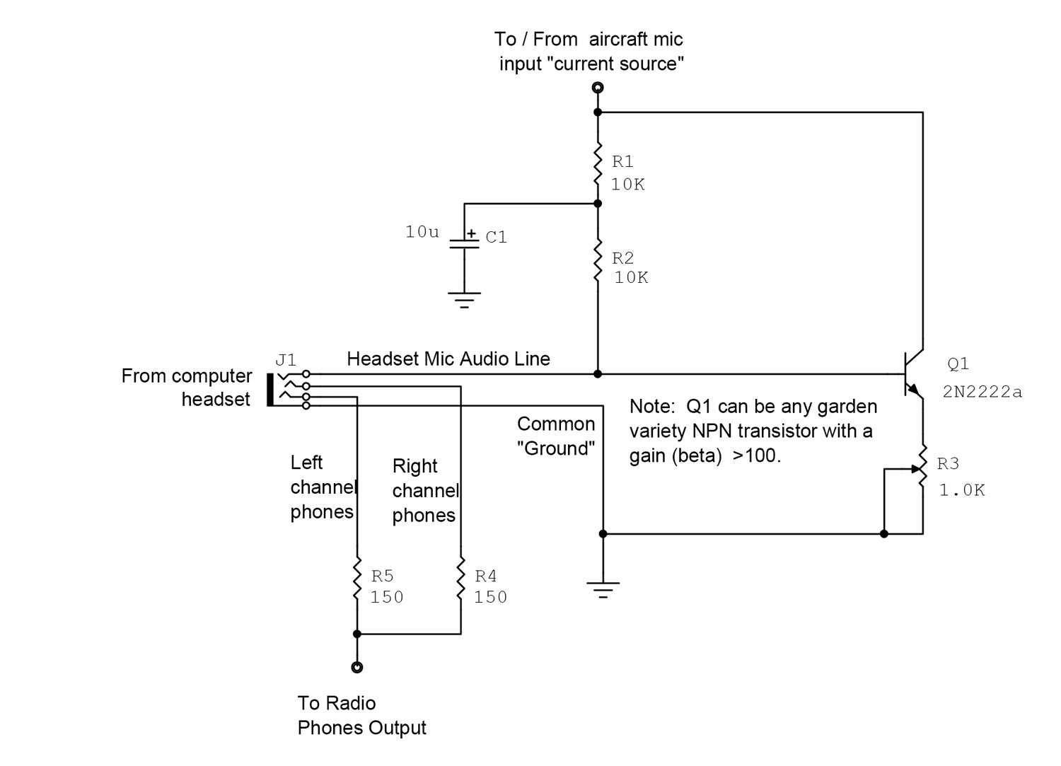

A short time ago, I got an email asking if there was an easy way of converting a computer headset for aircraft use. I asked what “easy” meant, and the answer was how to wire that little computer plug to the big aircraft plugs directly. That just isn’t possible. Let me elaborate.

The circuit that converts computer mic audio to aircraft mic audio.

The circuitry inside the radio consists of a constant current source (either a relatively large-value resistor or a transistor in a current source configuration) that provides somewhere between 5 and 15 milliamperes of direct current from the 12-volt power source. We can use that current source to power both the capacitor microphone and a single-stage transistor amplifier to get the required voltage and current to simulate that carbon microphone. You will see this current called several names: phantom power, mic bias current and several lesser used terms. But the schematic diagram shows how this circuit takes the mic bias current and powers the microphone and transistor simultaneously.

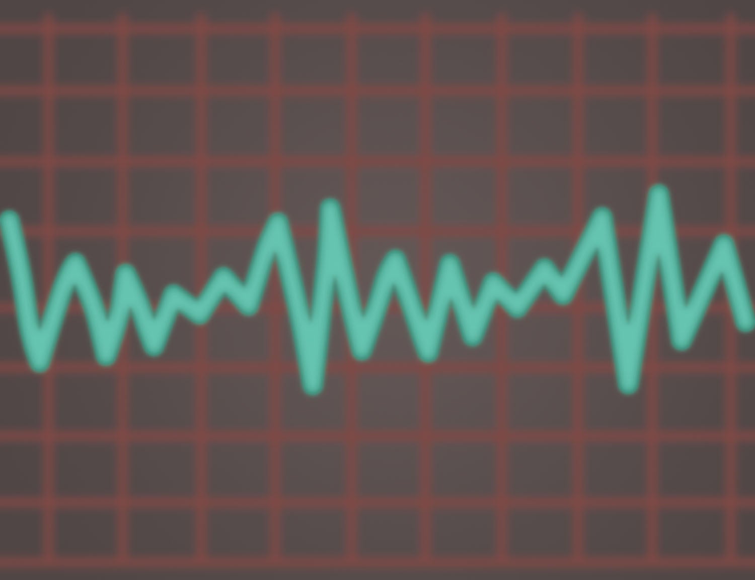

The “o” in “hello” adjusted for aircraft use at 500 millivolts peak to peak.
There is a variable resistor in the emitter circuit of our transistor amplifier. The standard specification for an aircraft microphone is 150 millivolts RMS (which is about 500 millivolts peak to peak). This resistor is adjusted to provide this amount of voltage from your voice when you talk into the microphone. If you don’t have access to a way of measuring this voltage, it is possible to plug a known good microphone into your aircraft radio and use a portable radio with a friend at some distance from the aircraft. Use the known microphone as a test and then plug your modified computer microphone into the radio and adjust the variable resistor for the same “loudness” from the remote receiver. You may, if you like, adjust that resistor for the correct volume, take it out, measure it and put a fixed resistor in its place.

Back up a few paragraphs where I said the earphones that Bell used were 300-ohm devices. That’s fine, but a telephone only has one earpiece. We need both ears covered and that gives us two choices: We can run two earphones in series to give us 600 ohms or in parallel to give us 150 ohms. Originally we ran them in series because that puts less of a load on the radio. What we found in the mid-1960s (and specifically at that little unpleasantness in Vietnam) is that when one earphone broke a wire, it opened the circuit and the whole headphone went dead. If we ran them in parallel, then one earphone would be off, but the other one would still work. We then redesigned our radios to drive four sets of earphones at 150 ohms, which works out to 38 ohms, four sets of 150 ohms in parallel.

That’s all well and good, but the computer earphones are 32 ohms—each. Even worse, the stereo computer ’phones have 32 ohms each side, and if we drive them in parallel, that’s 16 ohms. Four of those at the same time on the radio means we have to drive a 4-ohm load. Most radios won’t do that. But there are a couple of solutions.
One: We pick which ear we want to listen to and only use one of the earphones.
Two: We use a series resistor to up the impedance of the headphones. The downside to this is that it cuts the volume of the headset down. Most of today’s radios have enough reserve volume to blast standard aircraft headphones into the threshold of pain. That means if somebody is using a normal aircraft headphone and we adjust the radio volume up, it will be way too loud in their aircraft headphones. And then we can play around with resistor values to cut their headphones down to our modified computer headphone level. Kind of like rubbing your tummy and patting your head at the same time.
