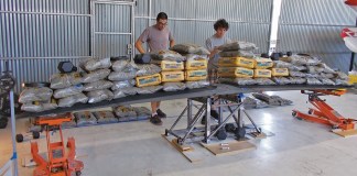

Static load test of left wing using whiffletree setup and 55-gallon drums filled with water.
Iscold bought several servos and wrote a program to run them continuously at 50% of maximum load for three months, 24 hours per day, seven days a week. During several visits to Catto Propellers to help Iscold on the project, I could see the little servo “pumping iron” whenever passing through the side office. “After 2000 hours of continuous operation, it showed a little free play, nothing more than that. Well, 2000 hours is not a bad TBO time!” says Iscold.
