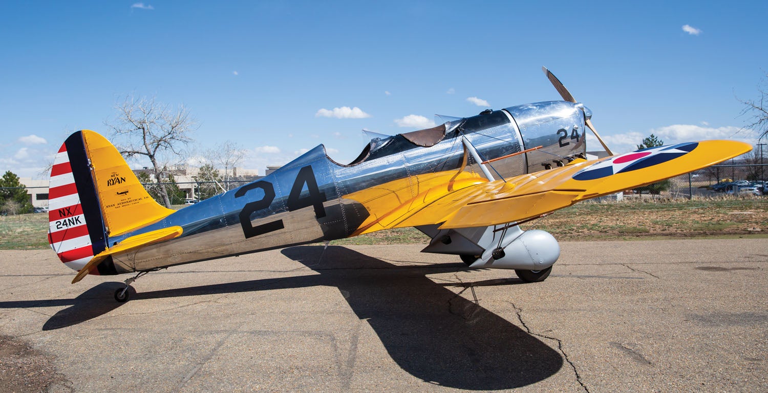

Is it a replica or the real thing? The ST-L (shown here) looks almost identical to a vintage Ryan ST.
