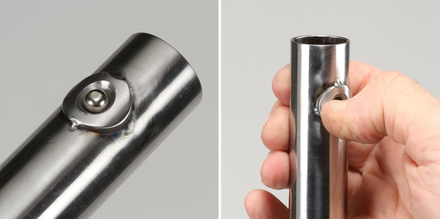

Photo 6 install button
(Left) Installing the spring button is as simple as lining up the button with the hole and inserting it into the stick. (Center) Note the double bend at the end of the spring. It eliminates exposure to the sharp end and prevents button overtravel. (Right) Red arrows painted where the stick and sleeve align provide visual confirmation that the spring button is properly engaged.

Which brings us to the copilot’s control stick on Mark’s RV-6. Unlike the pilot-side stick, which is non-detachable, the copilot’s stick slides into a coupling sleeve at the base of the control mechanism. How to fix the stick to the coupling is up to the builder. Some bolt it together, others use a cotter or a cross pin with a ring grip. Mark wanted a solution that, above all, would be safe and reliable, and, if possible, provide quick release with no loose parts that might get dropped under the floorboard or misplaced.
What we came up with is simple and easy to install: a spring-loaded “button pin” or “spring button.” Spring buttons have been around for decades to engage telescoping mechanisms. Most people are familiar with typical carry-on roller-bags with telescoping handles, which usually have spring buttons made from stamped steel, or the ubiquitous Razor kick scooter, which has solid brass or steel buttons to engage the handlebars. It turns out that scooter handlebars are the same diameter (0.875 inch) as the Van’s control stick, so we repurposed a spring button from a Razor and made it the key component of the quick-release system for the copilot stick.
