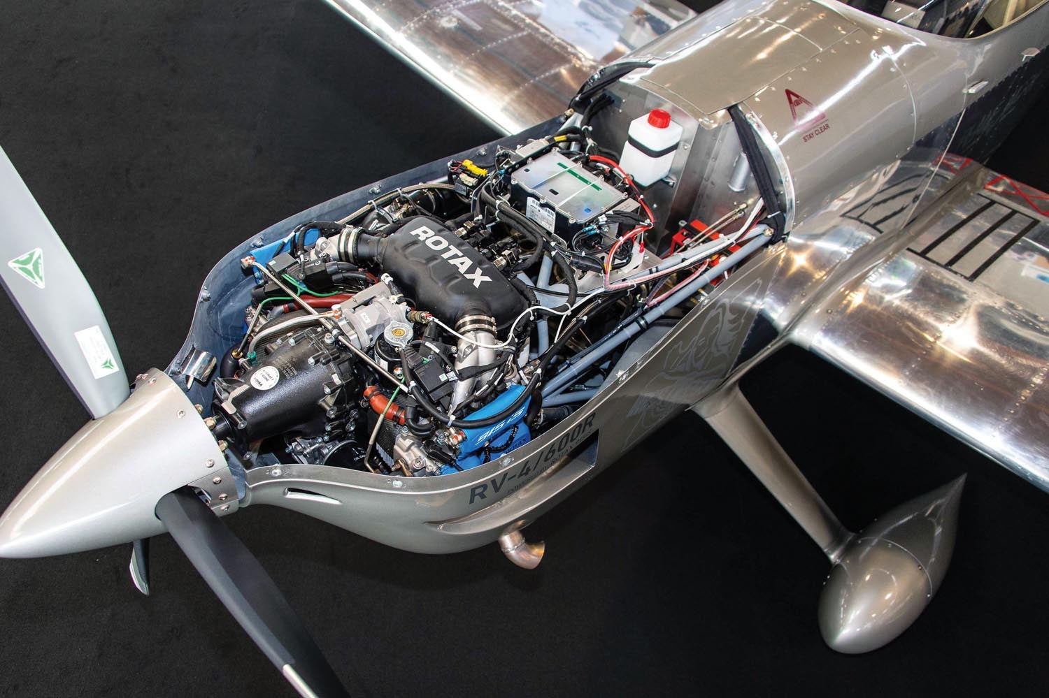

Rotax has managed a commendably compact engine package, but even so, fitting a turbocharger, intercooler, oil cooler, computer boxes, gear reduction drive, wiring harnesses, fluid lines, cooling ducts and…oh, yeah…a four-cylinder engine inside the firewall profile of an RV-4 was a tricky job. The photos show just how carefully every item had to be considered.

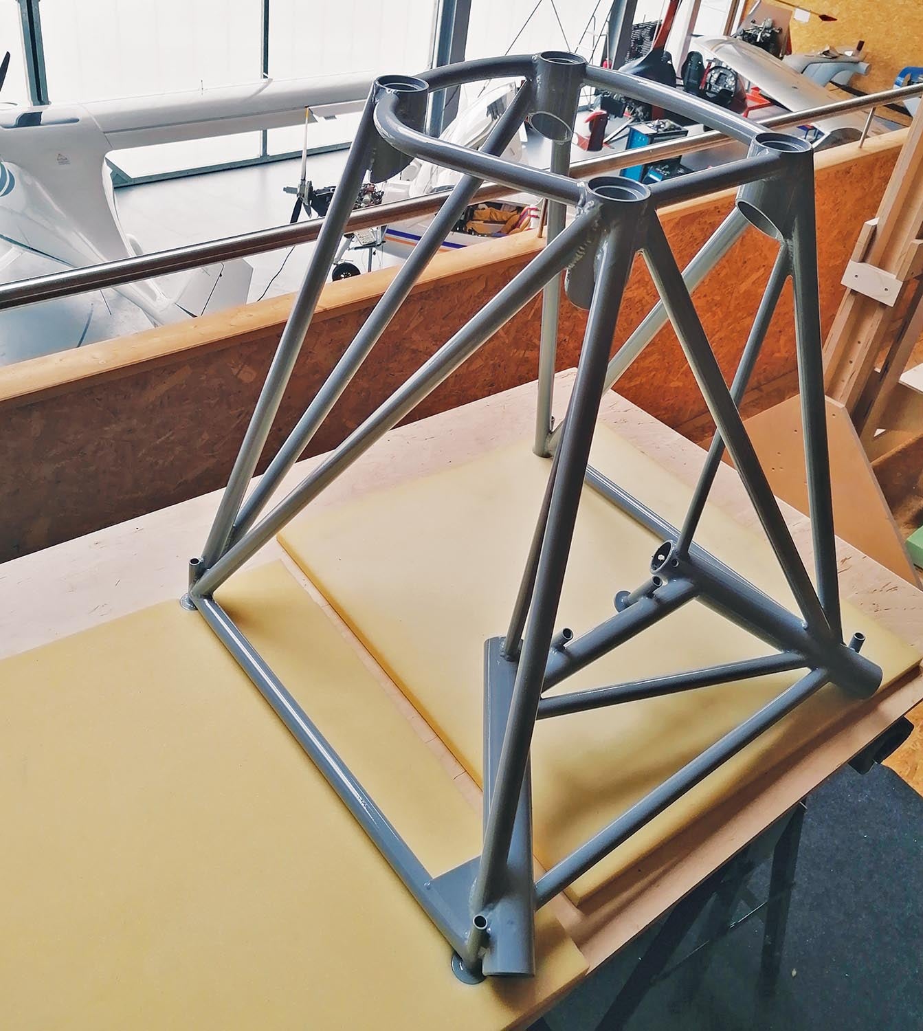

Because the installed weight of the Rotax 915 iS is about 90 pounds less than a typical O-320 installation, an extended engine mount was required.
With the longer mount built and the engine installed, a new cowl was fabricated. That’s one sentence, but it represents many hours of work, making a positive plug, then making solid negative molds to lay up the glass cloth and epoxy. No less than ten air inlets were needed to cool the coolant radiator, oil cooler, turbocharger, turbo intercooler, cylinder bases and electronic “stuff.”
In the cockpit things are much simpler. A single lever controls power. Engine management—fuel flow, ignition timing, etc.—is controlled by the Rotax EMU. Optimum rpm is determined by a box from RS Flight Systems. This unit, increasingly seen in European Rotax-powered airplanes, uses several data points delivered by the ECU to determine the desired rpm and controls the standard hydraulic governor with an electric servo.
