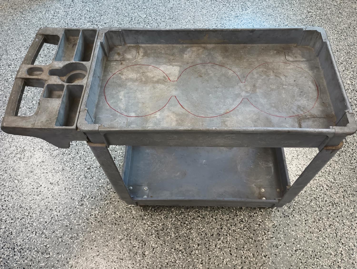

  1. Using a cardboard template, cut out three holes of slightly more than 9 inches in diameter, with the edge of each hole touching its neighboring hole. This will be a template for cutting the upper shelf of the service cart. Once the template is ready to go, line up the three oxygen bottles and make sure the template will lower down over the three bottles. It may be necessary to increase the size of the holes slightly to achieve a loose fit. The bottles do not need to be tight in the holes and the holes need to be large enough that the top shelf can be easily removed from the cart once the bottles are in it, so that the bottles can be removed when it comes time to refill them.
  2. Place the template over the top shelf of the service cart. Make sure the three holes all fit within the shelf. Using a felt marker, draw the outline of the holes onto the shelf. Remove the template.
  3. Using a drill bit with a large diameter (preferably at least ½ inch), drill some starter holes inside the drawn lines.
  4. Using a saber saw and starting in the drilled holes, cut along the marked lines on the shelf. When complete, you should have three large, 9+ inch holes in a row. Test fit the shelf over the three lined-up bottles to make sure it slides easily over them.
  5. Place the bottles on the lower shelf of the service cart and place the top shelf over the bottles, lining up the pins in the shelf with the sockets in the cart’s vertical arms. If desired, the mounting screws can be put back in to secure the top shelf to the arms, but these will need to be removed whenever it is necessary to fill the source bottles. I have found that as long as you don’t pull up on the handle of the service cart, the screws are not necessary.

Service cart with cutting lines transferred from the cardboard template.

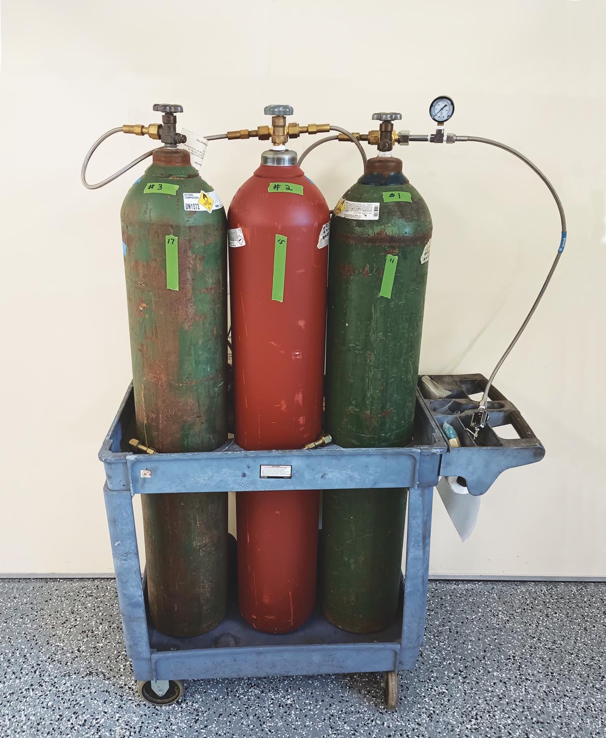

Each bottle already has a valve on it, so all that is needed is a way to connect each bottle to a common line. This can be done with two T-fittings and two pigtails. Each pigtail consists of a short length of flexible hose with a CGA-540 fitting on each end.
Install a T-fitting on bottle #1 (the low- pressure bottle) and #2. Then use one pigtail to connect bottle #1 and #2 and the other pigtail to connect bottle #2 and #3. This leaves one side of the T-fitting open on bottle #1, to which the transfill adapter can be connected.
A transfill adapter is used to connect the CGA-540 fitting on the oxygen source tank to the fitting on the aircraft bottle. If you don’t already have one, they can be found on eBay for about $55, including a pressure gauge. If you are using aircraft bottles with a medical oxygen fitting, they will typically be a CGA-870, so the transfill adapter would adapt from CGA-540 on one end to CGA-870 on the other. Ensure you know what kind of fitting is on your aircraft bottle. If it is not a medical oxygen fitting, it will likely be something other than CGA-870.
Regardless of what kind of fittings and hoses are used, ensure they are rated for something in excess of 2000 psi, which is the typical full pressure for oxygen bottles.
oxygen bottle cart 03
Bottles placed in the service cart, with T-fittings and pigtails installed.The numbers on the vertical masking tape strips show the current bottle pressures.

To use the system, connect the aircraft bottle to the open end of the transfill adapter and open the aircraft bottle valve, then slowly open the valve on source bottle #1, allowing oxygen to flow slowly into the aircraft bottle. Don’t open the valve very far; fast-flowing oxygen will heat up the aircraft bottle, and a hot bottle will not hold as much oxygen as a cold bottle will. Once the pressure has equalized, close the valve on bottle #1 and slowly open the valve on bottle #2. Repeat the process again for bottle #3. Close all valves, disconnect the aircraft bottle and the filling process is complete, with the aircraft bottle now at the same pressure as high-pressure bottle #3.
