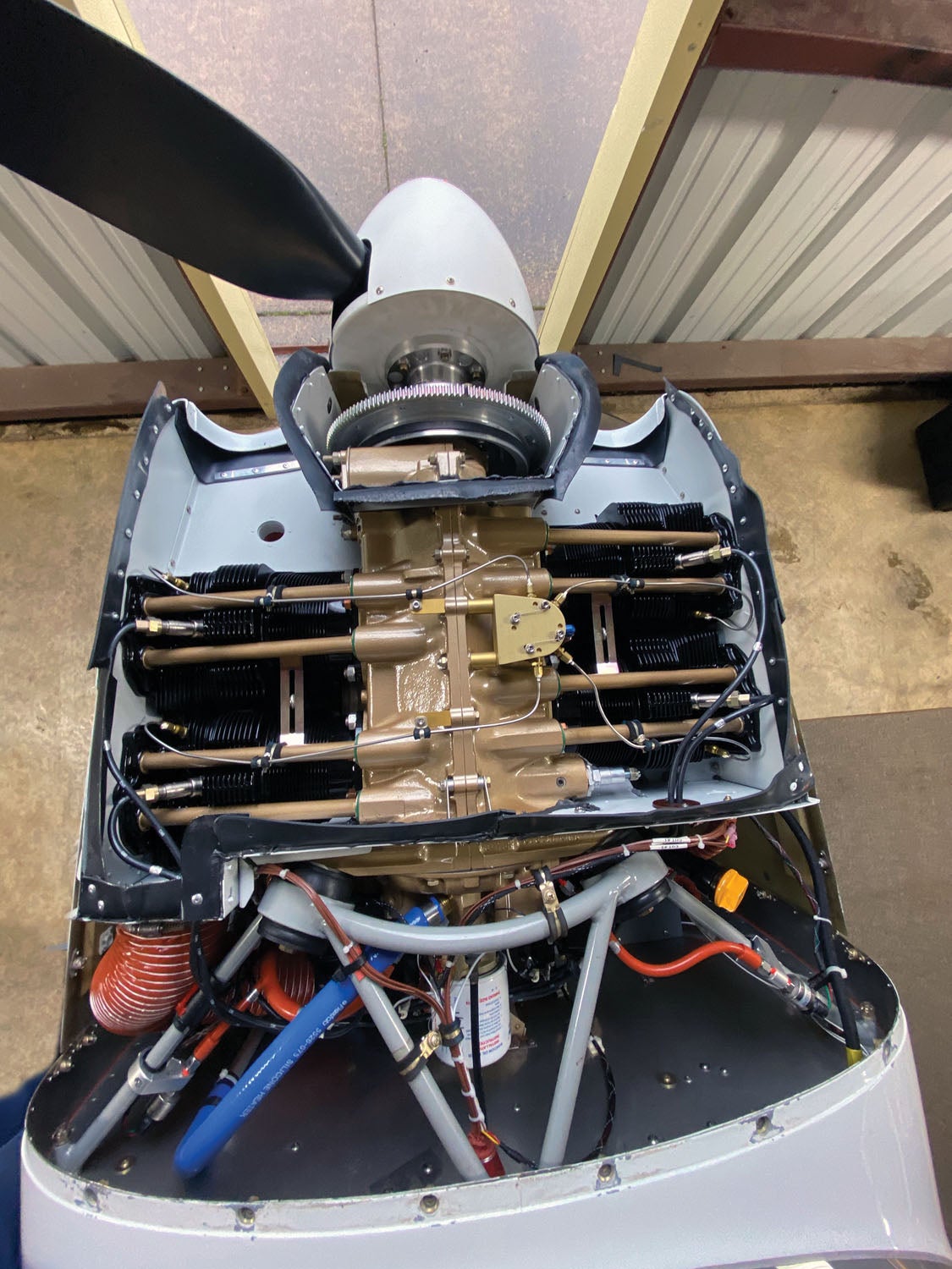

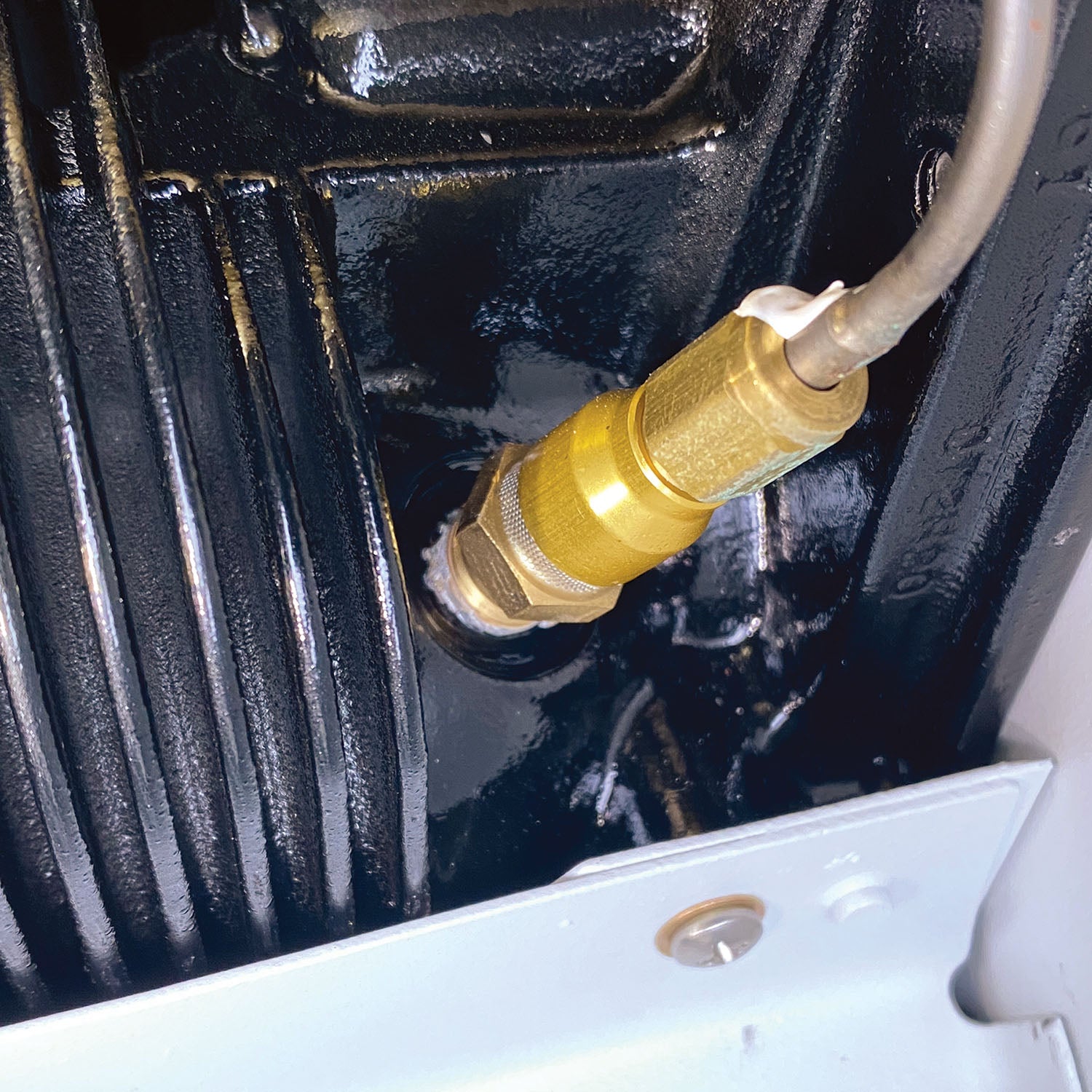

After the first flight was complete, I uncowled the engine and spent much time looking it over. At this stage, you’re on the hunt for leaks and parts touching that shouldn’t. But it’s also a good time to check all the safety-wired items and look closely at your wiring and plumbing. It’s amazing how many items can shift after the first flight, sometimes in ways that you don’t expect. I was surprised to see the alternator field wire slink its way toward a metal part, though it didn’t complete the trip.

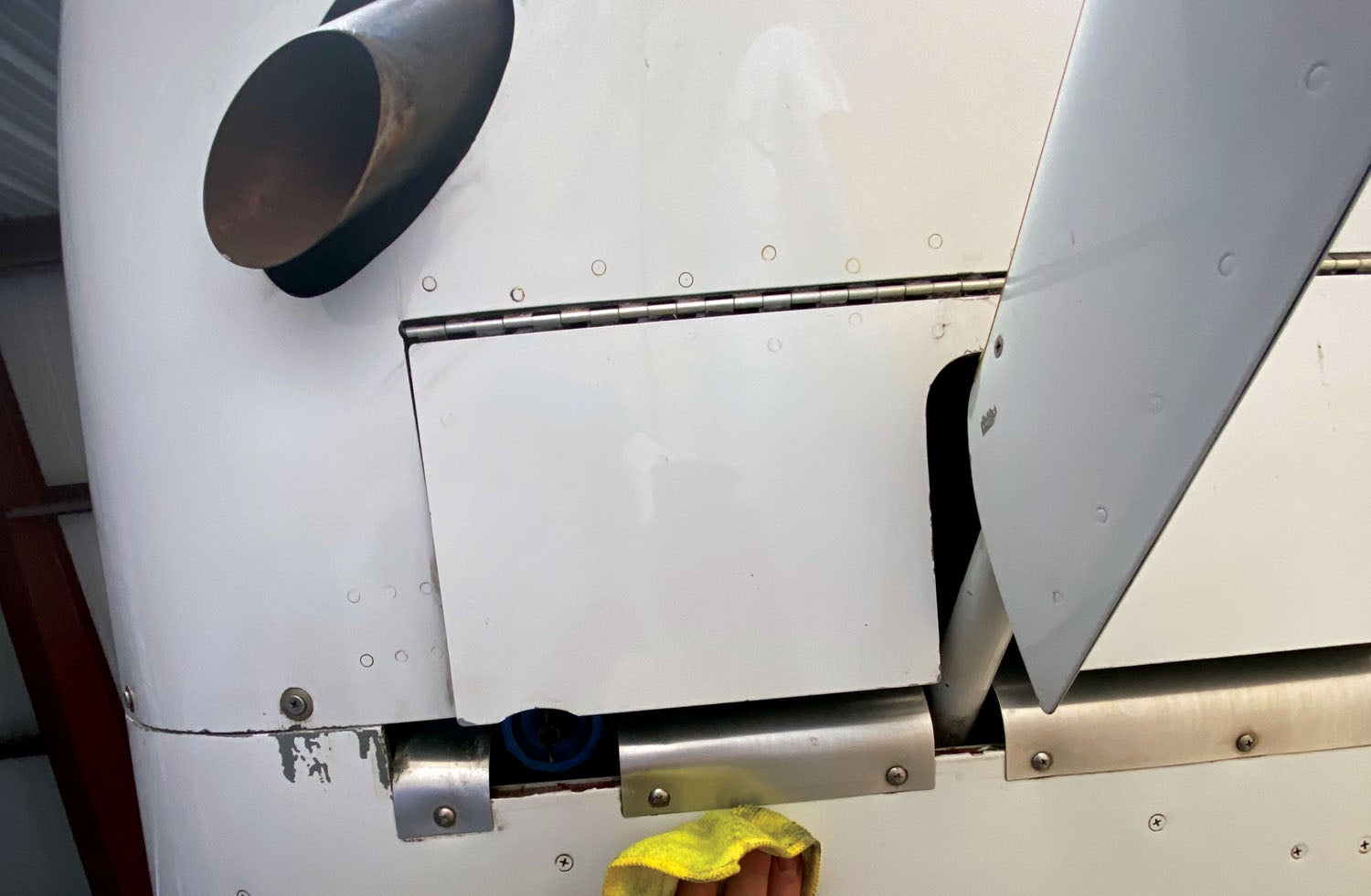

The early GlaStar cowl flap is large (20 x 7 inches) but only adjustable on the ground. Choosing which setting for engine break-in was one of the choices to be made.
As for the cowl flap, I took a WAG and set it to the mid position. For clarity, the standard GlaStar cowl flap is ground adjustable, roughly 20 inches wide and 7 inches deep, opening a total of 18° from the flat portion of the bottom cowling. But “closed” isn’t really, since there’s still a sizable cutout for the nose-gear strut and the firewall flange is cut back from the trailing edge of the flap, leaving a gap for air to flow through.
I felt these settings were right to manage temps. The prop pitch, which I anticipated would be slightly too fine based on my experience with this prop on the O-320, would keep the engine from loading up as heavily, and that’s good to keep temps down. The cowl-flap setting was more open than I typically used on the O-320 during the winter months. But I also had 30 more horses, and that brings heat. So I took my best guess and looked forward to seeing the data later.
So how’d we do? Looking at the data logged by the Dynon EMS-D10, I could see that the first flight’s max CHT was 385°, briefly, with oil temps peaking at 191°. Better than I expected, but the temps in the descent fell off too rapidly. On the third flight, feeling like the engine could handle more prop, I reset to pitch #5, a coarser setting. If I encountered too-high temps in this configuration, I’d cut the flight short and land. Outside-air temps were around 40° F on the ground, so I knew I had some margin to play with. The third flight’s configuration put up more expected numbers: a peak of 394° for CHT in the climb and 208° for the oil.

Break in? Sometime after the third flight, as far as I can tell. After that first flight with more pitch, CHTs and oil temp came down and stayed there. Oil consumed? Barely half a quart. I see variations in CHT in the data over the next few flights, but most of that was me fine-tuning the flexible baffling and filling in a few minor gaps in the fixed baffling to help bring the cylinders together. But the “big drop” was there. After 6 hours, I tested the airplane with the cowl flap completely closed, which resulted in slightly higher climb CHTs—and a movement of the hottest one from Cylinder 3 to 2—but I’ve been able to keep each under 400° at all times during our cooler months. This was actually better than I’d hoped for considering the extra power I’d added with the swap. Tweaks to the baffling continue to better group the CHTs. Never done!

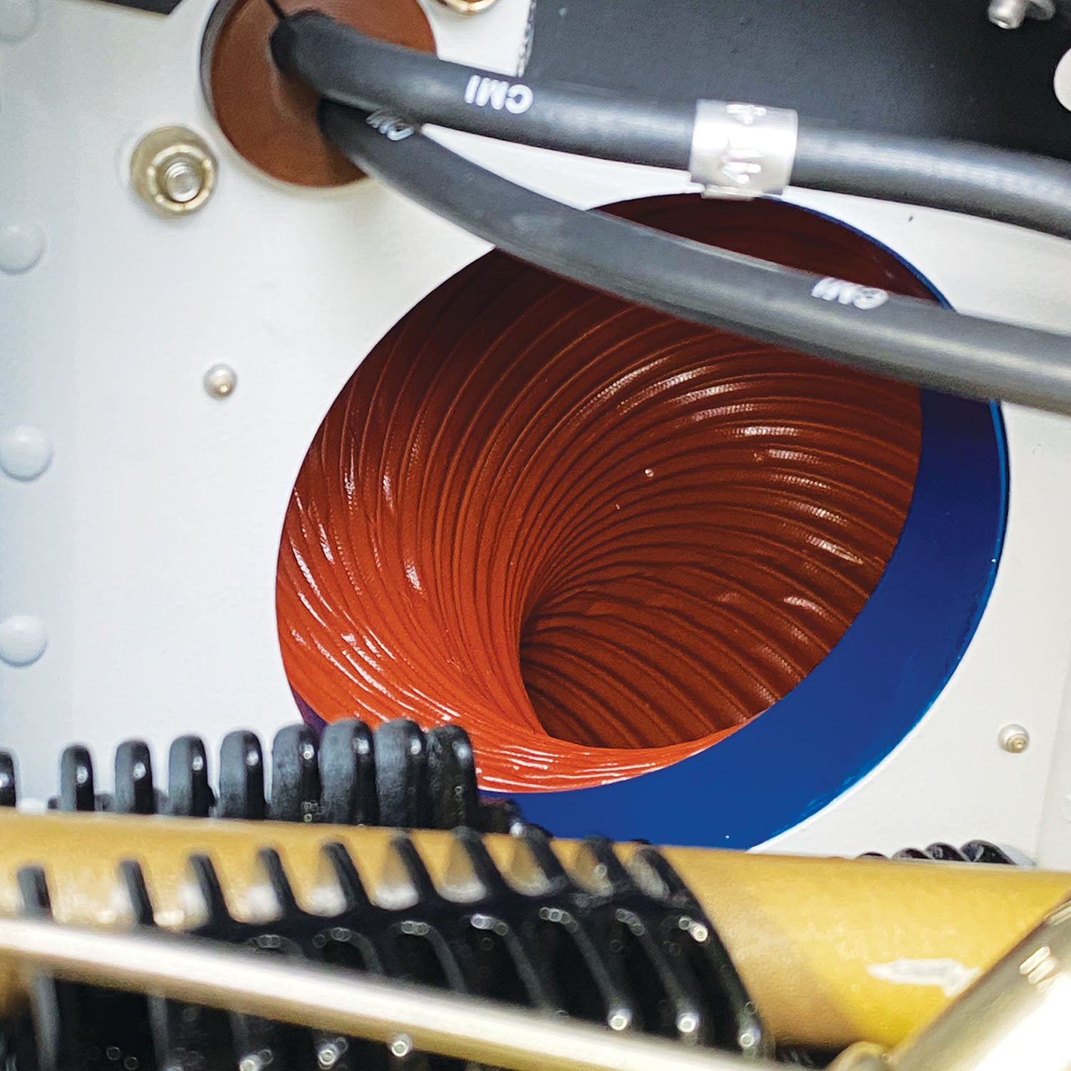

glastar titan io 340 flight 10
A 4-inch duct feeds the oil cooler.
Oil temps have not been an issue.
