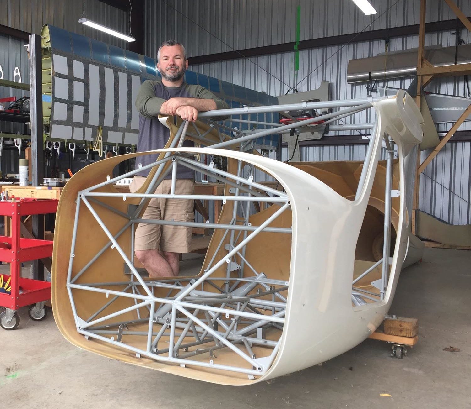

Omar Filipovic with his GlaStar project.I was happily plugging along at a good pace on my GlaStar project when life happened. What I had projected to be a two- or three-year build came to a crawl with a few spurts of activity and then finally stopped altogether. For seven years.

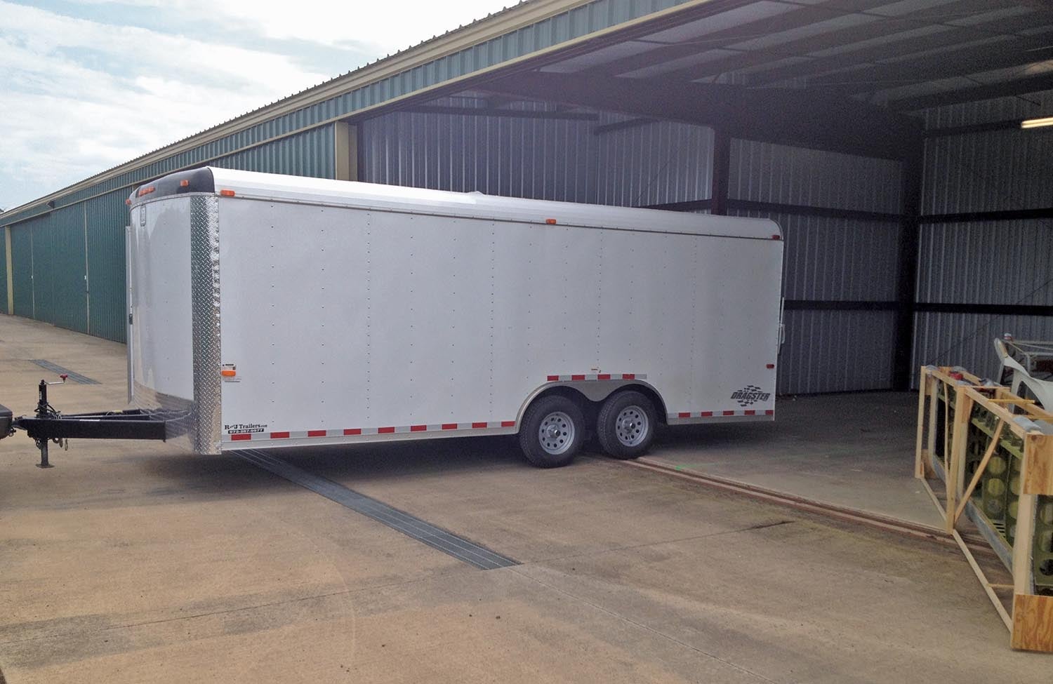

Getting the GlaStar parts to the hangar was the job of this 20-foot trailer. Careful packing meant all the airplane and shop components got to the hangar with little to no damage.

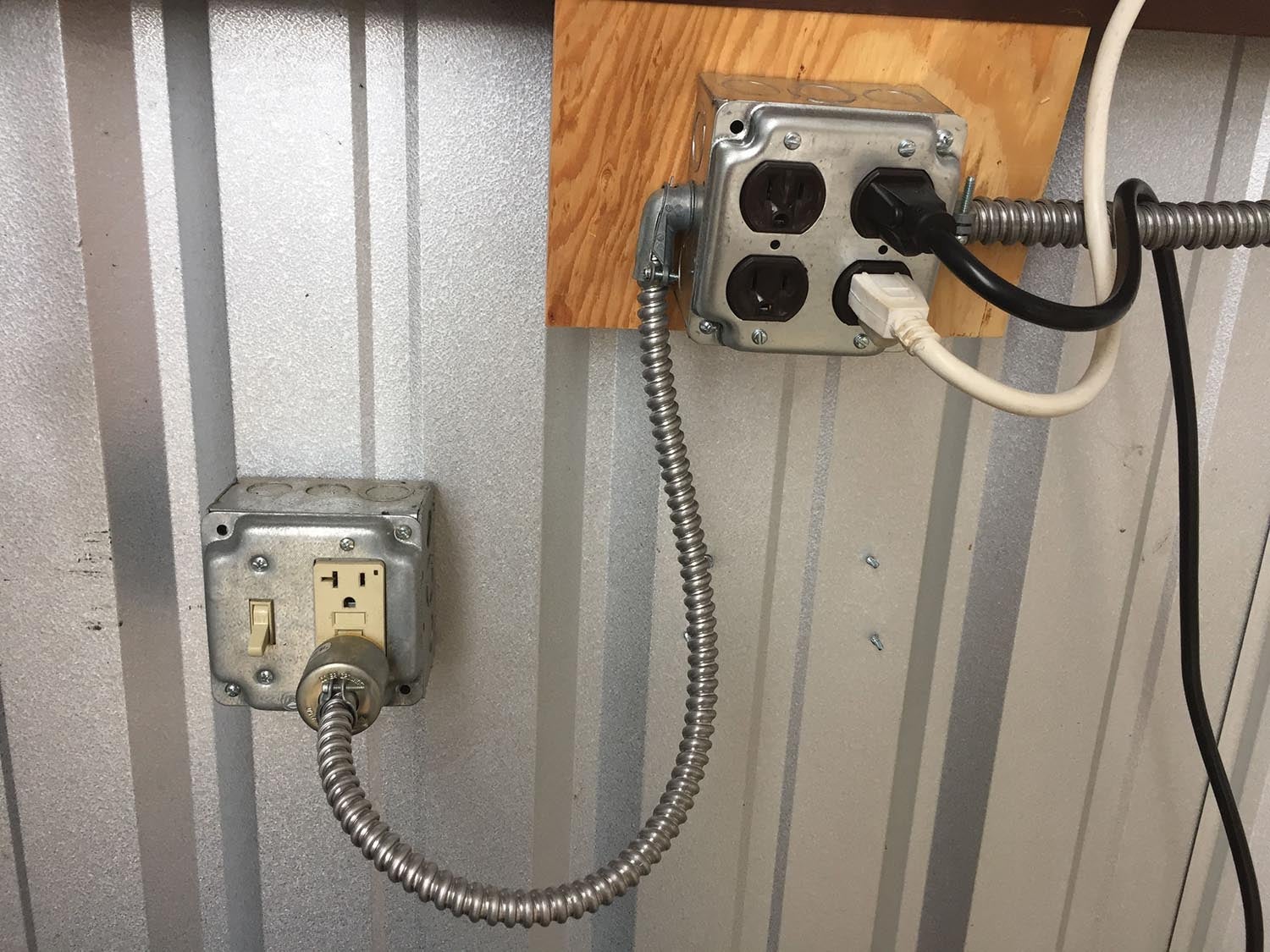

The outlet on the left is the only source of power in the hangar. I made a heavy-duty extension cable with three two-gang electrical boxes mounted to a piece of plywood to distribute power closer to where it’s needed. The plywood is attached to the hangar frame with screws, but C-clamps work just as well.
Rental hangars aren’t always easy to come by, so we take what we can get, and what I got was a nice T-hangar at a very nice little private airport, but it has only one electrical outlet and one fluorescent light. Hardly adequate for a workshop. Amazon to the rescue—LED shop lights have become inexpensive. and with their low current draw they were the perfect choice for my new, but dimly-lit space. Because it’s a rental hangar, I didn’t want to install permanent wiring for more outlets, but I don’t like walking over numerous extension cords either, so I assembled a plug-in set of extra outlets wired with 12 AWG cable to reduce the current drop as much as possible.

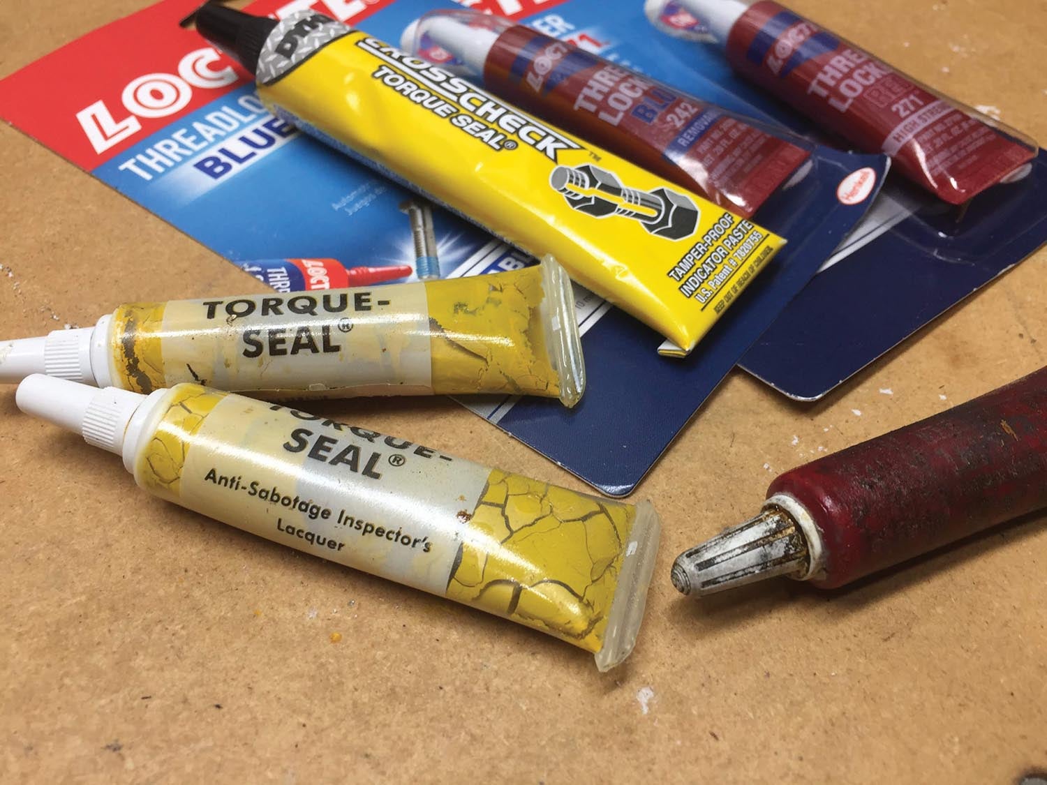

Most of the consumables have to be replaced. This torque seal and thread locker are past their prime.

It’s normal to expect some damage when moving a project this big, but I was very careful, and the only damage was to a flap cove rib—an easy fix. This kind of “hangar rash” damage can be expected even if the project is just sitting around for a few years. I’ve seen other idle projects with piles of stuff on top of airplane parts, and that kind of treatment is surely going to lead to various squawks once the builder gets back to work. A bit of advice for anyone with a project on hold: keep it clean and dust-free. The GlaStar has a steel-tube cage in the fuselage, and I’ve found some surface corrosion on a couple of tubes where dust had collected and remained undisturbed over the years. Fortunately, that too is an easy fix, but it was entirely avoidable with a wipe of a rag.
