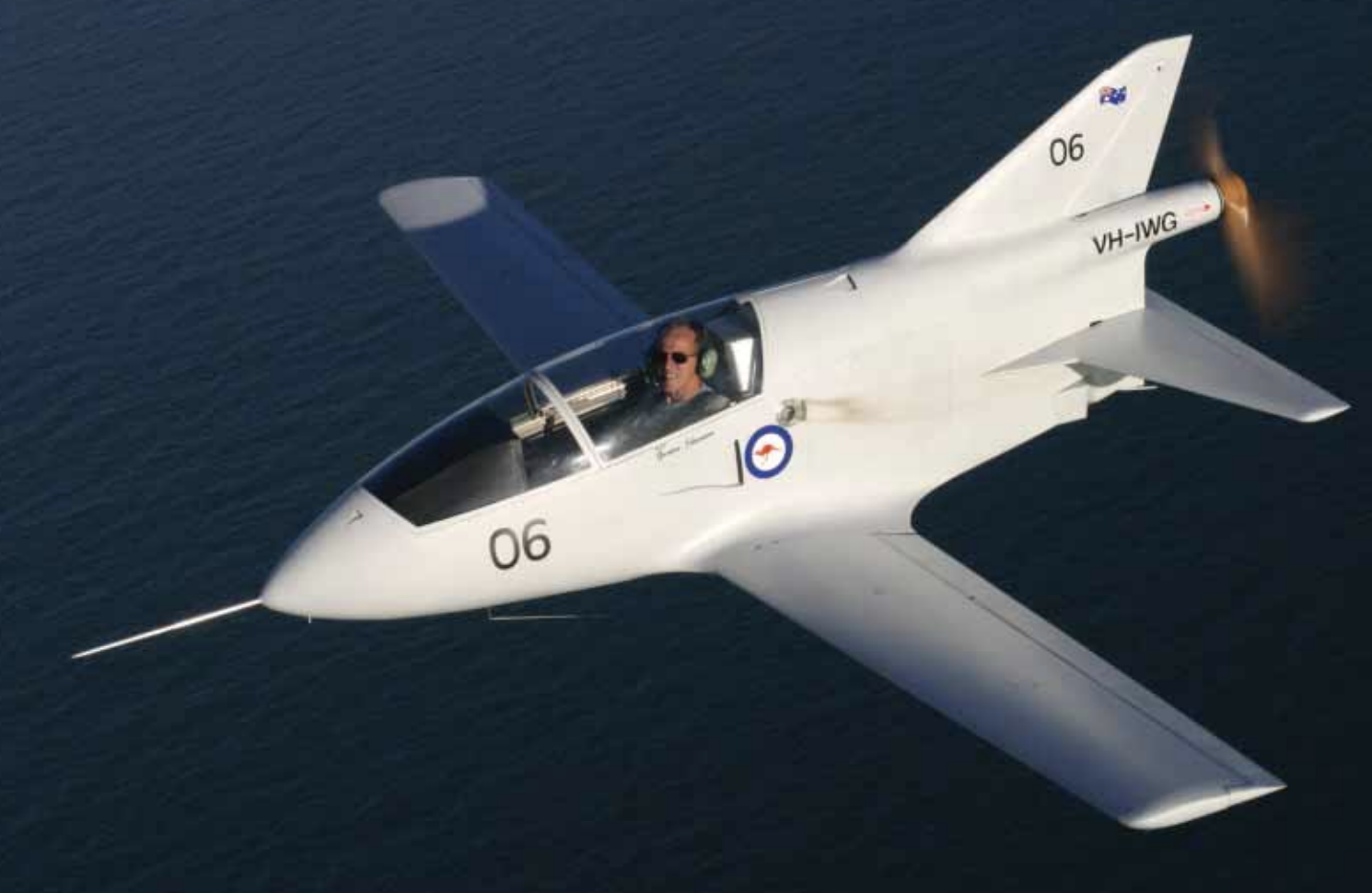

And just look at it. The thing’s tiny, all cockpit, with no wing to speak of, minuscule control surfaces and a highly tuned, turbocharged automotive engine buried in its rear fuselage. A real hot-ship. It would have to be challenging to fly… Wouldn’t it?
Now, let’s ponder a minute. Yes, it’s small, but it’s also light, weighing little more than a Cassutt. Its engine also provides 100 horsepower. The wings are similarly Cassutt size—as are the control surfaces, and its speed range is comparable. But the Bede has tricycle gear, so you can see where you’re going. Why shouldn’t it be at least as straightforward to fly?

Apart from its tubular spars and bonded ribs, the BD-5’s construction is conventional all-aluminum stressed-skin semi-monocoque, fastened with aviation-quality Avex pulled rivets—mostly countersunk—making the exterior very clean. The swept, all-flying horizontal stabilizer and its anti-servo tab are operated by cables, as is the tiny, highly swept rudder with its relatively big aerodynamic/mass balance horn. The ailerons are torque-tube operated to facilitate wing removal (a half-hour job). All control circuits are commendably friction-free, the small ailerons have neat balance horns, and the control surface gaps are tight.
Less conventional components include the manually retractable landing gear, operated by that T-handle between your knees. This pops up or down in less than half a second, automatically locking with its over-center geometry. Nowadays side sticks are common, but they were cutting edge in the 1970s. The pantograph canopy mechanism is light and neat. The fuel gauges are simple, foolproof and still unique: a cluster of six Plexiglas rods of differing lengths protrude diagonally from the wing’s upper surface down into each tank. When the lower ends are wetted by fuel, they appear dark; when uncovered, light.
The BD-5’s most revolutionary components are its pusher propeller and associated drive system. These enable the engine to be mid-mounted for low drag and optimum mass distribution, while the chisel-tailed fuselage gives the sexily curved, multi-laminated wood prop a comparatively smooth airstream. The drive system incorporates toothed drums turning a rubber belt to minimize harmonics, a long shaft, lots of bearings and a freewheel clutch—it is slightly odd to be able to spin the propeller freely in one direction but with resistance the other way.
