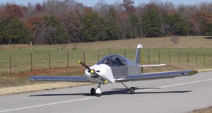

Ray Hill approached his Wag-A-Bond project in the traditional way—buy material, build a few parts, then buy more material and keep building. He always kept an eye out for useful items and paid cash, a little at a time. At a time when too many pilots feel a new airplane is financially out of reach, Hill reports that his running total came to about $22,000, “…not counting sandpaper and used hardware.”
This Wag-A-Bond took about 10 years total, working in a back room at the airport between customer jobs. The fuselage is scratch-built and gas-welded. Hill elected to go with classic wood wings, so wing construction started with a rib jig and the traditional “rib a day” routine, and eventually progressed to a spar layout on a tabletop. Airplane construction was rudely interrupted once, when a tornado completely destroyed Hill’s home. Thankfully, the Wag-A-Bond, the RV-6, and his A&P business were all at the Prattville, Alabama airport.

Very popular aircraft like the Van’s series created a huge demand for used 320 and 360 series Lycomings. The Wag-A-Bond avoids all that, as the engine of choice is a Lycoming O-235 straight off the front of a Cessna 152. Hill’s O-235 came from a 1979 model. He rebuilt it himself, of course. Wheels and brakes are from a C-172, again readily available in the used market, and easily overhauled.
The widespread acceptance of glass panels has made overhauled old-school instruments quite affordable. Hill went so far as to install a vacuum pump and gyro horizon, always handy on a bad day. The transponder is a used King KT76. The Garmin 196 GPS was a gift from a friend, although Hill had to buy a panel dock to mount it. Bits like circuit breakers came from Hill’s used parts collection. His favorite find was the tailwheel assembly. It turned up in the SERFI (Southeast Regional Fly-in) flea market with a $10 price tag. It’s not full swivel, but it is simple and lightweight, two things Hill likes very much.

How much? Well, study the pictures and you’ll see that Hill elected to pass on extras like leather, carpets, headliners, and interior fabric. There is no autopilot, no wheelpants, and no dual anything except basic controls. Hill wanted a true Sport Pilot legal airplane (1320 pounds gross weight), and he got it; N476PW weighed in at 848 pounds. Full fuel (26 gallons, 156 pounds, 3+ hours) allows a reasonable 316 pounds for pilot and passenger. Alternately, the airplane can be loaded with a pair of 200-pound pilots and 12 gallons of gas, enough for a pleasant one-hour evening flight with plenty of reserve. Remember, this is a Traveler; a Wag-A-Bond Classic can be even lighter. It’s also worth noting that Dick Wagner actually designed the airplane with a gross weight of 1450 pounds. Although placarded at 1320, misjudging passenger weight is not going to break the airplane.
