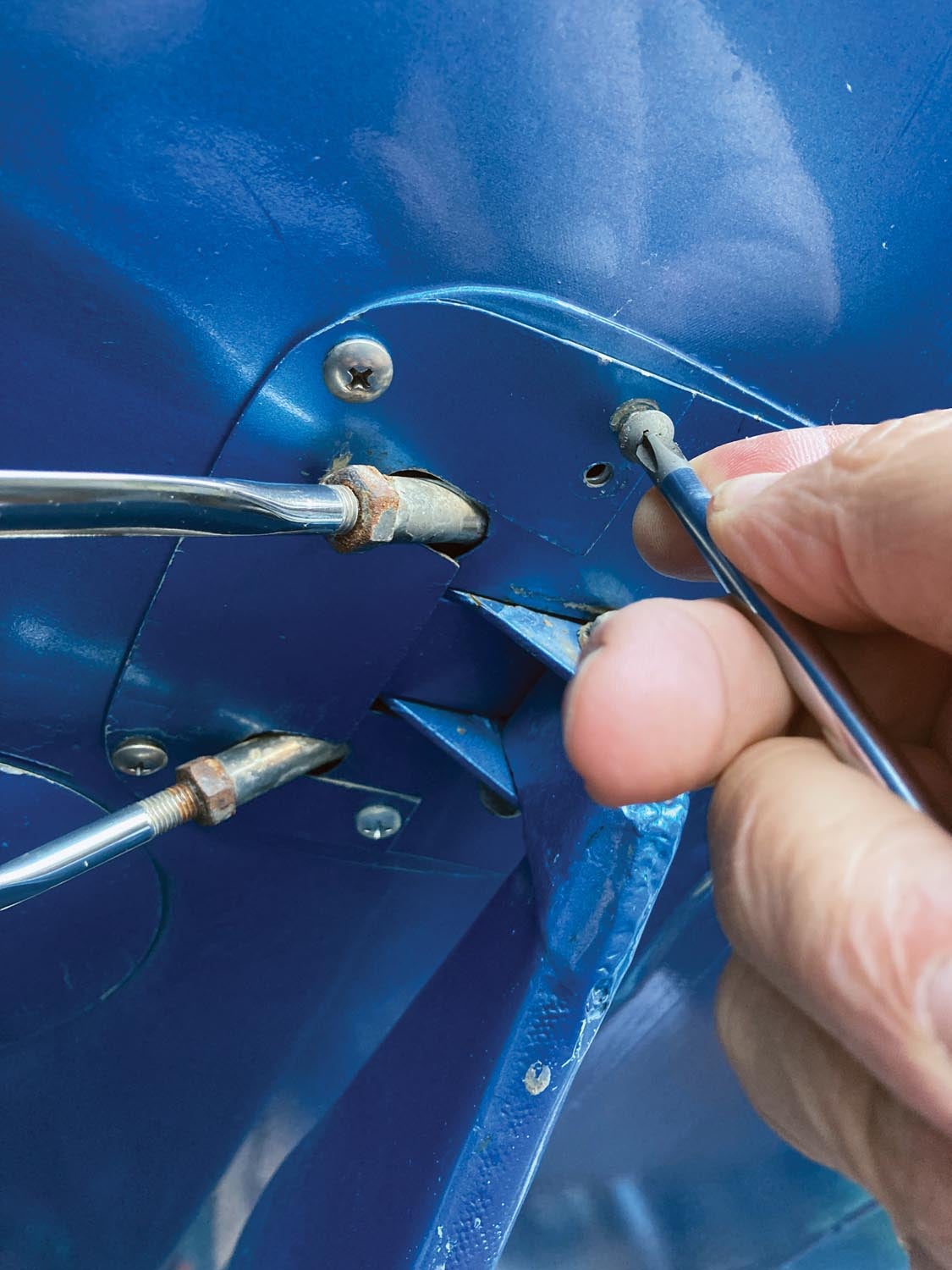

Rear cockpit.
It’s condition inspection time again for the ol’ box kite, hence my grumbling mood. It’s like this every year. I curse the zillion little screws, some #8s, some #10s, a few graduated to #12s or, to heck with it, lag bolts as the wood they screw into yawns open with each turn of the Phillips.
RCZipper 1
There are three different size screws here. They didn’t start out that way 40 years ago.
Yes, mine is an old-school, rag-and-tube flying contraption so everything is handmade—and I think by a guy who was in a hurry. So opening it and putting it back together again is not an efficient or overly happy time. I’d rather be flying and it gets you wondering why it all has to be so difficult.

What has been amazing is how much easier the annual chore is going simply by leaving a few hundred PK screws in place. We all understand how not handling a boxful of screws can save time, but internalizing just how much of your life has been spent opening and closing the same old areas truly drives the concept home. In fact, I’ve been so struck by the difference I’ve noodled on the situation in the back of the hangar during the recliner chair visits. I’ve concluded my condition inspection issues are typically threefold: accessibility, oil mess and heat affectation.
