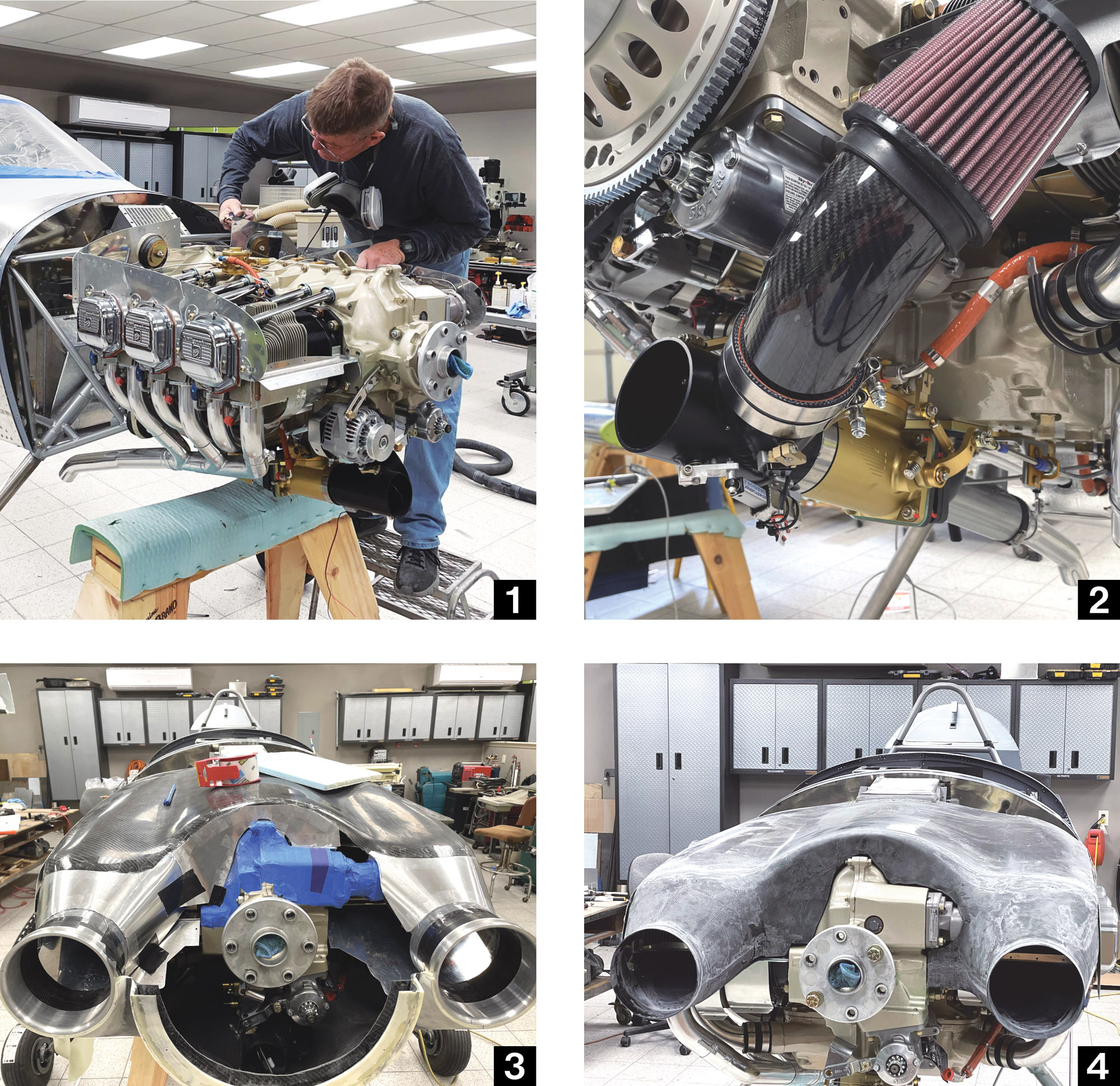

1 Darryl rebuilt his Lycoming AEIO-540 using a core obtained from the Royal Jordanian Air Force. 2 Alternate air induction feeding the Airflow Performance fuel injection system. 3 Custom plenum fabrication utilizing roof flashing from Home Depot. 4 The completed carbon fiber plenum.

The thing that sets the F1 Rocket apart from the similar appearing RV tandem aircraft is the big kahuna in the power barn, usually a 260-hp Lycoming IO-540. Darryl’s engine has a story. He bought a 2800-hour run-out AEIO-540 removed from a Royal Jordanian Air Force Slingsby Firefly trainer. He then completely disassembled the engine and sent it out to DivCo and Aircraft Specialties in Tulsa, Oklahoma. After receiving numerous boxes of yellow-tagged parts back from Tulsa, Darryl took them and several new parts (Superior cylinders and 9:1 pistons and a new Airflow Performance fuel injection system) to Watson Aero in Louisville, Georgia, where he and IA James Watson reassembled everything into a finished engine.
Darryl’s F1 engine compartment contains several innovations. His Airflow Performance fuel injection system sports two “turbo nozzles” that pressurize the injector bodies, preventing siphoning (and uneven fuel delivery) caused by low pressure in the injector bodies. Darryl also chose to install an SDS Electronic Ignition when he found out that it utilized regular NGK auto plugs and Volvo coil packs, both of which can be sourced in a pinch at any local Autozone. Darryl also decided he did not like the use of push/pull cables for engine accessories, so he designed a control system for the ram air intake control and the oil cooler door utilizing electronic linear actuators from Actuonix. He also used those same linear actuators to control cabin heat and rudder trim.

Darryl spent over two months redesigning and constructing the engine cowling and plenum. The two-blade Whirl Wind prop he selected for the engine had an interference problem with the cowling so he extended the prop forward by 1 inch. While in the neighborhood, Darryl increased the cooling air inlet diameters from 5.5 inches to 6 inches, requiring all new cooling coupling rings and a rework of the entire front of the engine cowl. He then set to work on the plenum, which did not fit to his liking. Using the old plenum as a form, Darryl fabricated an entirely new plenum out of carbon fiber, which he worked, reworked and reworked some more until it came out perfect.
Rather than hang the oil cooler off the rear baffling of the engine (many report baffle cracks caused by the weight of the oil cooler and the movement of the engine), Darryl decided to mount the oil cooler on the upper center of the firewall and fabricate carbon fiber ducts to direct cooling air from the plenum to the cooler. In the process, he also had to design and fabricate the brackets necessary to hold the oil cooler core and the cooling ducts, and to regulate air flow to the oil cooler.
