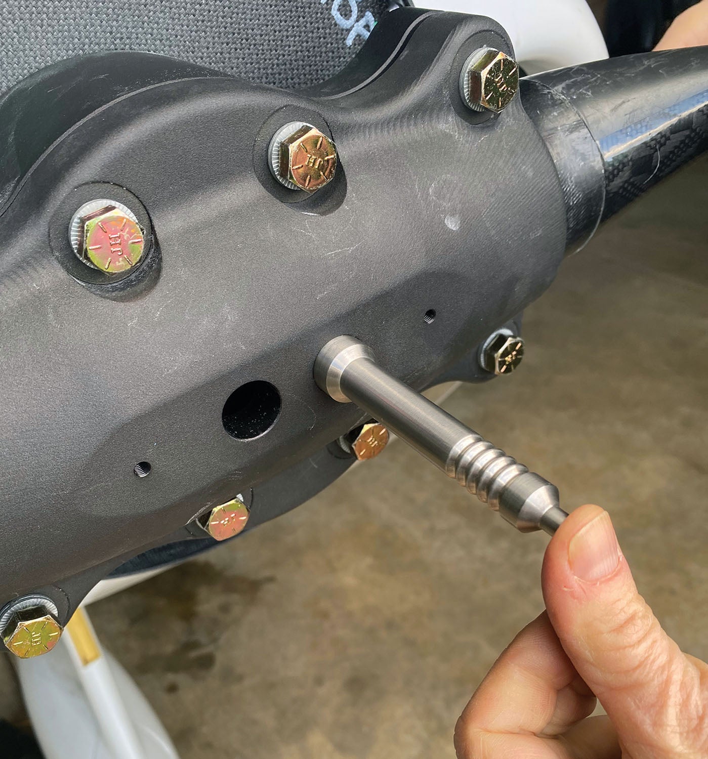

The pitch-setting pin for the Sensenich ground-adjustable prop makes pitch changes relatively simple and repeatable. Each pin has two settings.
Anyway, with the new spacer in place and testing begun, it felt like the engine wasn’t up to this prop—or that the 74-inch-diameter Sensenich was “too much prop” for this airplane. Sensenich’s Don Rowell felt otherwise and suggested that before considering shortening this prop—it can be trimmed an inch each blade, for a 72-inch diameter, but it’s a permanent “fix”—that I continue to test at the fine end of the pitch range. And that’s the beauty of this prop: It comes with three setting pins with two pitch adjustments each, numbered 2 to 7, with 2 being the finest pitch. Generally, Sensenich recommends starting with 4 and working from there.

Rowell asked me to look carefully at two key indicators, static rpm and max rpm at full power and low altitude. My target was 2200 to 2250 rpm static and redline rpm (2700) at full power. Lower results suggest too much pitch; higher and the prop is too fine. One thing I discovered in retrospect is that the A-D prop already on the airplane was some combination of too small and too fine—with a 68-inch diameter and 51-inch pitch. Typical static rpm was 2300 or a little more and it would easily exceed redline at full throttle and 1500 feet msl.
On the first flights with the Sensenich at pitch #4, static rpm was a meager 2080 and the airplane would barely pull 2500 rpm at full throttle and 1500 feet. Given how far off I was, I elected to jump a notch and try pitch #2, the finest, and got a 100-rpm increase in static and was able to just touch 2700 rpm at max power, low level. The prop did produce better climb rates and a shorter takeoff roll, but at that stage it did not appear to be any faster in cruise. Truthfully, the numbers were a bit scattered from flight to flight, and I didn’t feel like I had enough data to support publishing a conclusion.
