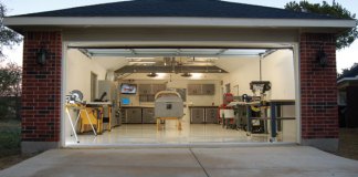

OK, so we’ve got that 100-watt solar panel firmly bolted to the hangar roof. Let’s take the other pieces that we have to have and would like to have in the order of wiring them together.
If you recall, I said that wiring from the solar panel should be mechanically separated from the sharp edges of the metal hangar. While I showed how to use a cable clamp secured by a wood screw into the edge of the plywood solar panel mount on the roof edge, that technique wasn’t available to me as I passed the cable through the vertical hangar walls. Nor was it available to me on the small 15-watt aircraft battery charger I installed on the front edge of the hangar. I had to rely on plastic tubing to protect the wires.
