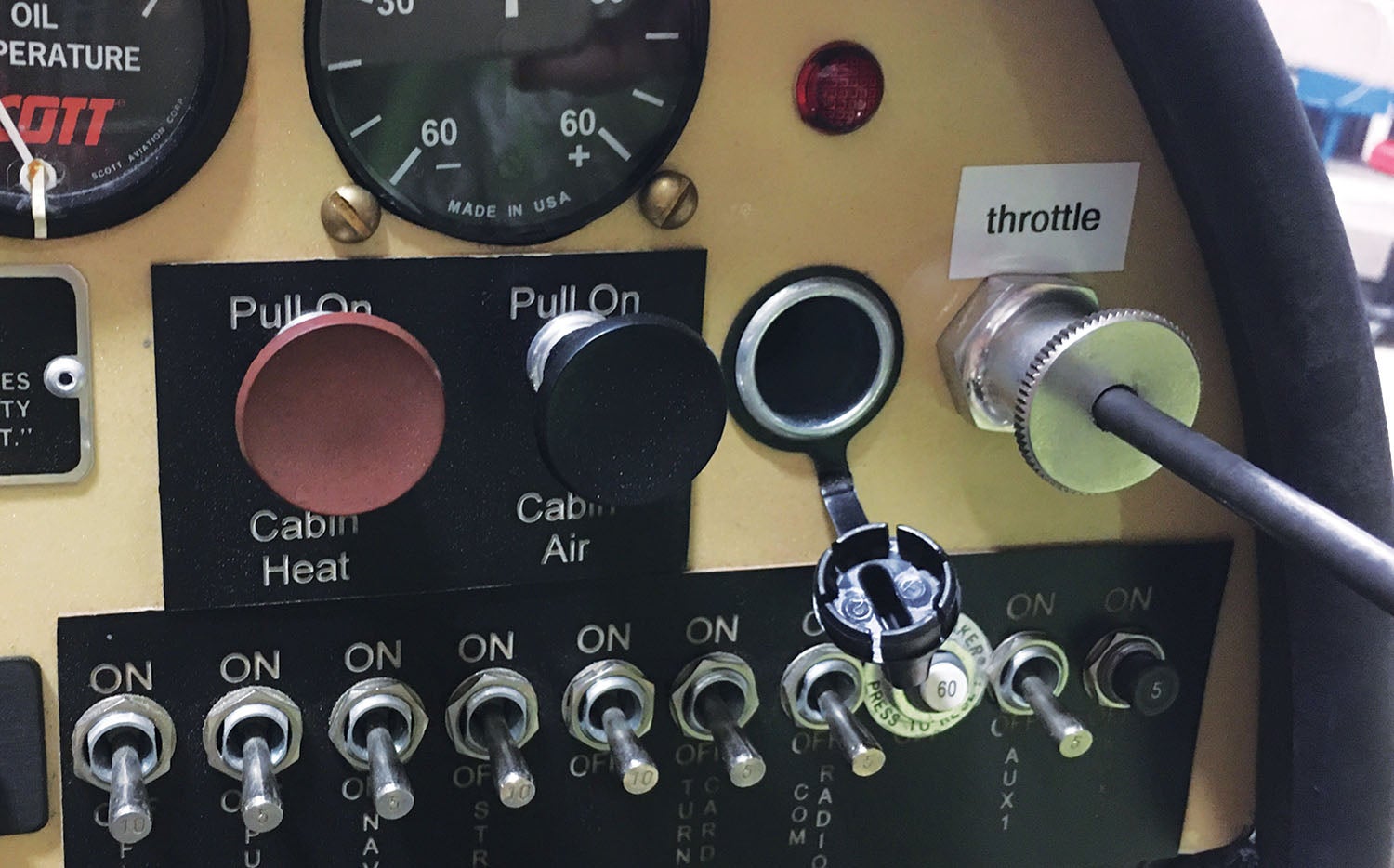

There is always room on the panel for a cigar lighter socket that can be used for accessories and battery charging.

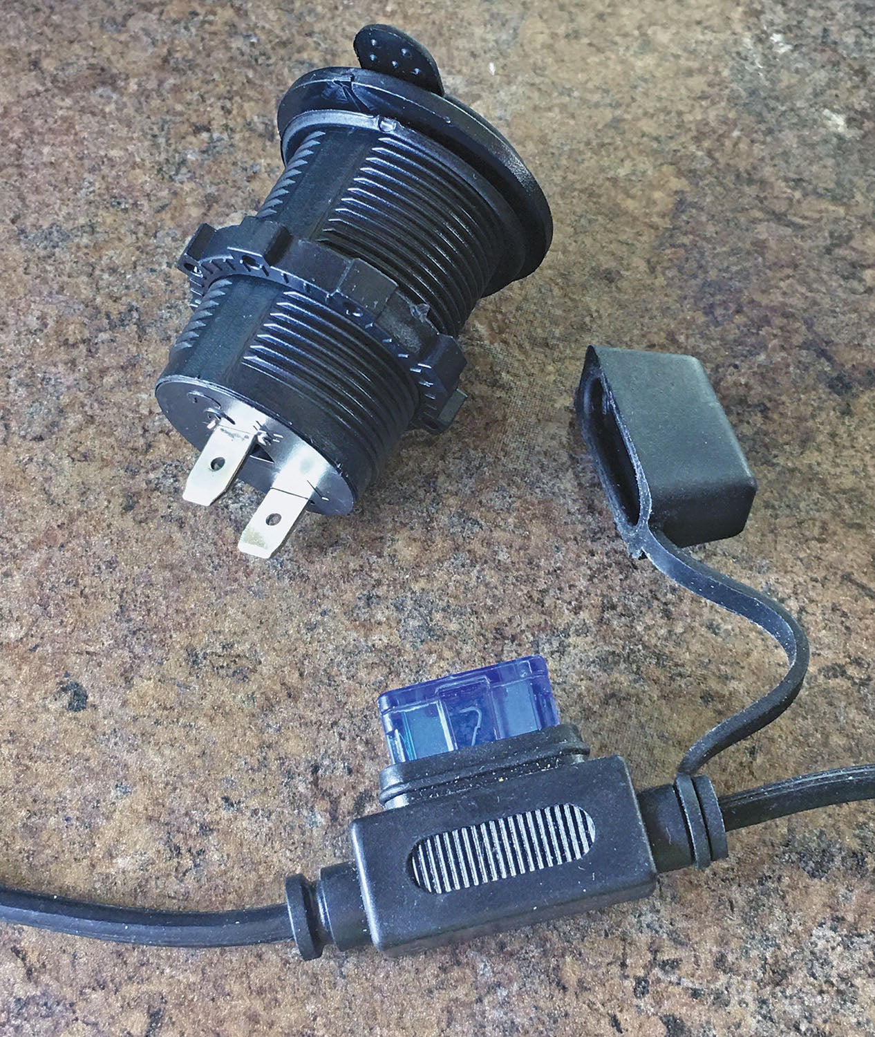

SocketFuse
A high-quality cigar lighter socket with terminals allows you to wire suitably heavy cables directly back to the battery. An inline fuse is a must.
One solution is to install an external charging receptacle made for this purpose on the fuselage. These receptacles are not cheap and require a matching plug for them to work. Not everyone will have an appropriate plug, so it may be tough to get a charge while away from home base.
Fortunately, there is an alternative method to accomplish the same purpose: A quick and simple charging port using a high-quality cigar lighter socket will do the job. We need one with a high amperage rating and terminals for our own wire connections. Shop carefully online (Amazon or similar) to locate these. Then, create a wired connection from this socket directly back to the battery with a fused set of wires (12 gauge or larger) to handle about 20–30 amps. This means bypassing any battery contactor switches or solenoids when connecting the socket to the battery.
Adding a cigar lighter socket to your aircraft panel provides dual service. You gain a 12-volt universal port to power all sorts of accessories (think phone chargers with USB adapters, etc.), and you’ll have a way to recharge your aircraft battery when it fails for any reason. While this is not the same as jump-starting your aircraft battery (jumping requires way too much amperage for this purpose), the 20- to 30-amp capacity of this socket allows most small automotive battery chargers to quickly bring your aircraft battery back to life. (Use an approved charger if you installed lithium batteries in your aircraft.)

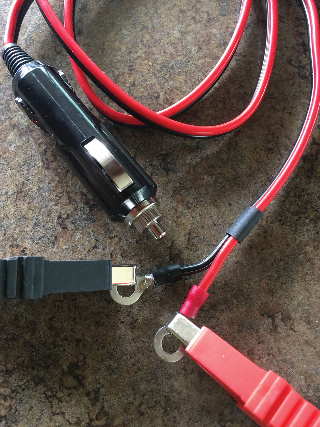

Using a male cigar lighter plug with cable and ring terminals (right) allows a small charger to be connected for charging the aircraft battery.
The only part missing for completing this operation is to attach a male cigar lighter plug to your charger’s clips (observing proper polarity, of course). The male plug with cord and ring terminals shown here was purchased from Amazon.
Plugging the male plug (with charger attached) into your panel’s cigar socket provides a quick and easy way to bring your aircraft battery back to life without opening the cowl and searching for a good connection on the battery terminals. Any charger with less than 20–30 amps output can now be used to bring a weak battery back to life when overworked during flying season or to maintain the battery with a trickle charge during off seasons. By storing the male plug and cable with the aircraft, anyone with a small charger can help you restore your battery when away from home base. You will find that the simplicity of this setup is hard to beat when you need a quick charge to get back into the air.
