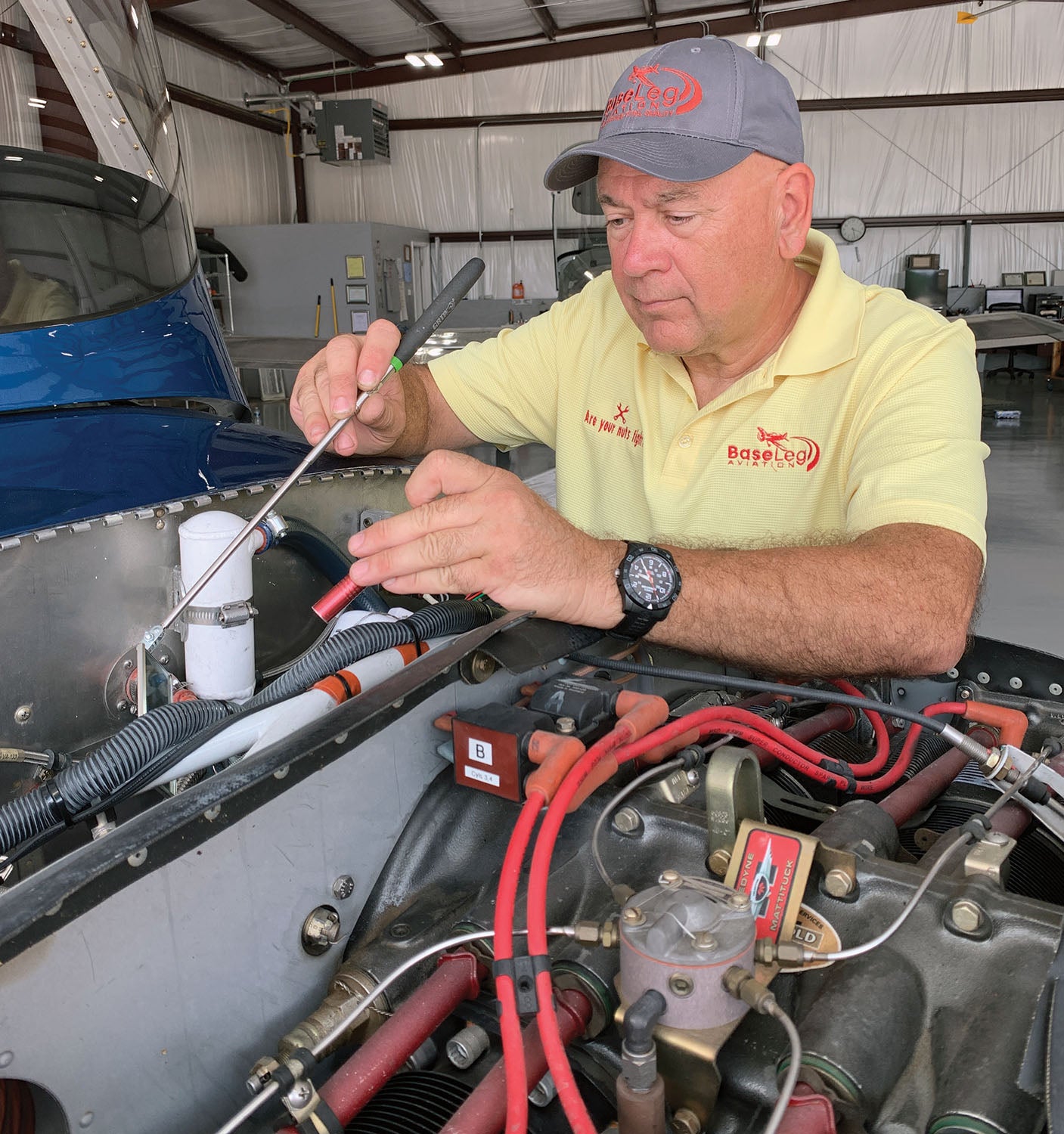

A question I get asked quite often is whether I can sign off the condition inspection while doing the prebuy inspection, especially when the aircraft being purchased is close to needing a condition inspection. I’m sure I’m not the only prebuy inspector who hears that, and I know the answer varies quite a bit. My answer is that it depends upon a bunch of variables, which I am going to try to explain here.
One hard and fast rule is that I won’t do a condition inspection unless it is in my shop. No, it’s not because I am trying to drive more business to the shop. It’s just that I find it very hard to perform a thorough condition inspection away from home. Why? First, all of my tools are at the shop. Yes, I take a bunch of tools with me when I travel to perform a prebuy inspection, and you can see the list of recommended tools for yourself in my recently published book, Pre-Buy Guide for Amateur-built Aircraft. But I certainly don’t take all of the tools needed to do a condition inspection, and I certainly don’t take any of the greases or other lubricants needed to complete a CI.
A really thorough prebuy inspection should uncover all of the major faults with the aircraft, including everything from paperwork and maintenance wear items to compliance with SBs and ADs. As a matter of fact, the purchaser of an aircraft who has asked me for a prebuy will receive a very thorough report, including pictures, of all of the discoveries. Theoretically, they could give this list to their mechanic or the seller and, with a little extra work, could probably complete a CI. The difference is that the CI will include fixing all of the discrepancies.
Oh, fixing them is the difference? Yes! If you look at the required wording that must be entered into the logbook for a condition inspection, it includes the phrase “in a condition for safe operation.” Personally, I find it hard to make this entry if there are known discrepancies that could affect safe operation. To be clear, I am not inferring that all of the discovered items must be fixed as some may be minor and could be deferred to a later date.
