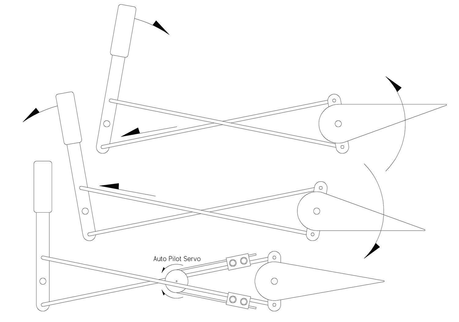

Photo 3 sketch of control system
As this sketch shows, the rigging of the
CFS autopilot is relatively simple. A servo-driven capstan drives a small cable, which is clamped to the main control cables.
The second detail to note is the smooth radius where the cable exits the clamp. One of the first lessons in engineering is that sharp corners are stress risers that can initiate fatigue failure. By softening the edge of the clamp, you prevent the strands from chafing and avoid possible cable failure.
The angle at which the cable pulls on the clamp is another reason why having a soft edge is important. The ideal would be to have the autopilot cable as perpendicular to the clamp as possible. The straighter it comes out of the clamp, the less fatigue there will be on the cable. It’s likely this angle will not always be perfect. In fact, on the CFS installation drawing I mentioned earlier, it shows the autopilot cable coming out of the clamp at an angle of about six degrees. So every time the controls are moved—regardless of whether the autopilot is engaged or not—the autopilot cable is in fact bending back and forth, however slightly.Photo 6 Sketch 2 bolt poka yoke Hi res
