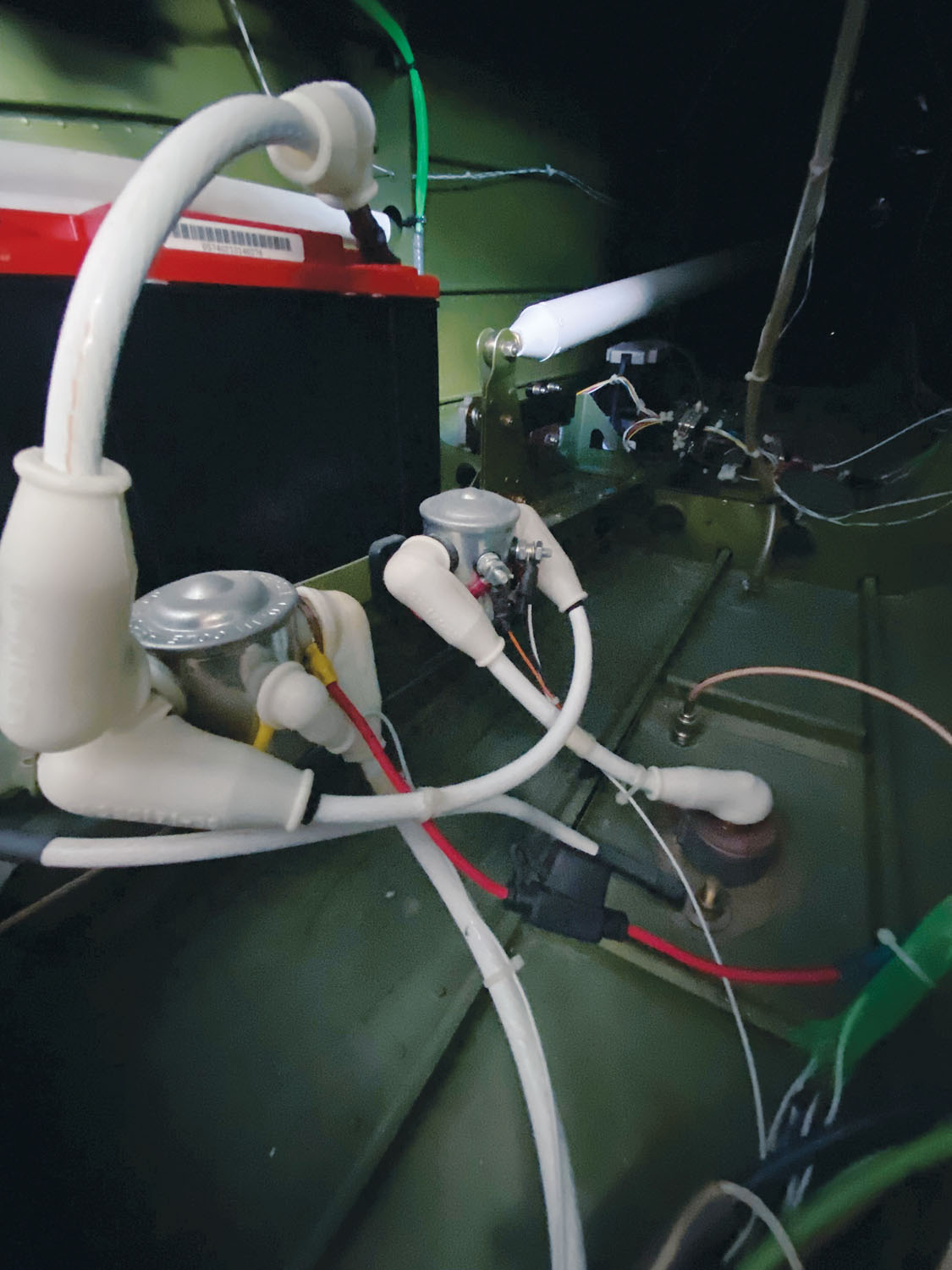

After having saved my bacon before with a ground power option on my previous aircraft, I was determined to install the option in my RV and did so in order to have it available prior to the very first power test of a circuit. The main three components are the receptacle, a relay and its switch. The ground-power relay can be exactly the same as the main battery relay and installed right next to it. So as an added bonus if the main battery relay were to ever fail at an inconvenient time or place, the ground power relay can be put to use.
Having the ground-power option allowed using an old but serviceable battery from my boat just sitting on the shop floor. In fact I didn’t purchase and install the proper ship’s battery until the morning of the first engine start—about three years after my first powered circuit test. When the time came, the battery and its warranty were fresh.
During the long period when the instrument panel was being installed, tested, programmed and played with, I would sit for hours at a time on a stadium seat carefully attached to the spar box with the system powered by an old battery that was also attached to a maintainer. I have been assured that using something like a charger/maintainer plugged into a household circuit was fine as long as it went through a battery and never connected directly to the aircraft. That makes the battery a capacitor of sorts for the protection of the aircraft circuitry.

In addition to drastically reducing the chances of getting the wrong amps and volts delivered to your airplane, there is one more very important reason that bolsters my opinion that the Piper-type option is the way to go. Bob Nuckolls, author of The AeroElectric Connection (long considered the bible of small aircraft electrical design), has produced a free pamphlet with detailed instructions and schematics showing how to equip an Experimental airplane with a Piper-style external power receptacle. Everything needed to complete the project is mentioned, including two sets of toilet-seat screws from a hardware store. He also includes part numbers for components from Aircraft Spruce.
