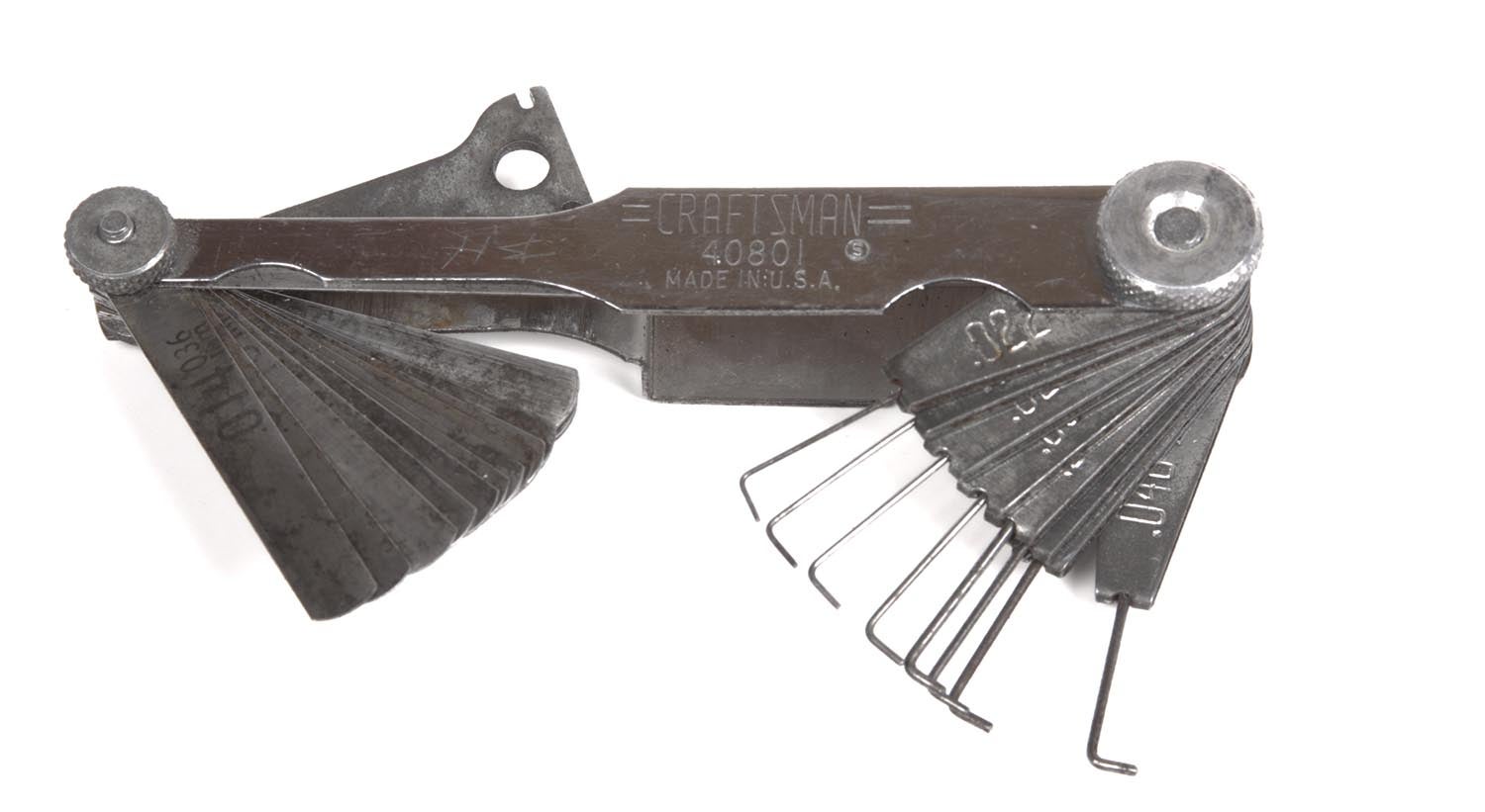

Now considered a vintage tool, the Craftsman 40801 spark plug gapper features a set of wire gauges, a set of blade gauges and an electrode bender.

The NGK plugs (D9EA) that I use in my Jabiru 3300 come with a gap of about 0.026 inches. The maintenance manual calls for it to be between 0.022 and 0.024 inch. Gapping plugs is by no means a Ph.D.-level exercise, but doing a batch of 12 can be tedious. The most common gapping tool is probably the combo feeler gauge/electrode bender (see photo). This type of electrode bender is essentially a miniature blacksmith’s fork that allows you to lever the base of the ground electrode (also called the side electrode) to either open or close the gap to the center electrode. While they work as intended and are economical, it takes a bit of trial and error: Measure, bend, repeat, until you zero in on the proper gap.

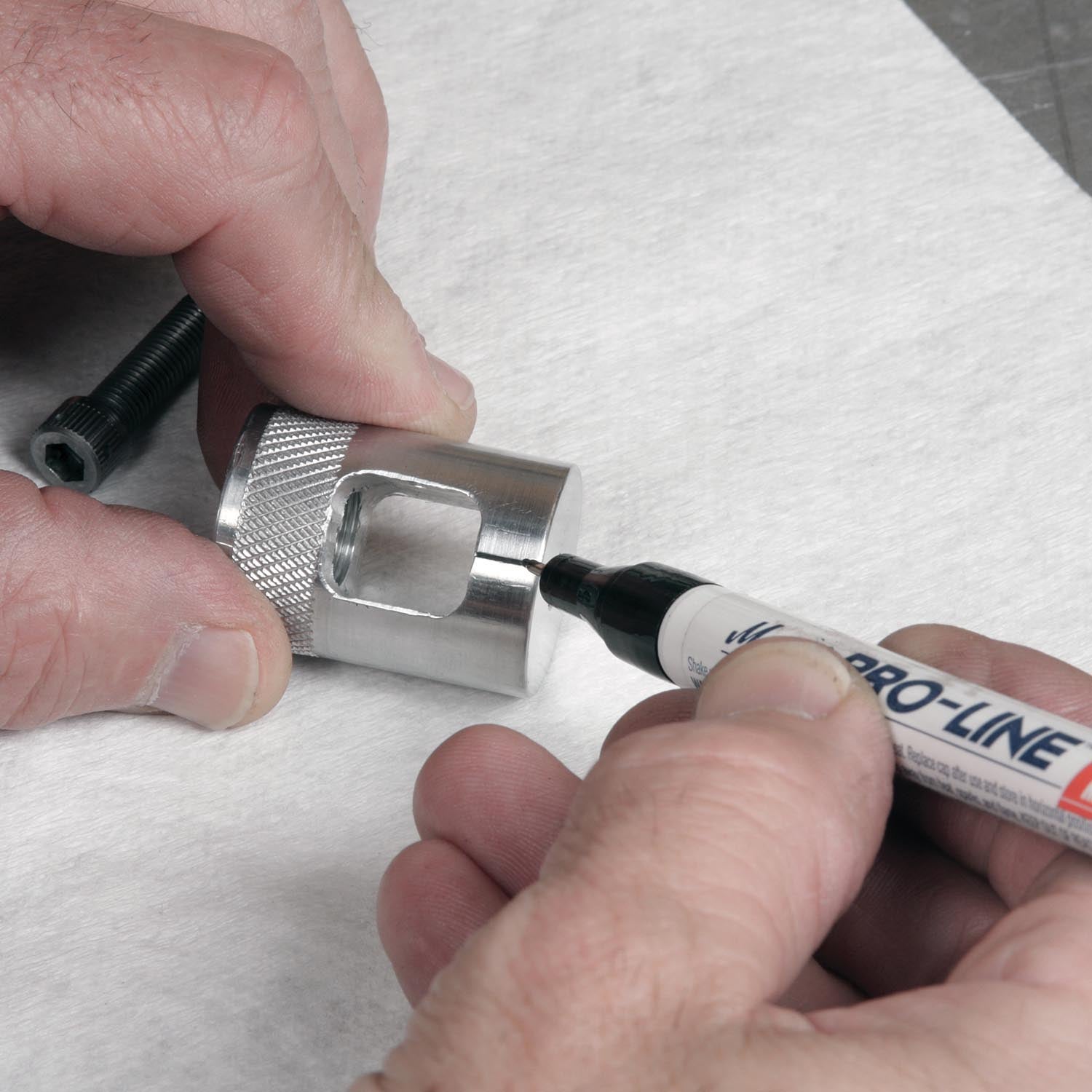

Engraving the graduation marks was done using an indexer and a thin kerf slitting saw. The saw teeth were ground to a knife edge to create a sharp, pointed groove. The cut depth was 0.006 inch. The same setup was used to engrave a reference line on the tool body.
plug gapping tool 12
A fine-point paint pen was used to make the reference line on the body more visible.
