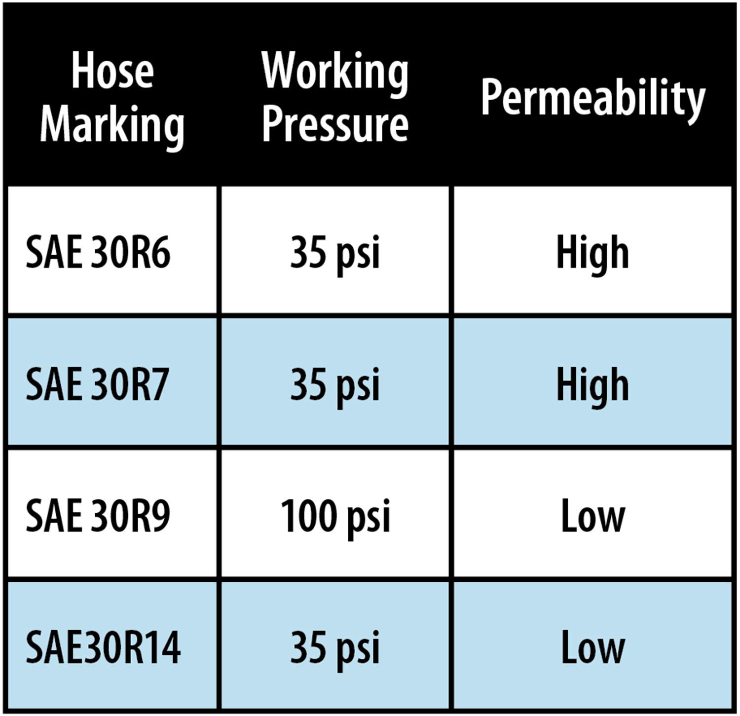

Is the pressure rating and permeability of a hose listed on its jacket? Usually not! Instead, a numbering system is in place that provides this same information. In the U.S. an industry standard group (SAE J30) has created a number of rubber hose standards that manufacturers utilize when making hose. These standards are documented and published so everyone can determine what pressure ratings, permeability, compatible fuels and other characteristics are assigned to a specific hose type. Those standard hose types are often printed on the outer covering of the rubber hose stock at the auto parts store. The last piece of the puzzle is to be aware of the popular standard hose types that are applicable for use as fuel lines in our aircraft.
hoses table
The table shows the most popular markings you will find on rubber fuel hose at the auto parts store.
The standards and ratings shown are very approximate and not all inclusive. Hose diameter and other factors will alter the pressure limits. Double-check and verify these specifications by using Google (e.g., “SAE 30R9 specs”) to view the standards from official documents and vendors online.

One idea to take away from this entire discussion is to avoid hose marked with SAE 30R6 and SAE 30R7 because of their high permeability and resultant short life. This is the lawn mower hose and will require more frequent inspection and replacement intervals than the others.
