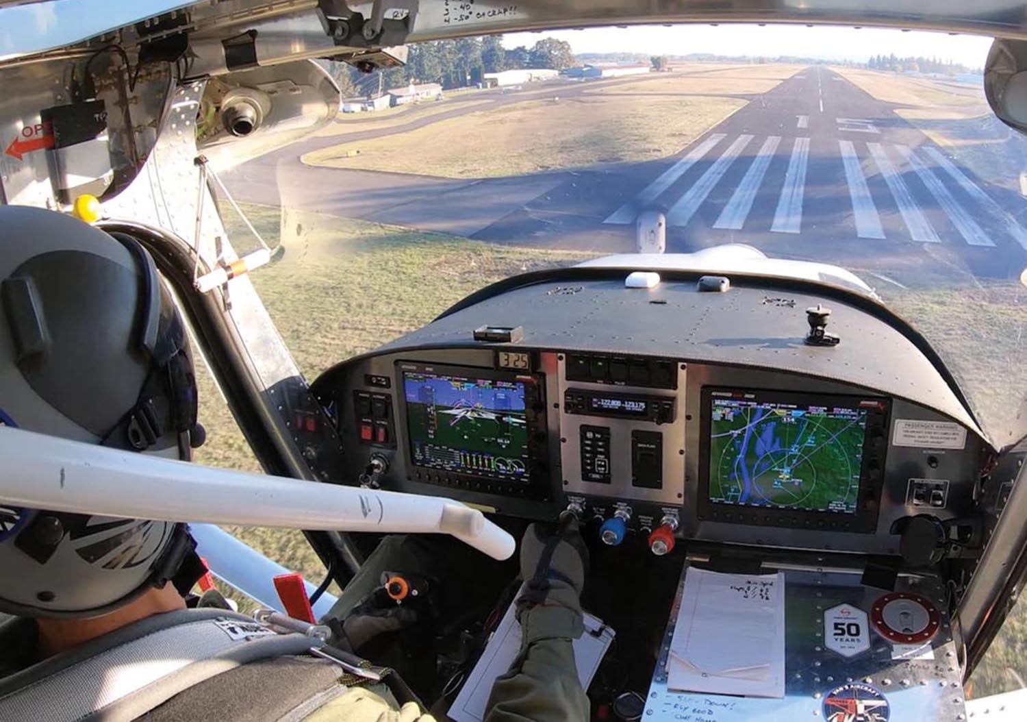

Task-based Phase I flight testing offers the opportunity to reduce the duration of the process, from first engine start to release into the world of Phase II flying.

There are many ways to build a flight-test program, but the pros all use a version of flight test cards, basically a condensed description of each flight. The AC says, “The task-based flight test plan should contain ‘flight test cards’ that can be used to document results of flight test procedures and provide for the AC 90-89C collection and recording of flight test data.” It lists the items that should be on each card: date; aircraft N-number or serial number; location (airport ID) for takeoff and landing; start time, takeoff time, landing time, and shutdown time; the name of the builder/owner pilot and additional qualified pilot, if applicable; flap setting for takeoff and landing, if applicable; name of observer, if applicable; takeoff weight and center of gravity (CG); takeoff fuel quantity; planned duration of flight; planned landing fuel quantity; altimeter setting; objectives for each flight test element; risk level or risk designation for each flight test element; specific procedures for each flight test element; emergency preparedness measures necessary and specific to each element; acceptable or satisfactory completion criteria or outcomes for each flight test element; and comments and results for each flight test element.
The AC helpfully includes an example of a flight-test card. You could certainly build your own but there’s a very nice commercial example from EAA called the Flight Test Manual and the accompanying Test Card Book that’s all of $25 ($22.50 for EAA members), which provide an extremely well-considered flight-test plan and incremental steps laid out in the card book. In essence, you study for the work as you’re building and then follow the sequence card-by-card until you’re done. The beauty of this system is that it’s built in an order that maximizes your time and reduces duplicate effort.
