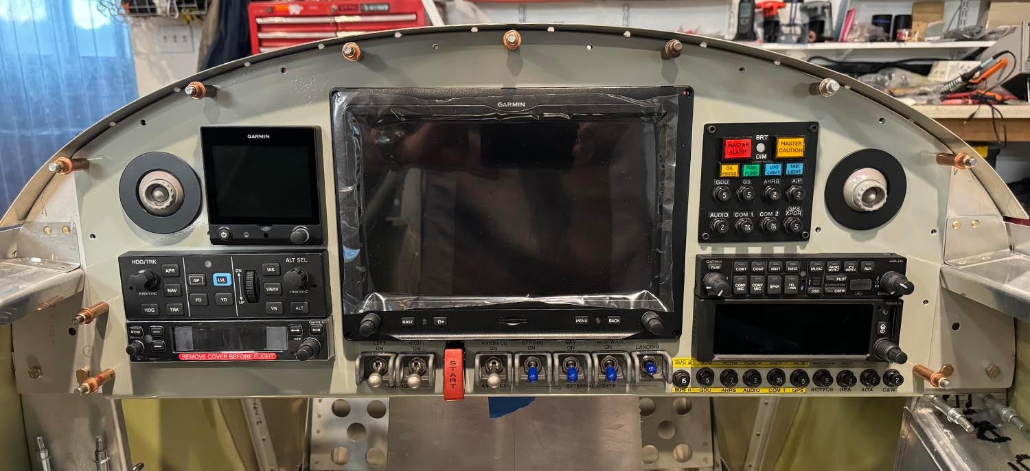

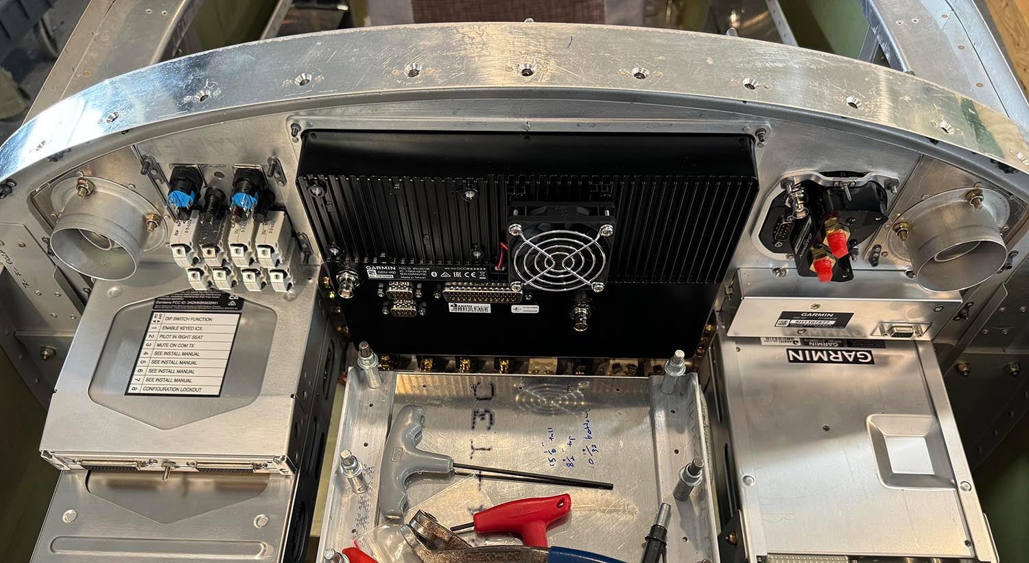

eyeball vent alignment in panel 01Building up the panel for our F1 Rocket project has been fun – I enjoy doing panels and cockpits, because that’s where the pilot lives! I strive for simplicity, usability and maintainability… so I like panels that are removable. This can get complicated when you have pesky eyeball vents as part of the panel—you end up with the panel in your lap trying to disconnect SCAT tubing—it’s a bit of a pain.eyeball vent alignment in panel 02

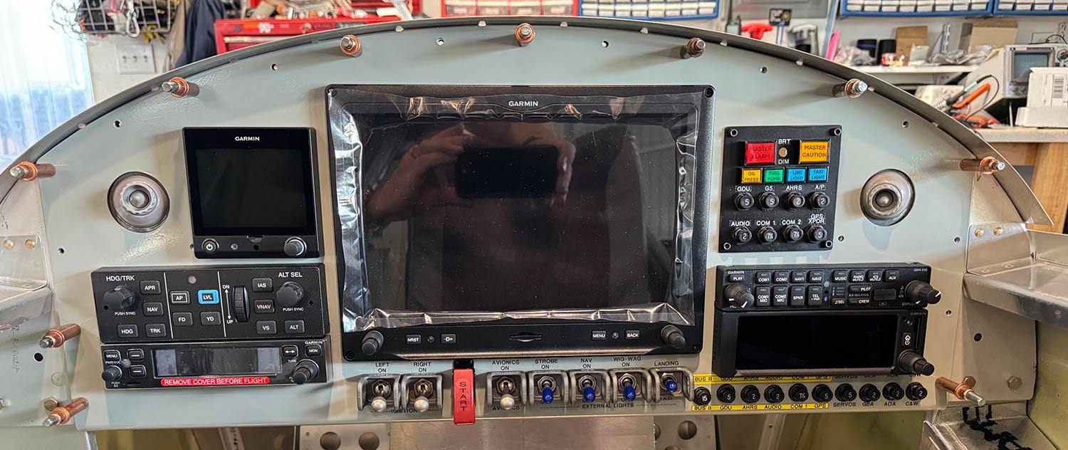

So this time I used a little trick—the eyeballs are mounted to sub-panels that are fixed to the airframe, and they poke through holes in the main panel when it is installed. But getting those round eyeballs perfectly centered is just about impossible due to simple measurement tolerance stack-up. Even if you’re only off a small fraction of an inch, the eye sees that it isn’t concentric in the hole.eyeball vent alignment in panel 03

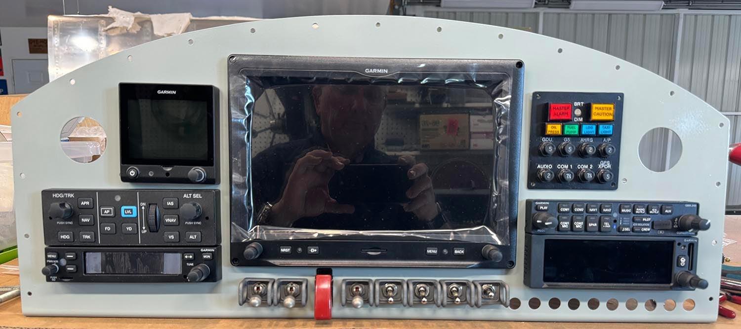

How to fix this? You cheat! I cut a large enough hole in the panel so that the eyeball would definitely be captured, then machined a couple of trim rings out of 1/8” aluminum scrap using the lathe. The inside diameter matched the actual diameter of the eyeball exactly, and the outside diameter was large enough to cover the hole in the panel. I then used 3M VHB tape (the stuff used to hold trim on cars, or GoPros to the wings of airplanes) to attach them perfectly centered on the the eyeball.eyeball vent alignment in panel 04
If aesthetics are important to you, it’s good to know you don’t have to make things perfect—you can always cheat later and no one will ever notice that the trim rings aren’t in exactly the same spot on both sides of the panel.
