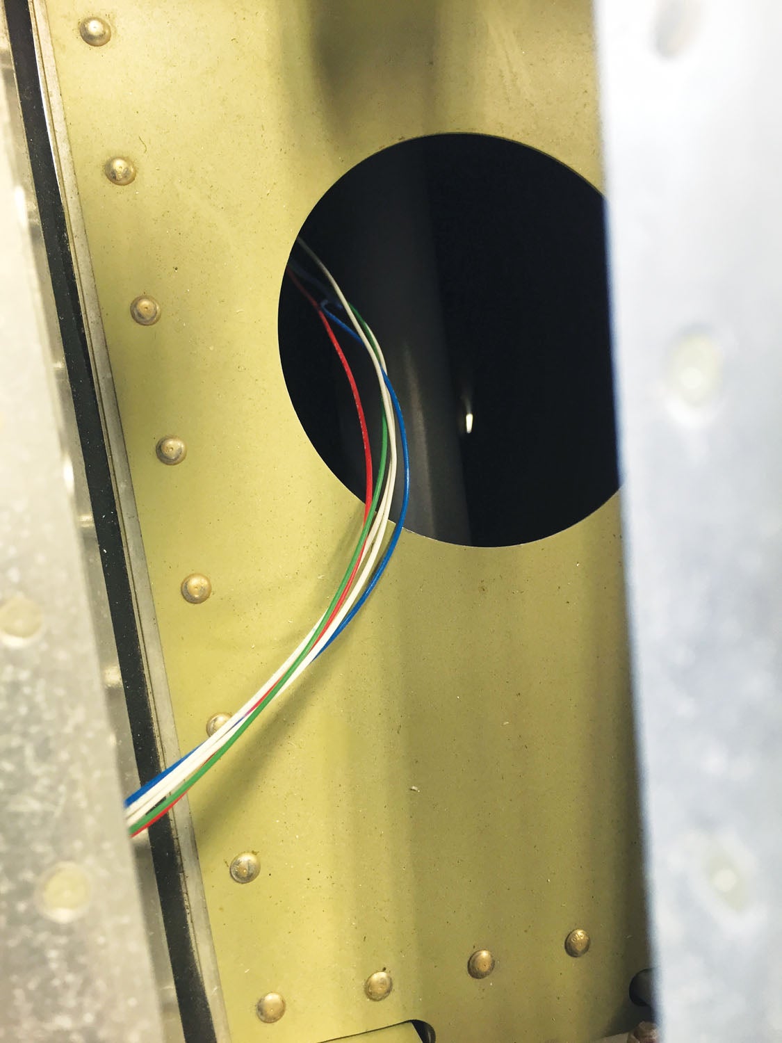

checkpoints 0522 01
Wires should be wrapped or somehow secured to avoid getting chafed when passing through or by sharp surfaces. If not, eventually the insulation could be cut through and become a source of intermittent problems.
The best place to start would be at the alternator field connection and then follow the wire to where it enters the firewall. So that’s what I did, and I think this is the fastest I’ve ever solved an intermittent problem. About four inches back from the alternator, I could see that the steel spring wrapping of the EGT probe was touching the field wire. I moved it aside and staring me in the face was a spot on the field wire where the insulation had rubbed through due to vibration. Yeah! Time will tell for sure, but I’m confident I found it.
While it’s easy to see how insulation being worn off can cause a problem, there is another source of intermittent electrical failures that is a little harder to find. It’s called “cold flow.” What happens is that when a wire is clamped too tight, over time the insulation can compress and eventually push the wire through the insulation. This takes a while to show up but seems to be very common in engine compartments where wires are bundled with other metal-sheathed wires, such as EGT and CHT probes. We’ve also seen some construction errors where a wire was inadvertently clamped underneath a panel or other structure during assembly, and no one noticed it. The backshell connectors can also be a source of this problem if the clamp is tightened too much on the wire bundle. So, for those of you who are doing your own wiring, there are two lessons: Don’t be a gorilla, and be sure to protect and separate different types of wires as much as possible.
