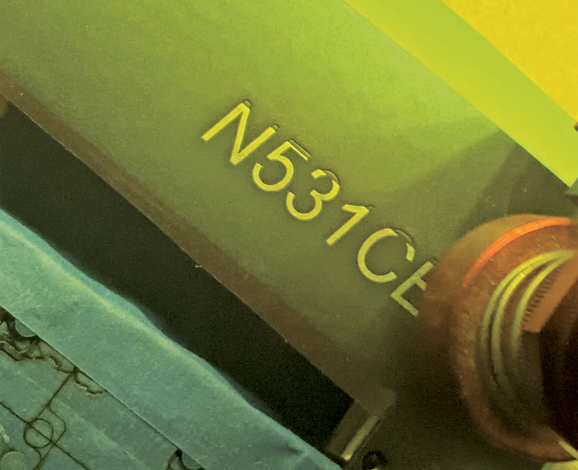

The laser cuts through the vinyl paint mask and slightly into the metal at the same time.

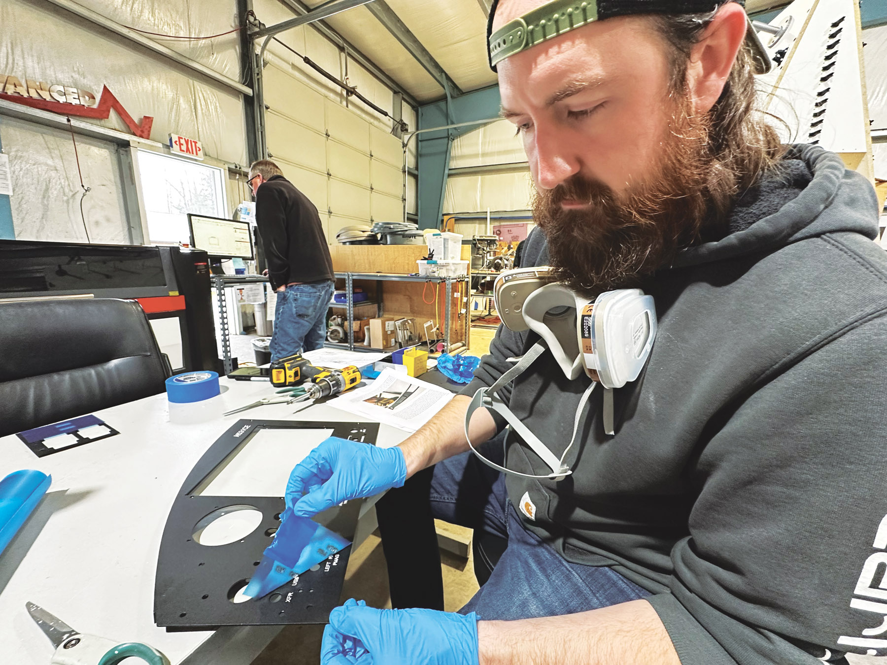

Patrick McCormick peels back the paint mask
Patrick McCormick peels back the paint mask.

Watching the laser-etching process is fascinating. It does such a nice, neat job it’s hard to imagine wanting to do dry transfers or any other method. Yes, it did take Kyle George a bit of time mapping the letters out in CAD software, but he already had the panel blanks in the system, which saved a few steps. After a little bit of refinement and typo-catching, the computer drawing was ready.
Like anything, the key is preparation. AFS has the laser plot some elements into a backing that is used to make sure the actual panel is correctly positioned. The panels themselves have thick vinyl overlays on the areas to be engraved. This functions as a paint mask. In their process, the panels are fully powder coated front and back. Then the laser does its job. With the vinyl masks still in place, the panels are painted in the lettering color with an airbrush.
The final step is to remove the vinyl mask, which is complicated by having to remove the “dead zones” inside of D’s and P’s, for example. There is some important hand work committed here.
