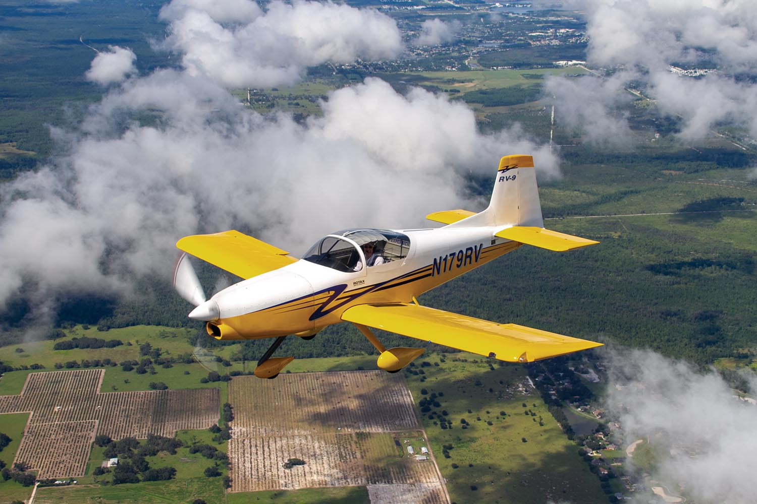

The Lockwood Project
Phil Lockwood has been using Rotax engines in designs for decades, making him a knowledge center on the type. Plus, Lockwood was part of the Aircraft Kit Industry Association (AKIA), so it wasn’t hard for him to collaborate with Van’s through chief engineer Rian Johnson. The result: A factory RV-9A appeared in Florida for modification. The airframe is still owned by Van’s but otherwise this is a Lockwood project.
When I visited Lockwood back in May 2023, the RV-9A had been flying for quite a while and was reaching its final configuration. I didn’t get to fly it because it was undergoing some modifications to improve on the baseline cowl and to add some yaw stability with a dorsal fin, but I learned a lot about the project that we can share. True to the norms of R&D, the airplane I saw was on its third engine mount—improvements along the way were to change engine position and mount components (such as radiators) in various positions and locations. They had also built several cowls, mostly to accommodate the different engine mounts, but also to provide incremental improvements in cooling airflow for the radiators. The cowling I saw was close to being modified once again, with tape lines indicating that they would drop the upper profile down maybe 6 inches at the front and add a bump to the top for the top of the spinner (similar to an RV-8 profile). The cowling then was larger than necessary, but it is the shape “the aero guy” specified. While there was intent to narrow it up a bit more, the cowling I flew was essentially what I saw in my spring visit—and it works quite well.
In May, the cooling was pretty well sorted out, with a single air intake underneath the prop to provide cooling air for the water and oil radiators, intercoolers and cylinders. This inlet also provides intake air. In my September visit, the engineers were looking toward a slightly different intercooler for the turbocharger—I saw no evidence that it was necessary, but engineers are always looking for “better.”
The engine is fairly far forward to make the CG come out right and this leads to the turboprop look. Lockwood mentioned that the CG of the -9A is fairly far aft with a Lycoming and since he was going to be able to define the CG position from the start, he didn’t want to be limited when it came to baggage, so he put the engine plenty forward. He added that there is probably room for a forward baggage compartment between the engine and avionics, but this isn’t currently in the plans.
The propeller is an MT, hydraulically actuated constant-speed with three blades. While the engine has FADEC mixture control, this application still has manual prop and throttle, which Lockwood prefers. Having flown Rotax-powered aircraft with fully integrated, single-lever power controls, I think I agree with him because I am never quite certain what the prop is doing on those fully automated machines.
When Rian Johnson flew the Rotax-powered RV-9A in springtime, he found that with full rudder deflection, the yaw was divergent and he had to positively put in opposite rudder to bring the nose back in line. Lockwood has fixed this with a dorsal fin—they were on their second dorsal design when I was there since the first was bigger than needed. I watched them fit the second fin, beautifully made out of carbon fiber, and wished that I’d been able to stay a few more days to fly it.

During that May visit, I talked performance numbers with Lockwood, as long as I understood they were preliminary. Because the Rotax 915 iS is turbocharged to give full horsepower almost to the flight levels, Lockwood was expecting 200 KTAS at 18,000 feet but hadn’t yet tested that high. He was very aware that max-allowable speed limits on the RV-9 airframe could limit performance potential. More on that issue later.
Lockwood said that the airplane with this engine is smoother than anything he has ever flown. My overall experience with the Rotaxes confirms that the combination of high engine speed and a well-balanced prop makes for an incredibly smooth power package. He also noted that the fuel burn is much less than the Lycoming but didn’t get it quantified. Again, my experience with Rotax-powered airplanes such as the Slings confirms that they are thrifty on fuel—and that they are happy with less-expensive automotive fuel.

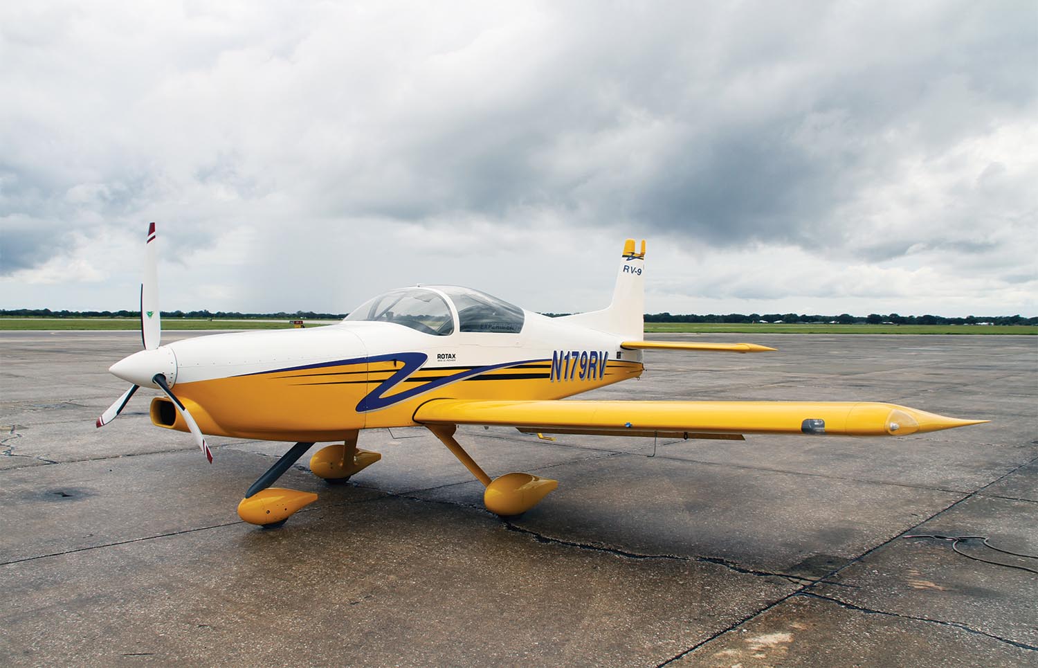

Now let’s go back up front. If you’re building a new RV-9A, just stop building when you get done with the firewall—everything in the kit will be replaced with parts from Lockwood. If you’re modifying an existing airplane, the same idea holds true with a notable exception. In June 2019, Van’s changed the RV-9A’s nose gear design to one similar to the RV-14’s, which has rubber isolators to absorb shocks. (The previous version was the more common steel strut.) But Lockwood’s engine mount is designed for the newer nose gear, making it incompatible for earlier RV-9As.
The engine mount is custom built in Lockwood’s welding shop and extends the engine well forward of the firewall. The truth is, any builder is going to look at all that empty space and think “baggage compartment” or maybe ‘“ballistic chute.” But Lockwood was determined to build an airplane much lighter than a Lycoming-powered ship and that meant not adding things. If you feel the additions are necessary, well—that’s up to you. The mount includes the attachments for the nosewheel, of course, as well as hard points for powerplant systems and components.
The Rotax 915 iS (or the 916 iS as both options should fit under the same cowl and to the same mounts) bolts on to the engine mount, of course, but many components (computer, ignition, etc.) will be mounted to the firewall or onto the engine mount itself. The installation features an oil cooler, water radiator, intercooler (for the turbocharger) and a hydraulic prop governor.
A few words about choosing the 915 or 916. As mentioned, the newer 916 has nearly 20 hp more for takeoff, but the maximum-continuous power is up only by 2 hp, from 135 to 137. It would be reasonable to expect the 916 to provide better runway performance and a stronger initial climb during the 5-minute limit for full power. Beyond that, the 915 and 916 are well matched. The newer 916 is, however, about $7000 more expensive.
Probably the largest part of Lockwood’s FWF kit is the cowling—and it is a beautiful (and complicated) piece of work. This is not just a shell to cover the engine. It includes ducting to move cooling air from the single inlet snout to where it needs to go to cool various components. If you look in the snout, you’ll see a large square heat exchanger in the middle—that is the oil cooler. On the starboard side of that cooler is a passage that carries air back to the intercooler and the engine-air inlet. On the port side, the duct feeds the water radiator. Above the oil cooler you’ll see a 2-inch SCAT tube adapter—this feeds air to the cylinder barrel cooling shrouds. (Like all 912-series engines, the Rotax 915 and 916 have liquid-cooled cylinder heads and air-cooled barrels.)
There are two smaller circular openings (also above the oil cooler) that feed air to the coil packs and voltage regulator. On top of the coil, you’ll see some small exit ports—these allow the coil pack and regulator air to escape. All the rest of the exhausted air goes out the bottom, along with the engine exhaust.
The cooling works exceptionally well. With a Lycoming in an RV, you’re often busy adjusting power, mixture and airspeed to cool the engine in climb. With the Rotax in the RV-9A, I just pushed the throttle in, set a nice climb power setting and forgot about things. I flew in late summer in Florida, yet the temperatures never got anywhere near any limits—the engine is well cooled and demands no attention from the pilot.
The cowling shape has evolved to the narrow, almost turbine-like profile that is now flying. This was mostly to reduce area exposed to the relative wind for both pitch and yaw—the initial cowling was more squared off. I found the change to be very effective and pitch stability was quite good. The same thing is true in yaw—the narrower cowl reduced sail area—but the dorsal fin was what got the airplane back to where it should be in yaw stability.
Overall, this is a very well thought-out and thoroughly engineered installation and the parts quality is superb. From the engine mount to the cowling, the parts built by Lockwood will stack up against anyone’s quality and if I were displaying this at Oshkosh, I’d take the top cowl off for the judges to look at. Even for a prototype, it is award-winning.
