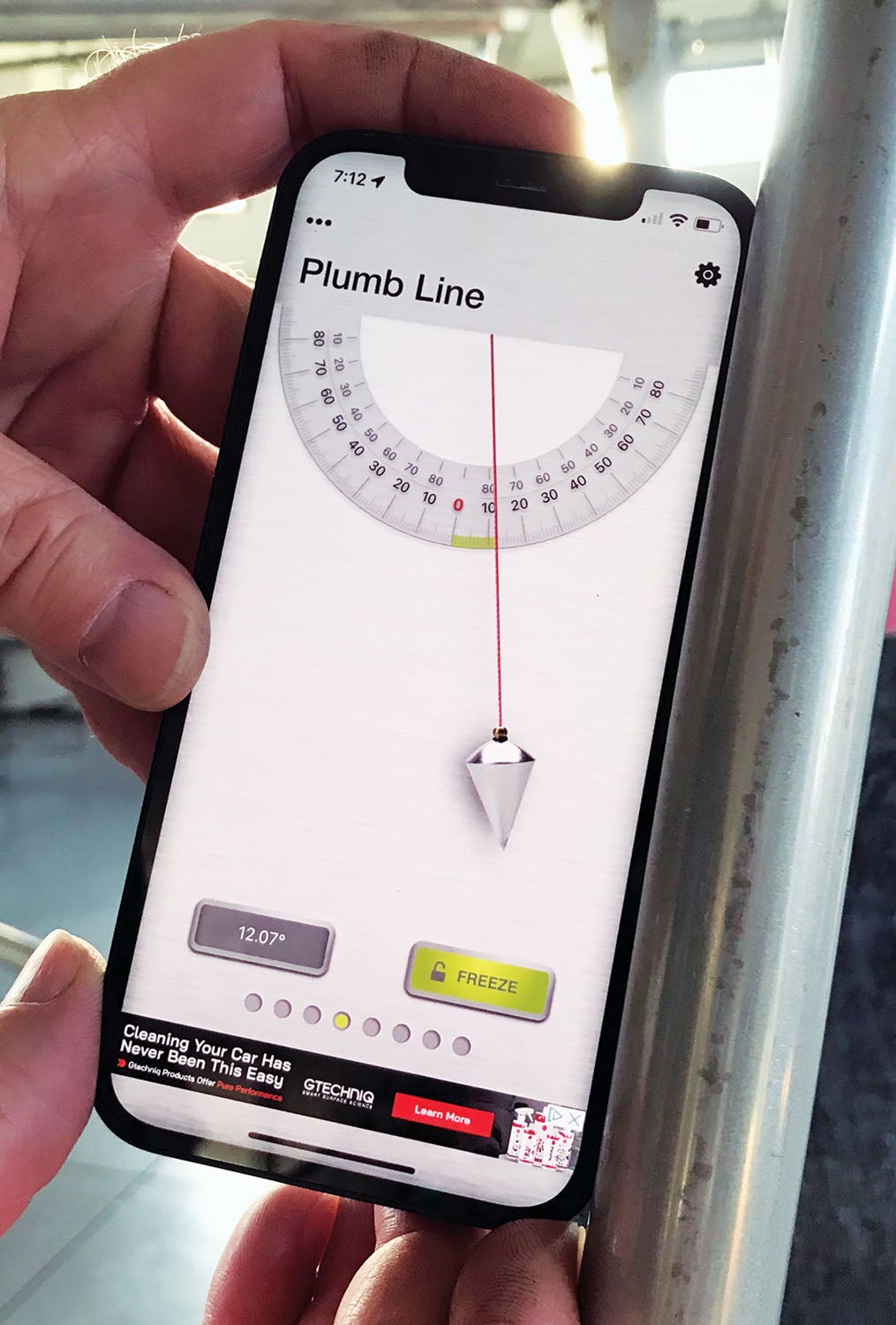

Plumbbob
The Bubble Level for iPhone app includes a digital plumb bob.
Specifically, there is a need to utilize tools like levels, protractors and plumb bobs when building an aircraft. A protractor is required when checking deflection of the elevator, ailerons, rudder and flaps. The aircraft designer specifies what the minimum and maximum values are for these. How do you verify the travel of these surfaces? In the “old” days, a mechanical protractor was used to measure the angles achieved. As time progressed, digital levels and digital protractors became available to the builder. Now, this functionality is offered as an app for a smartphone. Typically, these apps are free—if you don’t mind the advertisements that can interrupt your work. For a few dollars more, the ads are removed. There’s also a level as part of the standard Apple OS for iPhone.
The functionality you should investigate in these apps includes a digital level, plumb bob, protractor (angle finder) and ruler. Other functions from related apps include a compass, altimeter and audio meter. It is not my purpose to recommend a specific brand of app. Try them all on for size—usually free. Everyone has their preferences when it comes to features and options. Critical features are included in nearly all of these tools, such as the ability to freeze your current readout with the press of a button. Also, the ability to establish a base angle reference (when not wanting true level) is standard.

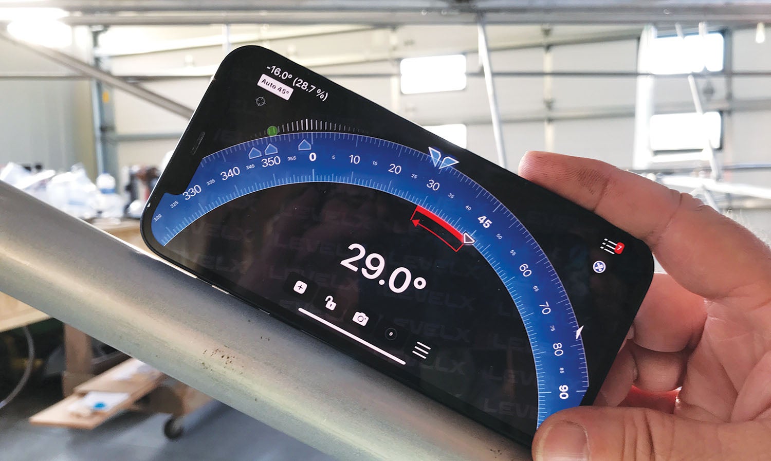

Strut
Angle measurement is simple and easy with the iLevel app. Visit the developer’s website, for links to either Apple iOS or Android versions.
Keep in mind that as an aircraft builder you will have other needs for these types of tools beyond setting and measuring control surface deflections. If you are required to set or measure the wing dihedral, then a good level is needed to get those few degrees on each side. Also, when setting up for weight and balance, it is important to level the aircraft to the designer’s specification. There are many other instances where leveling or angle finding is required when building an aircraft.
Elevator
Using the iLevel app to measure elevator deflection. (Note that the gusset thickness negates precise measurement.)
The accuracy of these instruments should be understood for best results. It would be a terrible thing to be off when it comes to critical measurements. The good news is that nearly all apps allow you to calibrate your new tool to some known standard. (A good bubble level for a reference is better than nothing!) The other odd issue I have noticed is that you need to be aware of any protrusions from your smartphone (like volume buttons, etc.) that are exaggerated by a protective case you may be using. The edge of your device is generally what is used to align it to the work that is being measured. I always take my phone out of the case so that I obtain a better flat edge. This situation will be self-evident when you first try your new electronic tool.
