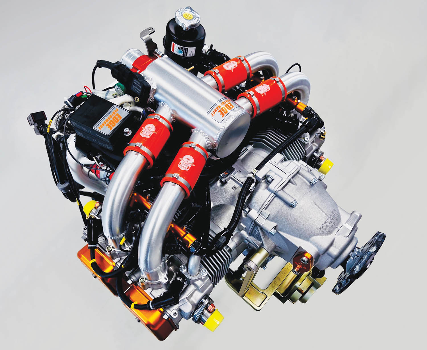

The EP912STi is Edge’s most popular engine. It adds a custom intake, throttle body, ECU and even a new, more efficient Garrett turbocharger to the tried-and-true 912.
