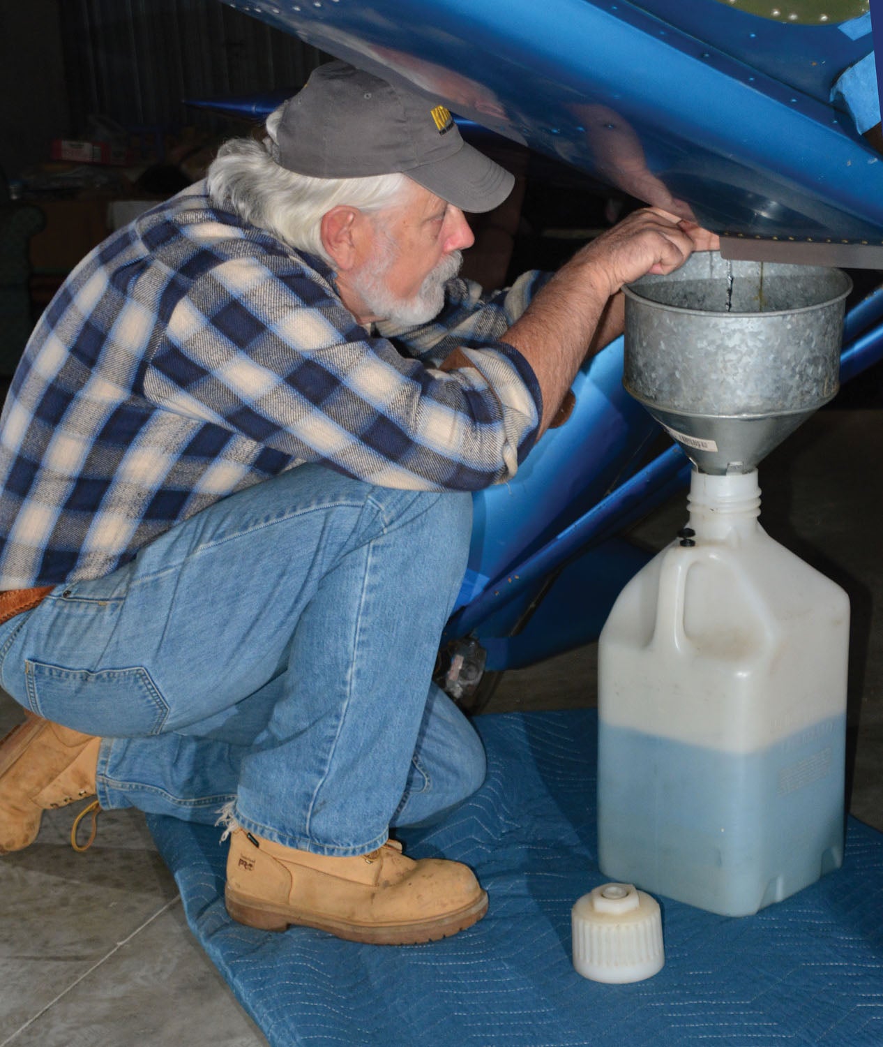

If you plumb the auxiliary fuel tank to the main tank when building your project, you can avoid sketchy operations such as this. An easier-to-access gascolator drain is on my wish list, too.
Occasionally it’s desirable on preflight to empty the aux tank into the main by draining the aux into a can and pouring it back into the main. Aerobatics might be the thing for an upcoming flight, which means an empty aux tank is mandated. Or due to the sometimes long periods between flights, coupled with the typical marginally accurate fuel gauge, especially in a tail-down position on the ground, I can’t quite remember or figure how much fuel is in the main tank (and you can’t stick it). In that case, the best thing is to simply fill the main and start the fuel calculations from a fresh baseline. I have no need to run out of joy juice.
Furthermore, when the aux tank gets down to the final five or seven gallons, accessing that fuel in flight can require accommodation that gets in the way. That’s because the fuel gravity feeds from the left rear corner of the suitcase-shaped tank, so if the airplane is pointed downhill with a low aux tank, it absolutely will unport the fuel line. It will even do the same in still air with an annoying randomness in level flight around the seven gallons remaining point. In any case, to get the last 20 minutes out of the aux tank means purposefully crabbing left wing low, which gets old about two minutes into the drill.
A week or so previously, I drained the aux tank to the main in preparation for a cross-country I wanted to make three days later. I would be out of town for those intervening three days and didn’t need to take time configuring the plane on the day of the future flight. Therefore, in a rare case of thinking ahead, I got out the fuel jug and funnel, and set up same under the gascolator fuel drain. Popping the drain’s difficult little tee handle into the open detent, I could then conveniently control the fuel flow with the fuel selector valve as I transferred what turned out to be about eight gallons into the main tank.

Of course, it wasn’t water as I knew already. The gascolator drain was still in the open position. Evidently I had never secured it a week ago, and with the wing tank dry there was nothing to leak. But once I selected the main then fuel was flowing out the gascolator, which accounted for the lean-running engine. Of course this was puddling under the airplane where I couldn’t see it.
The cure was simple enough—get out, close the gascolator drain and get back to business. But what if I had put on my headset or an engine had been running nearby? I never would have heard anything. And given some suction from the engine-driven pump and a bit of time to get even a little fuel flowing, could the engine have started and run? Could I have gotten to the runway and tried a takeoff, only to end up sputtering into the flower field at the end of our runway? No way, given the 540’s appetite for fuel, especially at takeoff, but it got me wondering. Would a carbureted engine run with an open fuel drain? If the float bowl was full, then it could easily take you to the scene of the accident. Heck, my old friend Ernie showed us how and his new widow told us about it at his funeral—she had been sitting next to him. The selector was on an empty tank on that one. Did someone smarter than me many years ago purposefully size gascolator drains large enough to ensure no engine will make takeoff power for just this reason? Is shuttling fuel around the airplane by draining tanks that great a policy? What if there had been a spark nearby?
This was a new way of fouling up, so there must be some lessons to be had, and for only the price of a couple cups of gasoline, too. For one thing, I think I better start checking that fuel drain during preflights. Sure, I was taught to sump the fuel system in primary training, but for some reason it’s never been on the Starduster walk-around. That little tee handle is a real pain, half buried in a tiny hole in the cowling. Only I operate the plane, it’s hangared and with big cowling doors I open to inspect the engine during preflight, I visually check the gascolator bowl for foreign junk. So yeah, I cycle the gascolator drain more often as a source of cleaning fluid than during preflight—but maybe I should at least check it for staining and to be sure it’s closed.
