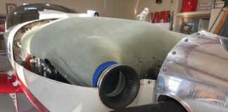

A collector attaches aft of the oil cooler to direct air from the engine-driven fan through the exhaust system for cabin heat.

Many builders opt for an electronic ignition, and so did Reese. Only next time, he’d do things differently. “I kept one standard magneto and replaced the other one with a Light Speed Engineering Plasma III electronic ignition,” he said. “The engine starts very easily and runs smoothly. But if I had it to do again, I’d replace both magnetos with electronic ignition.”
Another crucial process, Reese said, was to ceramic coat the exhaust system. “The special coating not only looks good, but it also reduces the cylinder-head temp.” He advises builders to be careful, though, when choosing a coating, as not all of them can withstand high temperatures. “I’m lucky so far that the Performance Coatings ceramic coat has held up very well.”

The factory-supplied stainless-steel exhaust system was given a ceramic coating to help keep the cylinder head temps low. A digital CHT gauge monitors and reports the temp of each cylinder.
