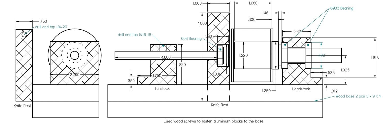

Download a high-resolution version of this sketch.

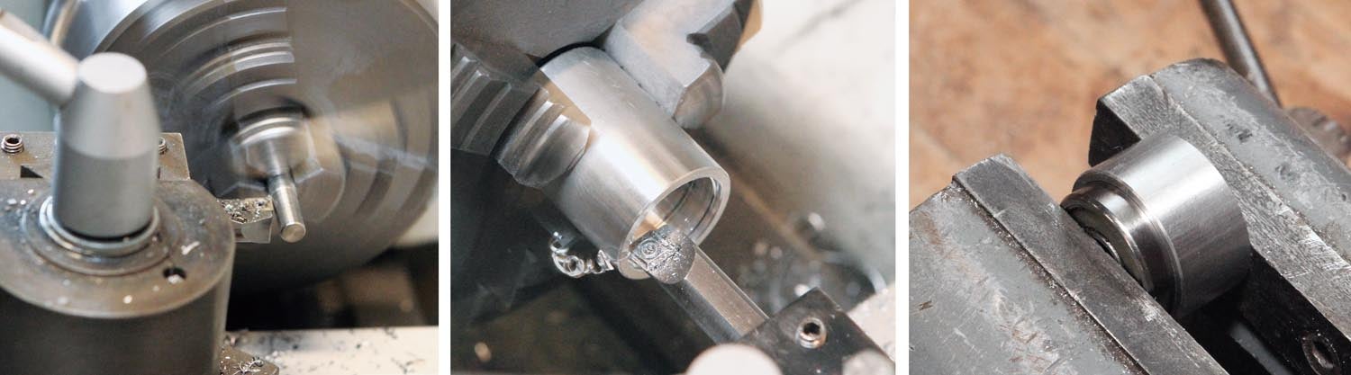

I thought about making an arbor to hold the cartridge in my lathe and use a knife like a parting tool. But since I sometimes work away from my shop, it would be nice to have a portable device that I could take on the road.
oil filter slicer 04

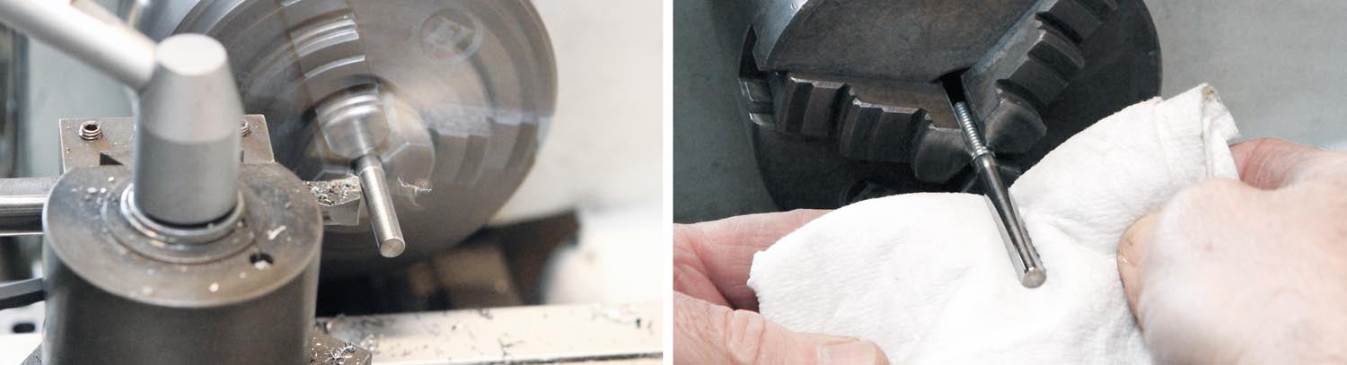

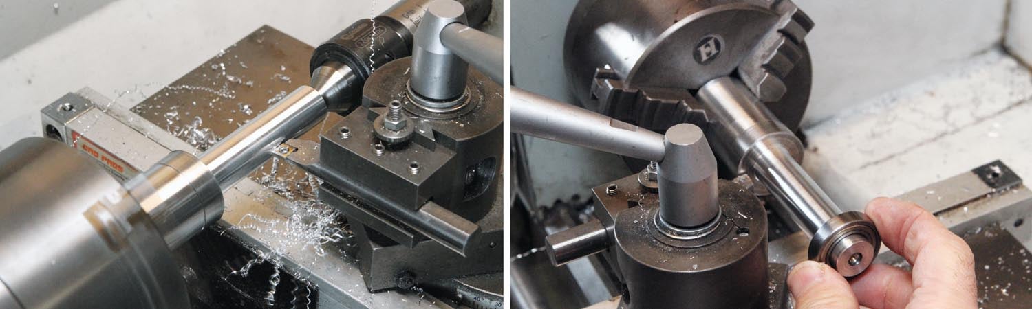

A rotating tail center (left) was necessary for turning on the end of the long spindle (center). Checking the fit of a filter cartridge (right).
oil filter slicer 05

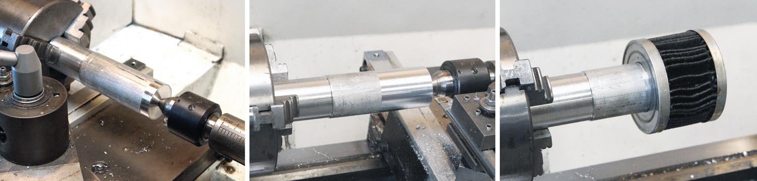

With the spindle flipped end for end and the rotating tail center reengaged (left), repeated passes were made until a close sliding fit to the headstock bearing was achieved (right).

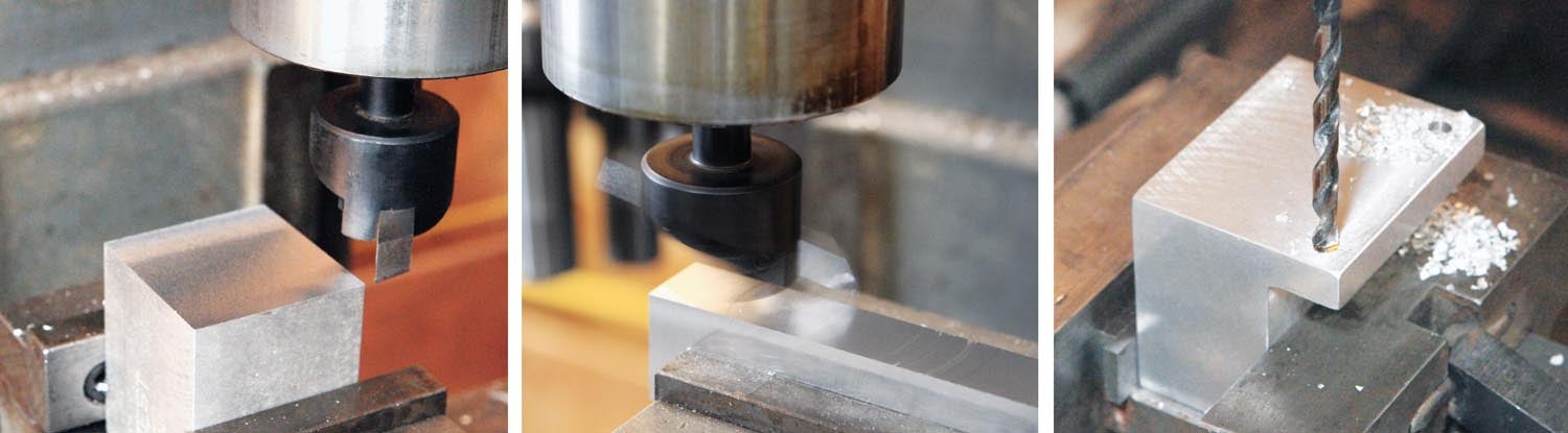

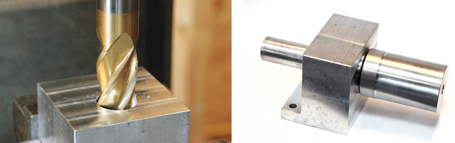

The headstock body was squared up and dimensioned on the milling machine in preparation for the bearing pockets (left). A small pilot hole was drilled and then the spindle clearance hole was sized by plunge cutting with a ¾-inch end mill (right).

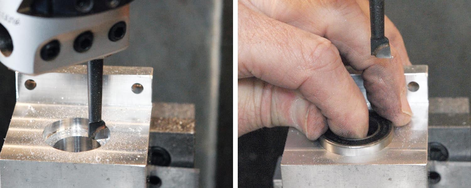

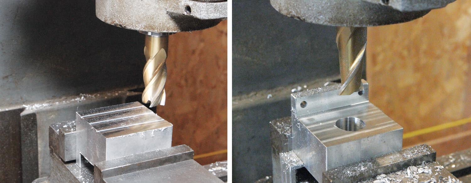

The pockets for the bearings required several steps to “creep up” on the dimension (left). Confirming the fit of the bearing (right).

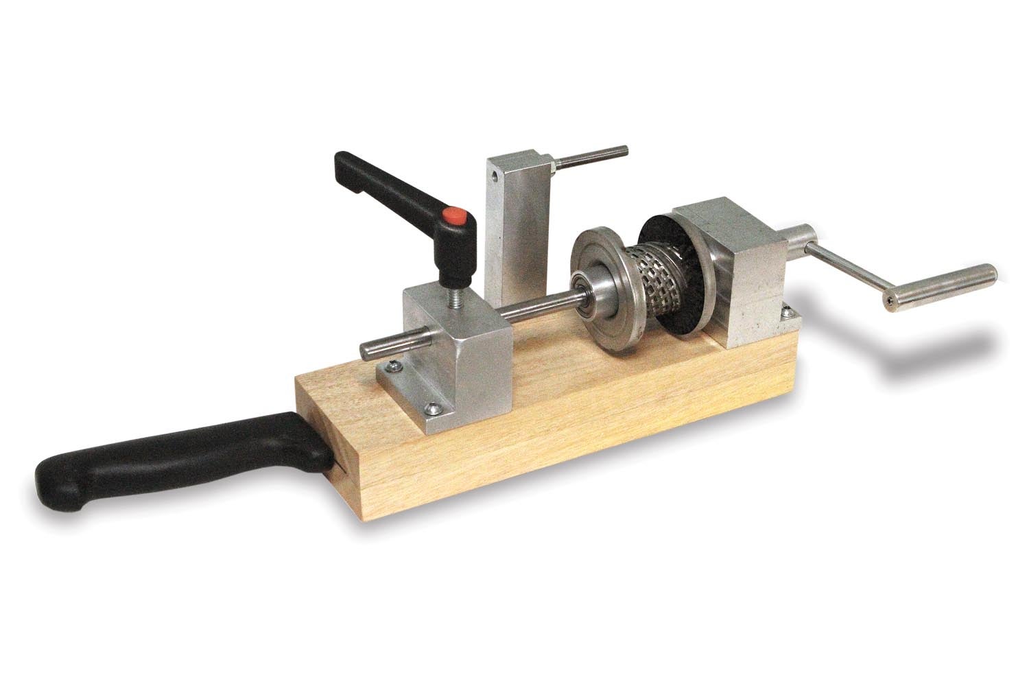

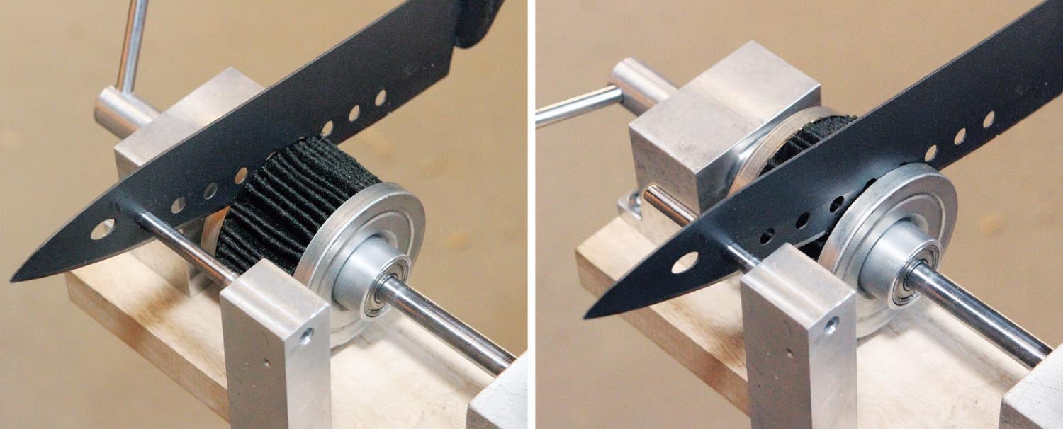

What I came up with was, for lack of a better description, a miniature hand-cranked lathe for slicing pleated filters from cartridge housings. The dimensions are specific to oil filters used on Jabiru engines (NAPA 1394), but there’s no reason the design couldn’t be adapted for just about any single-use, throwaway oil filter. The choice of bearings for the headstock (two 6903 metric bearings) and live center (one 608 metric bearing) was what I had on hand. The headstock bearings are certainly overkill for the application, but using them provided a good opportunity to demonstrate the basics of lining up and boring concentric bearing pockets for spindle applications.

Before boring the second pocket, the centerline must be confirmed (left). A quick way to do that is to use a cutter the same dimension as the center bore (in this case a 3/4-inch end mill) and adjust the table position until the cutter slides freely in and out of the hole. Once alignment is confirmed, reinstall the boring head and machine the bearing pocket. Test fitting the headstock, bearings and spindle assembly (right).

The tailstock block (left) and the knife “rest” (center) were pre-sized on the mill using a fly cutter. Drilling clearance holes for the mounting screws (right).

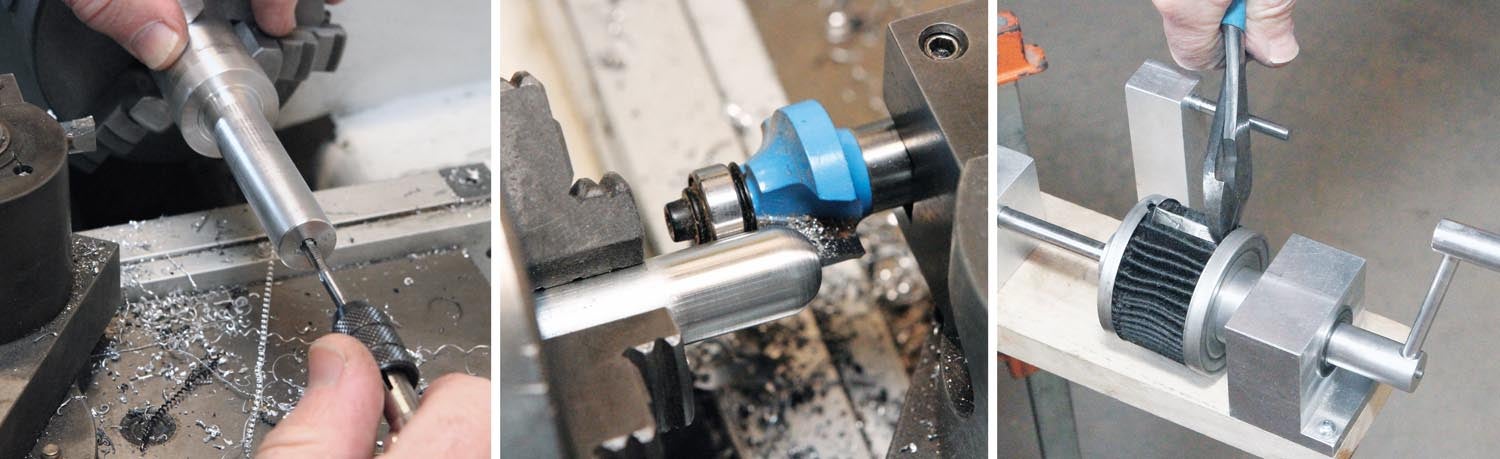

The support bar for the knife rest was turned (left) from a long ¼-20 bolt and polished (right). The ¼-inch shank had to be reduced to 6mm to fit the holes in the kitchen knife.
A key component to the design is the 13-inch Kitchen+Home brand knife purchased for $12 from Amazon. The knife features a series of 6mm holes punched in the blade. Whatever purpose these holes serve for cooking, they’re perfectly spaced pivot points for my filter slicer. The idea being, as the blade dulls, you can move the pivot and have a fresh edge. This will allow several filters to be cut before resharpening is necessary.

The end of the spindle was tapped 8-32 for a setscrew to secure the handle extension (left). The handle was rounded over using a router bit (center). See the December 2022 issue for more details on using a router bit for rounding over on the lathe. The metal staple that holds the ends of the pleat filter together has to be cut free from the housing with wire cutters before slicing (right).

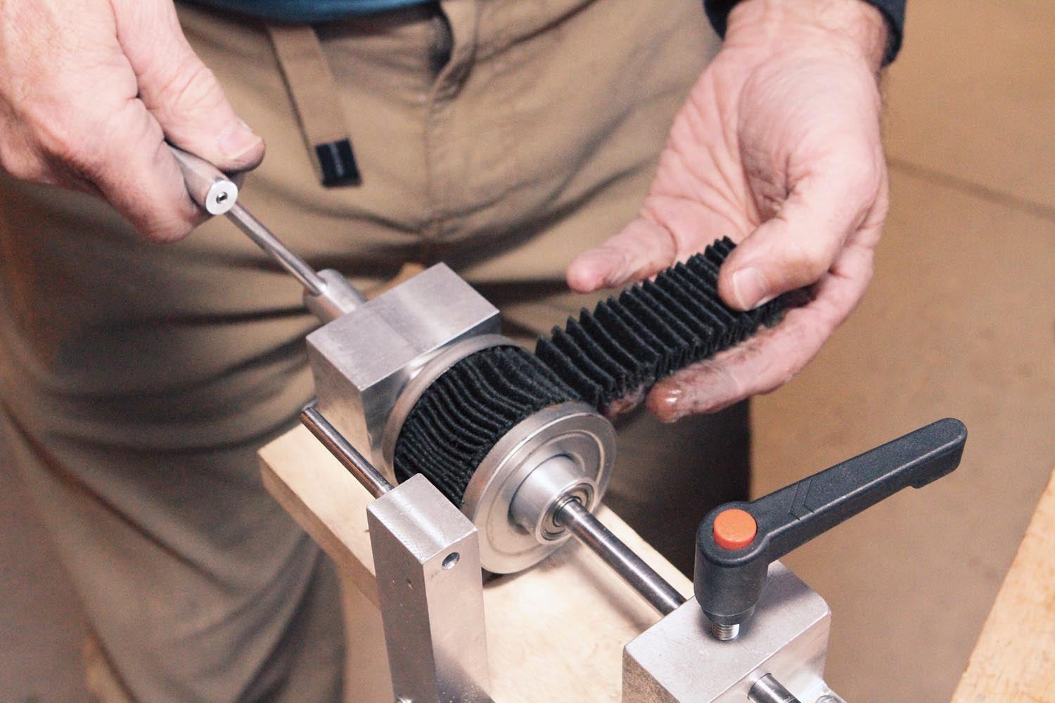

A test run with the components screwed down to a wood base and the base clamped to a bench. With the knife aligned to the edge of the cartridge and sufficient pressure applied to the tailstock—which is locked in place with the hand screw—the pleated filter element can be safely and cleanly sliced away from both sides of the cartridge.
oil filter slicer 03
Unfurling the pleats for washing and straining for debris to inspect.
