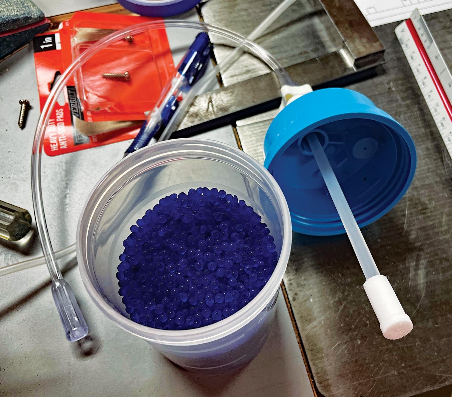

After rolling the concept around in his mind, Jim drew his design in AutoCAD. Then he purchased his materials (see sidebar below) and began constructing a small wooden framework to house his dehumidifier unit. He ran a tube from the output on the aquarium air pump into a bottle, which holds desiccant blue silica gel beads. (The blue beads turn pink as they absorb moisture.) Then he ran a tube from the desiccant bottle to a modified oil filler cap.
engine dehumidifier 07
Adding desiccant silica gel beads to the oxygen humidifier bottle.

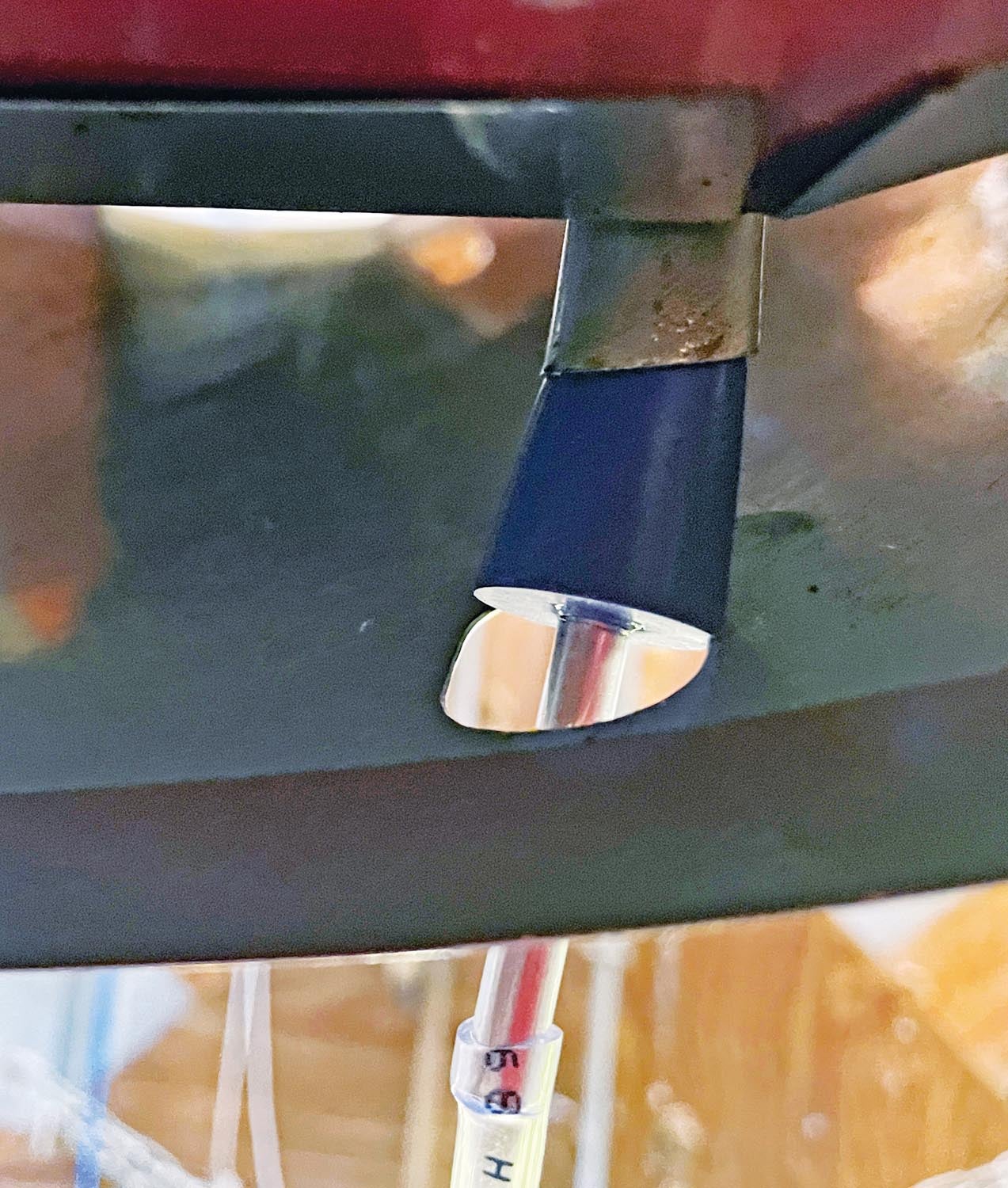

“I just drilled a hole in an extra oil cap and put a nylon bolt—with a hole drilled lengthwise through it—into the cap. Then I connected the tube up to that, so the pump can push air down through the filler neck into the engine,” said Jim. “The air exits the crankcase breather tube, which has a stopper on the end of it, and another tube goes from a hole in the stopper to a hose barb that I glued onto the bottom of the fish tank pump to finish out the closed-loop system. Air just circulates through the engine, out through the breather tube, and then goes back through the fish tank pump, which in turn pumps the air back through the desiccant.”

The return hose plugs into the breather tube.

Jim recycles the desiccant when it turns pink. He pours the silica gel beads into an old, clean mayonnaise jar and then he puts fresh desiccant in the dehumidifier unit to keep the system functioning while he takes the used desiccant home. He recycles it by spreading the beads out into an aluminum pan and drying them in a 250° oven for about an hour, until they turn blue again. “It’s easy to do, and that way you can use the desiccant many times over,” said Jim. “I bought 2 pounds of desiccant gel beads from Amazon, and it only takes about a cup and a half to fill the unit. So I have plenty on hand to keep the dehumidifier running.”

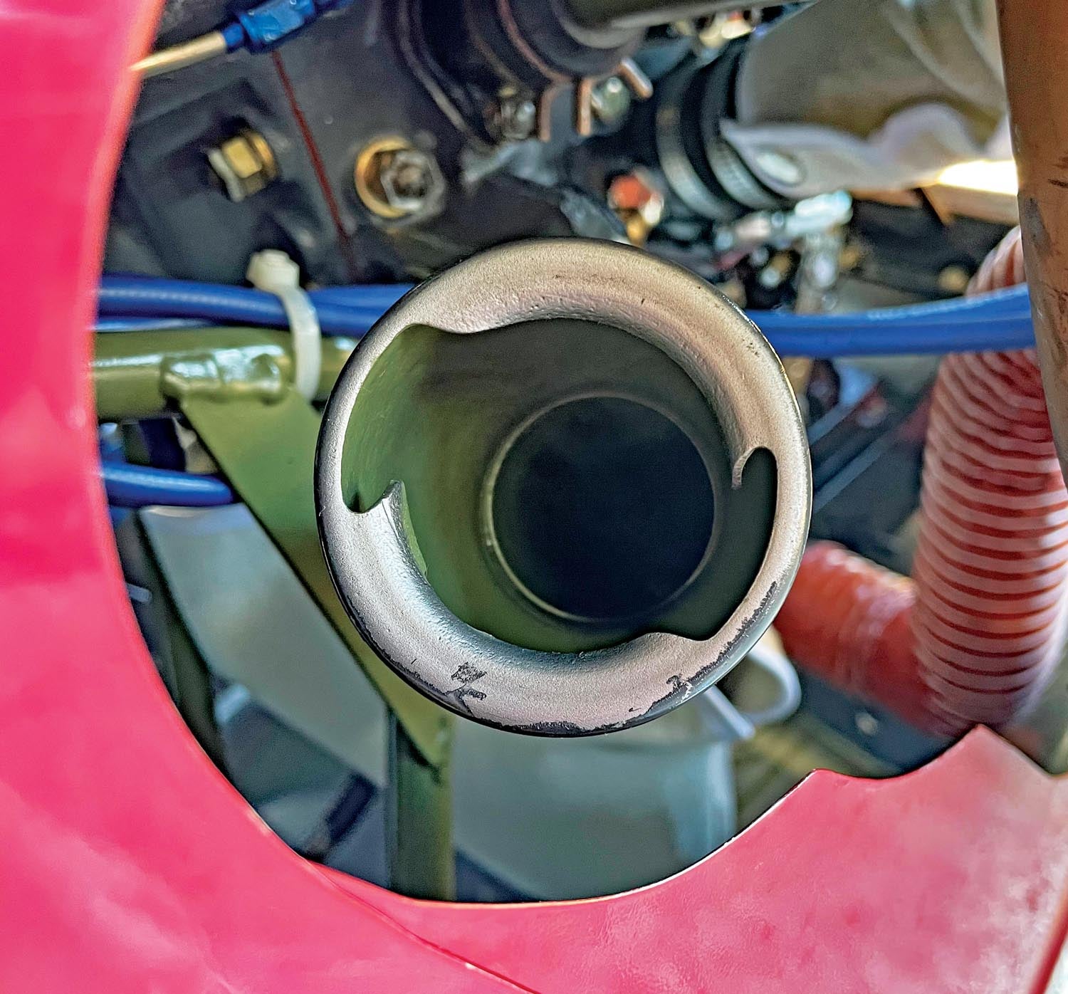

Jim admits that at first, he wasn’t certain if it was going to solve the condensation issue, but after using it for a year, he’s quite satisfied. When he first started using the system, he noticed that the desiccant turned pink after about four days. Now the desiccant lasts two or three weeks before turning pink.
engine dehumidifier 13
Voilà! A rust- and corrosion-free oil filler neck.
In fact, he’s pleased as punch with not only the fun he had designing and building his own engine dehumidifier, but also with the functional end product. “It gave me something to do to entertain myself and keep me out of trouble,” he laughed. “For being simple, inexpensive and something that works, it’s a pretty good solution. When I take the dipstick out now, even the edge of the filler neck looks brand new. There’s no evidence of corrosion or rust. Everybody’s engine will be a little bit different, and some people may doubt this system’s effectiveness, but I feel 99.98% sure that it’s helping and has corrected the problem of moisture in my little Continental.”
engine dehumidifier 12
The dehumidifier hooked up to the Fly Baby. Note the dipstick/oil cap resting in the landing wires near the cockpit cover. Hard to forget it there!
