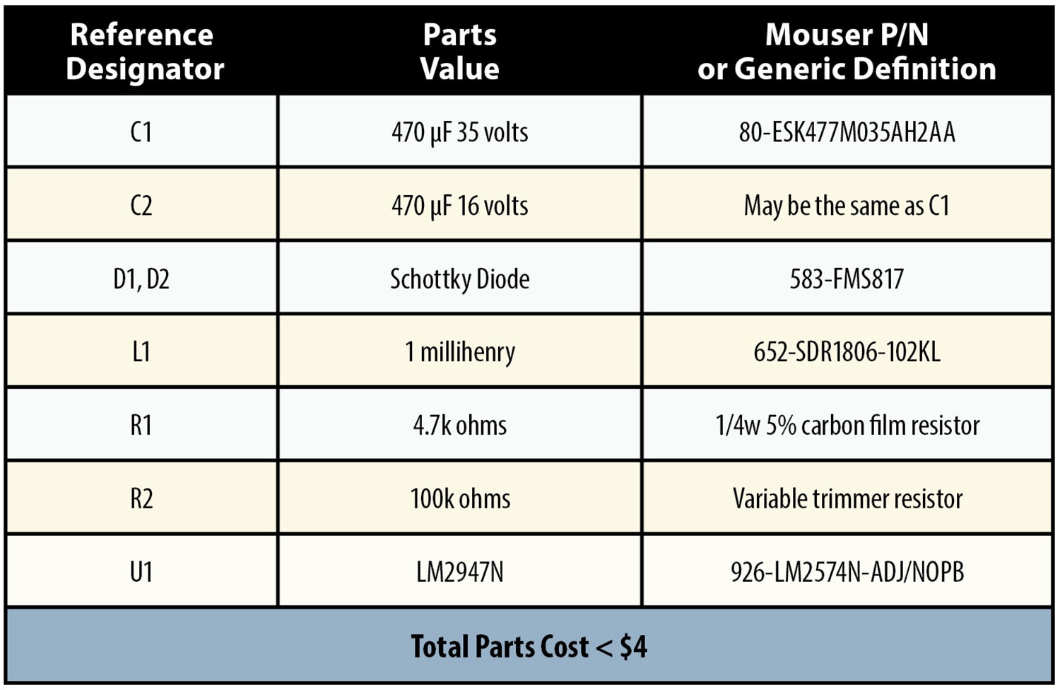

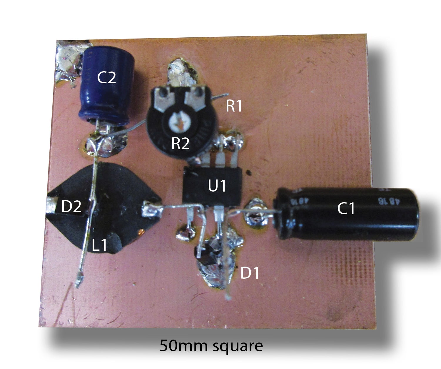

Let’s start off simple. I want to take that little red 1.5-watt solar cell (Harbor Freight #62449 or #64251, $15) and dump every bit of charge that I can into my hangar radio 12-volt battery power supply. That battery likes a charge of 13.8 volts to top it up. If we do the math, and remembering that power (watts) is the product of voltage times current, we can say that current is equal to watts divided by voltage. We know watts (1.5) and voltage (13.8), so we can say that this device should be able to pump about 0.107 amps (107 milliamps) into the battery, which should be just fine if we only want to use that radio in the hangar on weekends. This is a very inexpensive way to get our feet wet into solar energy.
parts referenceBut I’d like to be able to use our design to put up to half an amp (500 mA) into the battery so we can use a 5- to 8-watt panel for a bit more money later on. I’ll do the design with a switching regulator that can provide up to half an amp. We’ll get into multi-amp systems as we go along, but to get our feet wet into the process, this is a nice way to ease into the game. And, if we make a mistake, it doesn’t break the family bank account to do it over.
I’m going to give you the design and use Mouser Electronics parts numbers. You can go to Mouser, get the specifications, and use any parts source you wish (Digi-Key etc.) as your supplier.
