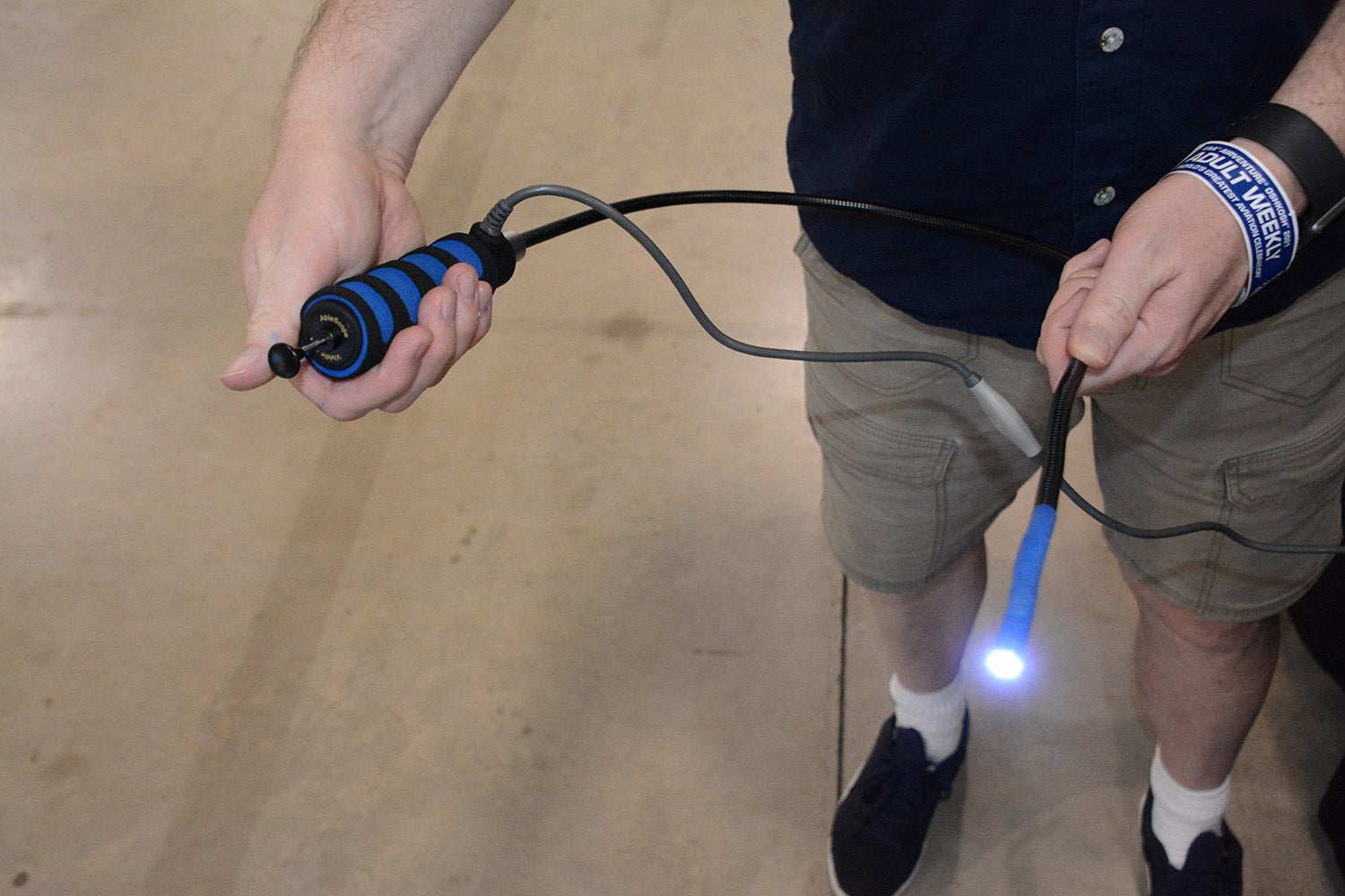

With no attached screen the VA-980 is light and easy to handle. The toggle lever at the end of the hand hold mechanically curls the probe end 180 degrees.
Video camera probes are one of the wonders of our age, but the cheap ones we always seem to borrow make us wish the resolution was better.

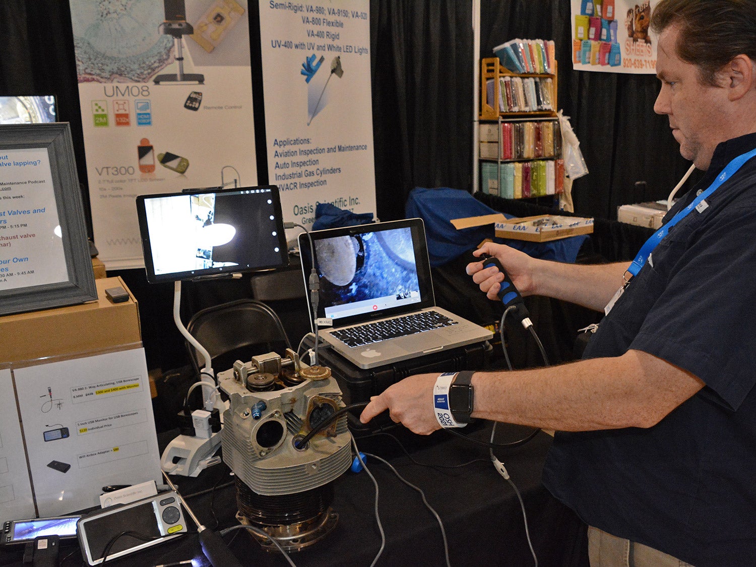

The Oasis VA-980 is well-suited to accurate cylinder inspection.
With an easily articulated head the VA-980 was also demonstrating admirable in-the-cylinder gymnastics. By squeezing the single-lever control the view would curl from straight down the bore, to what remained of the cylinder crosshatch (entertainingly interrupted by honking goobers of rust on the demonstration cylinder), to the valves, valve seats and right around to looking back at itself penetrating the spark plug hole. All of this easily accomplished with the control stick and rotating one’s wrist.
The probe is a useful but not awkward 32.5 inches long and is semi-rigid so you can form it into a dogleg and it will hold its shape if that’s useful. The bright led lighting is dimmable and the tool is native to Android phones. Adding the $100 Airbus WiFi adapter gets iPhone and Apple users into the game wirelessly. Otherwise laptop connectivity is via USB cable.
