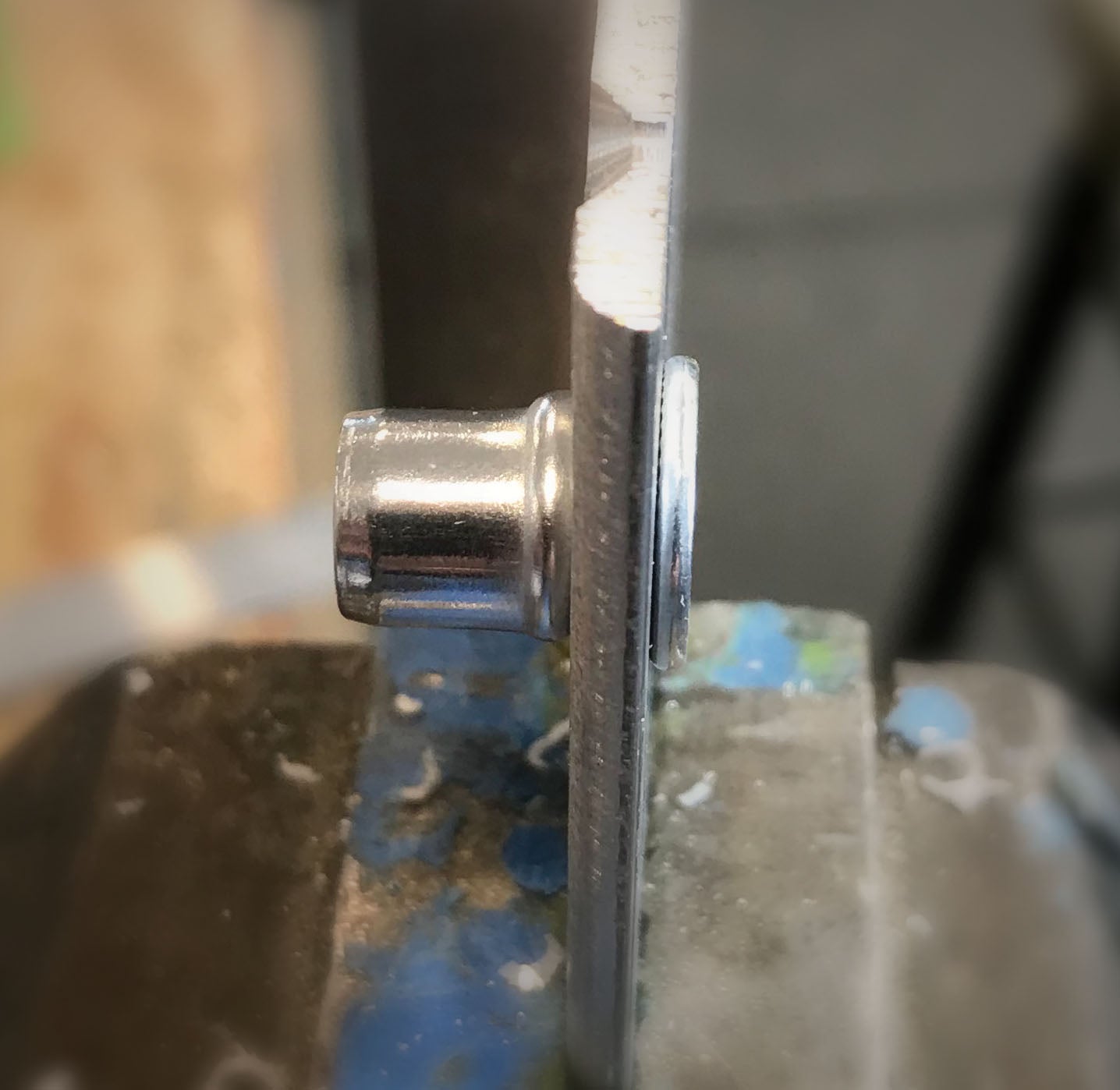

A plain nutsert installed in a piece of 1/8-inch-thick scrap for testing.
Let me say right up front that I hate nutserts. Also called rivet nuts, threaded inserts or rivnuts. (I’m sure there’s a formal product name in there, but I can’t muster the energy to look it up.) These vile little devices offer the opportunity to install a blind nut plate equivalent without having to access the back side (or inside) of the workpiece. Traditional nut plates require you to have that access, so they have to be installed during construction. Nutserts—and that’s what I’m going to call these &#*@ things from here on—allow you to install a blind nut fastener in the field, after everything has been closed up, so they are often used as a last idea for repairs—with the emphasis on last. When it comes to aircraft, I suggest trying anything else first before you turn to these things. But sometimes you have no choice.
The problem with nutserts is that they tend to spin—that is, once you have installed and pulled them, they don’t have enough grip on the surface to prevent a careless mechanic from putting enough torque on them while installing a fastener that they lose their hold and spin in the hole. Once they do this, not only do you no longer have a working joint, but the fastener might be stuck in the spinning nutsert—now you’ve got a real problem.

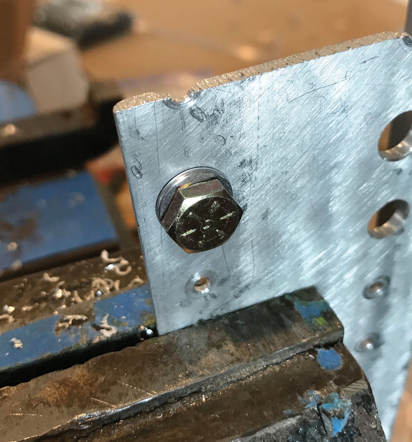

We screwed a bolt into the nutsert to which we applied torque.

The battery mounting plate is actually fairly thick, with 1/8-inch-thick angle aluminum extrusion reinforcements, so I found a piece of aluminum with similar thickness in my scrap bin and mounted it in the vise. I drilled an appropriate-sized hole and installed a 1/4-20 nutsert—a generic one from the local hardware store, to be precise, not a branded one. It had a smooth barrel, which doesn’t help its tightness in the hole. After pulling with a typical squeezing tool, I screwed in a 1/4-20 bolt and installed a torque load cell on a breaker bar with a 7/16-inch socket.
With the bolt snugged up, I began to apply pressure to the breaker bar until the nutsert slipped and read the torque. The most I saw was 4.0 foot-pounds, with an average of about 3.7. That comes out to less than 50 inch-pounds. Not a whole lot.

The load cell shows that the nutsert slipped at about 4 foot-pounds.
