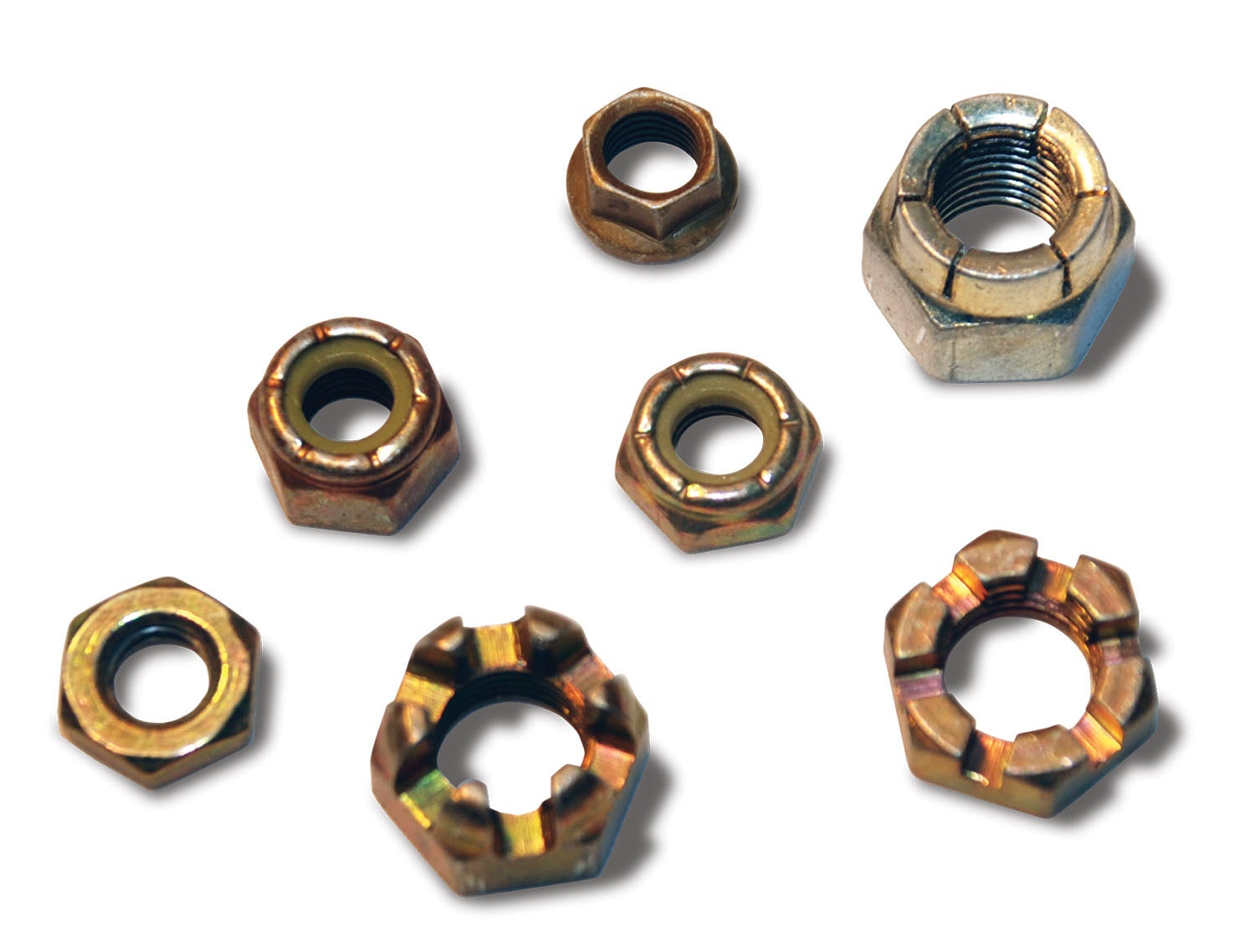

Here is an assortment of aviation nuts. The top nuts are all-metal stop nuts, the center ones are nylon insert stop nuts and the bottom are castle nuts with a jam nut on the left. Note that the nylon insert and castle nuts come in standard and shear (thin) varieties.
Castle nuts work best on bolts where there is possible rotation, such as on control linkages. The standard castle nut is the AN310, but a thin shear-only version called AN320 is also available. Castle nuts obviously require cotter pins to work properly. When tightening castle nuts always start by applying the minimum torque and then tighten to line up the cotter-pin hole with the slots in the nut. Don’t back up to align the slots with the cotter-pin hole.
